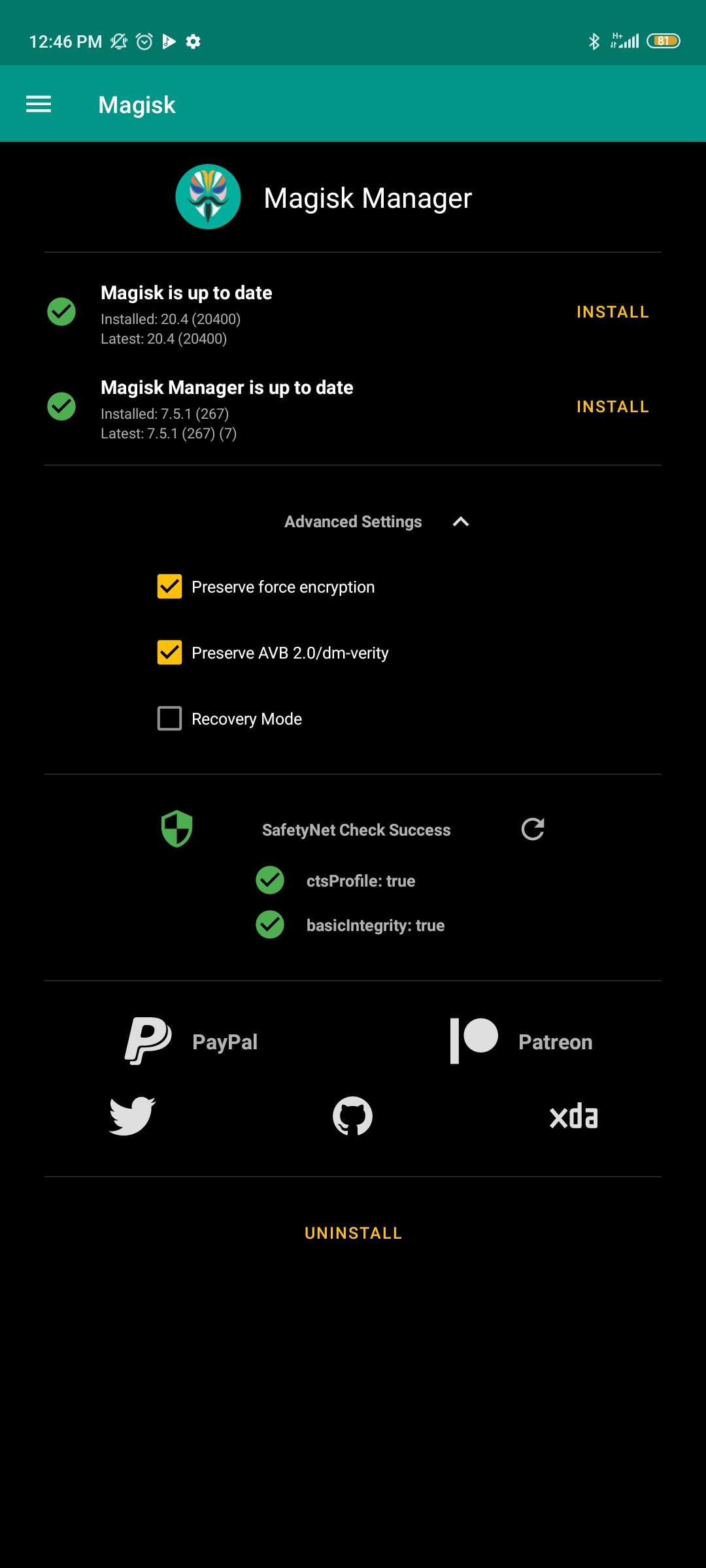

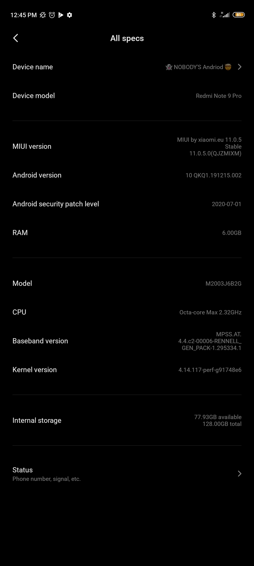

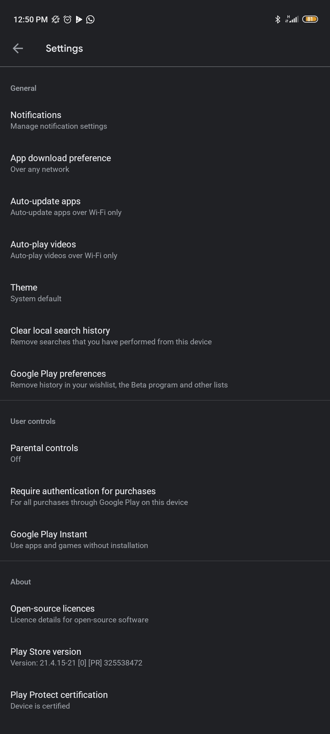

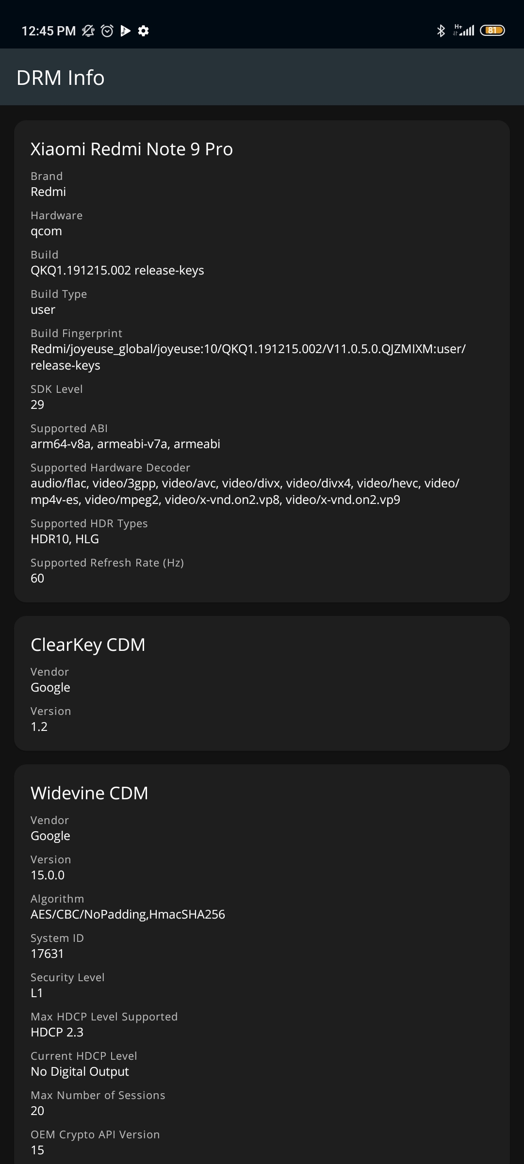

Successfully unlocked my bootloader after waiting for 168hrs, everything went well i did want to install twrp via adb my phone went on on detruct mode like system detroy i was scared asf i later did use the auto install twrp shared by @rbarat and went with some instructions there too, so finally am on eu, on my note 9pro joyuse L1 security in shape, magisk went well too.. Google play certified too. Thanks guys.

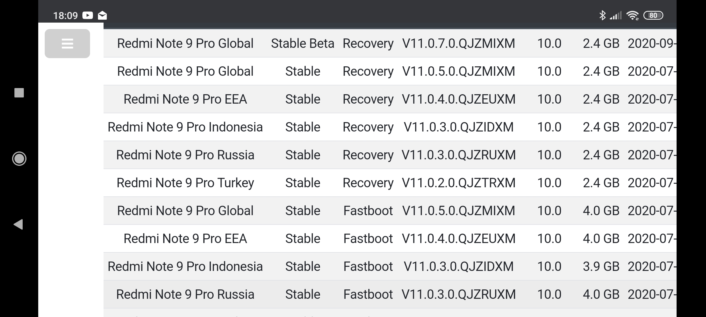

11.0.7 EU was uploaded 16 hours or so ago no fastboot version.
The Xiaomi firmware updater website says it's based on the note 9 global stable beta recovery, no fastboot version yet as it's a stable beta.

Went to your link 11.0.7 no stock fastboot either on that site only recovery and OTA, read your links before posting.
It's marked officially as a 'Stable Beta' that's why there is no official Xiaomi stock rom with fastboot, once it's out of the beta then it will have one.
