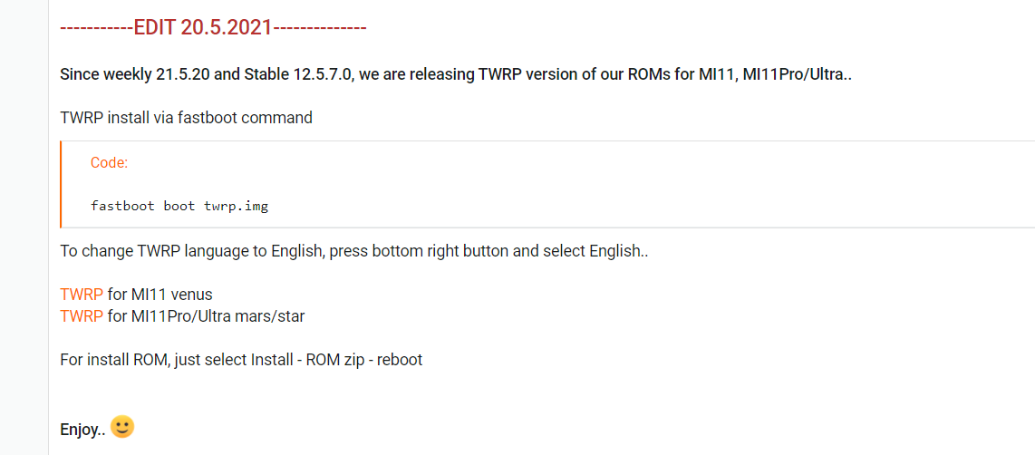

I have installed 12.5.7 with fastboot. Now how to install via twrp? Ist there any tutorial?
Do you already have twrp? if yes, all you have to do is connect the smartphone to the PC and copy the zip downloaded to the PC to the smartphone memory, I removed the block after the download and created a folder called Updater, I copied it there. After I went into twrp recovery and install zip then wipe davilcache and reboot

ok coming from CN to EU, just to make sure
- boot twrp
- inject twrp (is it needed?)
- format data (needs reboot?)
- flash rom
- reboot
