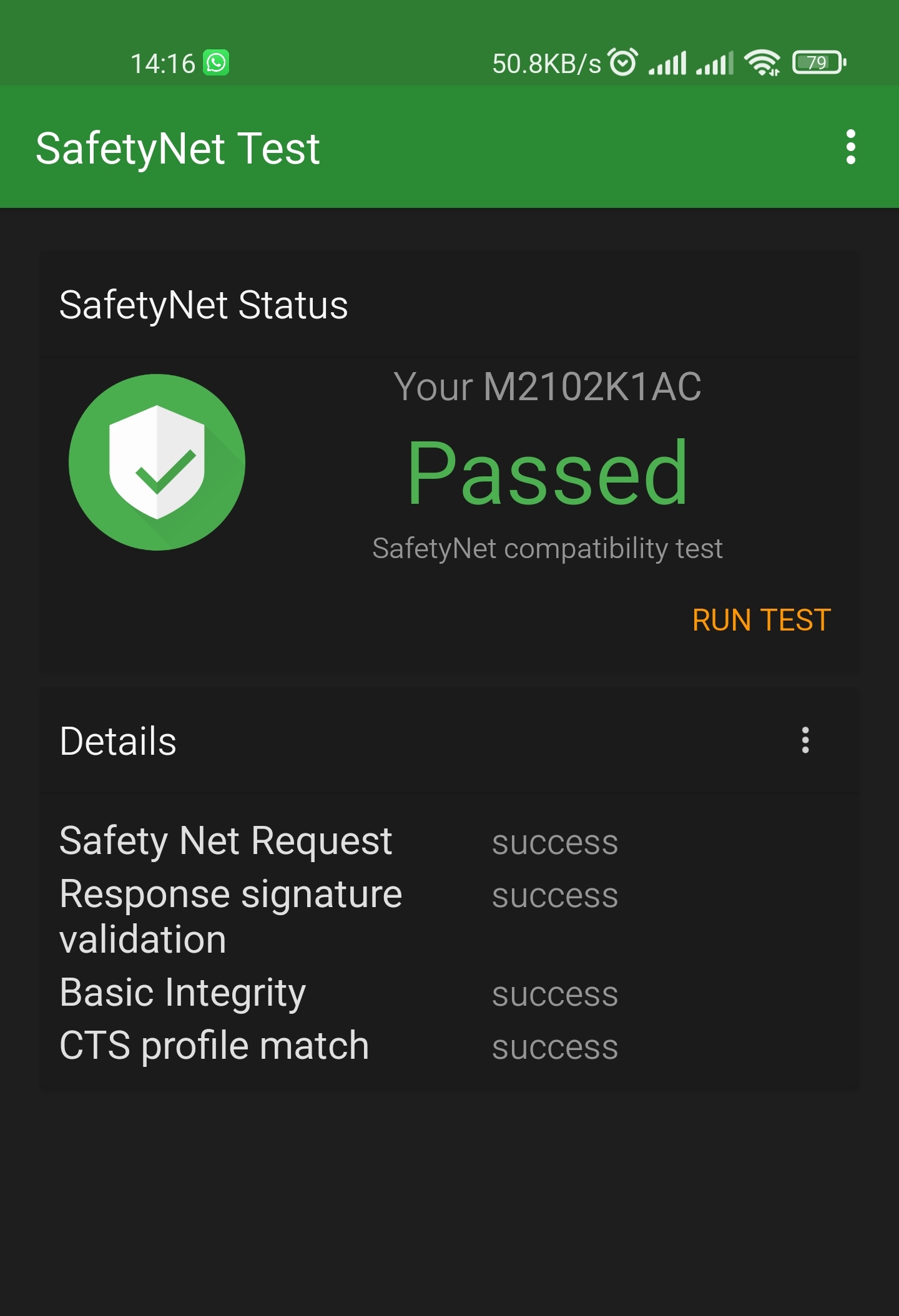

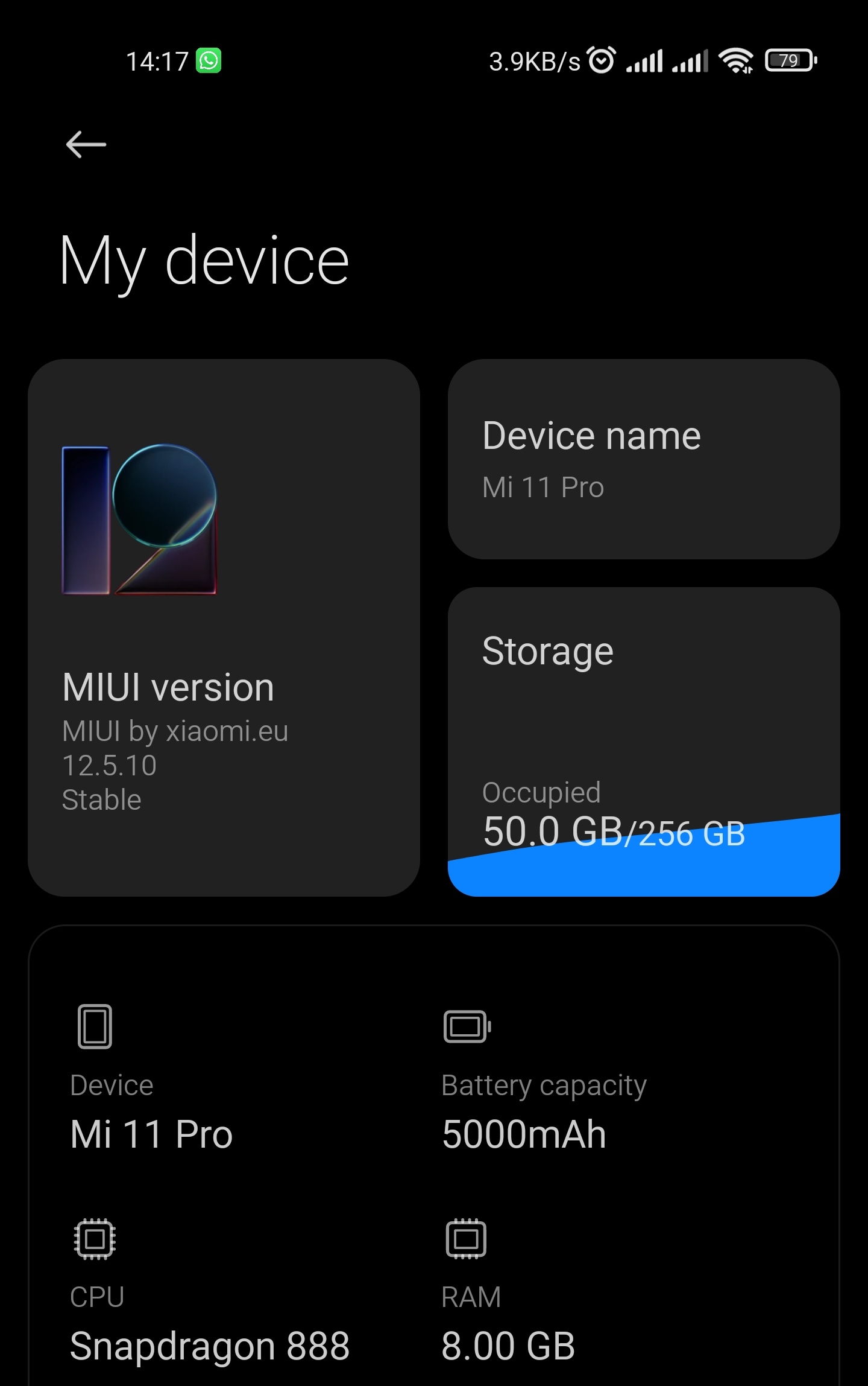

Is there any one know Mi 11 Pro/Ultra ROM 12.5.10.0 pass safetynet check or not?
I have downloaded file, but not install yet.
我從使用 Tapatalk 的 M2102K1C 發送

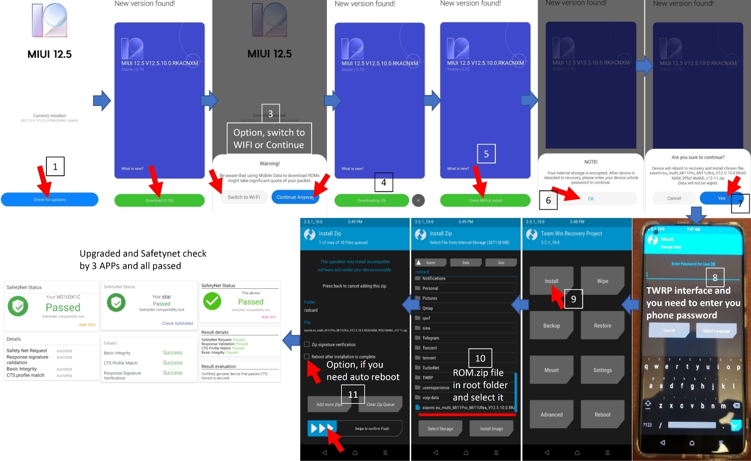

You are missing the data format step.
1. Boot to TWRP recovery
2. Format data.
3. Copy rom by adb push cmd
4. Select install
5. Select ROM
6. Flash!

does it matter if you format data at the start or after flashing the ROM ? Also if format data at the start and reboot phone back into TWRP the storage comes up on computer can than drag in rom zip this way also ok to do ?
hoangsang
Aug 12, 2016
252
67
I have a habit of formatting data before installing rom to avoid errors when installing new rom.
After formatting the data (on twrp) I didn't reboot the phone, but I used adb push command to copy the rom from the PC to the phone
snow1
Sep 10, 2017
65
30
Ok its just the storage doesnt show after doing the format data part thats why you use adb push command, but restarting the phone back into TWRP after doing Format Data the storage shows up on computer guess this way is also fine to do
Reactions: hoangsang
hoangsang
Aug 12, 2016
252
67
Maybe so, but I think it will take more time (time waiting for the phone to reboot :D ) so I choose the solution using the command to be fast :D
