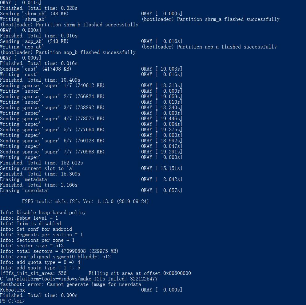

Hi, I installed for windows_fastboot_first_install_with_data_format.bat, and windows_fastboot_update_rom.bat, both always back to fastboot, restart again back to fastboot. Please provide an solution, the phone couldn't switch off also.

Please try an ordinary cmd window instead of PowerShell.
You unzipped the Rom, entered the folder and ran the bat, right?
The erasing user datan part is wrong, the command should not appear and fail..
Hmm..
The issue usually appears of you are updating instead of initial installing..
It's caused by -w parameter, any chance you're using the wrong script?

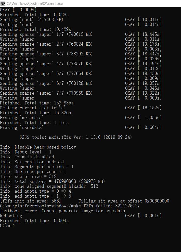

Yes I unlocked Bootloader through Xiaomi. so you think I should use CMD to reinstall it? let me try. thanks The erasing user datan part is wrong, the command should not appear and fail.., whats this mean?

Userdata should be your cache partition, this is caused by -w parameter, let me check the script and maybe we find a solution, this is your first install and you came from China stock Rom which you updated too?
You using the format install script, not the one with update in the name?

Yes this is first time install EU room, the phone was run by China version 12 stable, first time I used update, then I tried first install. but still not working, always back to fastboot

not working, still back to fastboot
I see, hmm, by any chance do you have an old version of the platform tools installed which might kick in?
Weird issue mate
In particular your make_f2fs.exe could be from older sdk and not working on Android 11.
Just wild guessing..
Could also be missing drivers...
The issue is the system cannot create the desired partition, but why is the million dollar question..
Try upgrading adb drivers and usb drivers for Xiaomi.
Can you use an usb 2 port?

What I am saying is I maybe didn't update the CN Rom normally using OTA prior to trying to flash EU.
Once I was stuck in fastboot I tried flashing CN Rom using Miflash - it would say success but then go back to fastboot every time. I had to get someone to flash using their Xiaomi account.
You might as well try flashing CN with Miflash? I don't recall which site I downloaded the Rom from...there are several.
Over on xda there is a thread by @ingbrzy which deals with the same issue, flashing latest China might help.
But also using correct Fastboot from zip.
Keep trying :)
What could save you, is flashing older Rom (early January) and then just update.
I would try this path.
