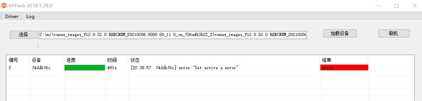

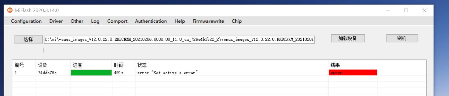

Previously I used China stable 12 ram, then flashed into windows_fastboot_update_rom.bat , then it stuck into "setting current slot to "a" ", then I restart the phone, flashed into windows_fastboot_first_install_with_data_format.bat, then always back to FASTBOOT screen, also I tried use Miflash to recover the china ram, but not work, back to FASTBOOT. please help.

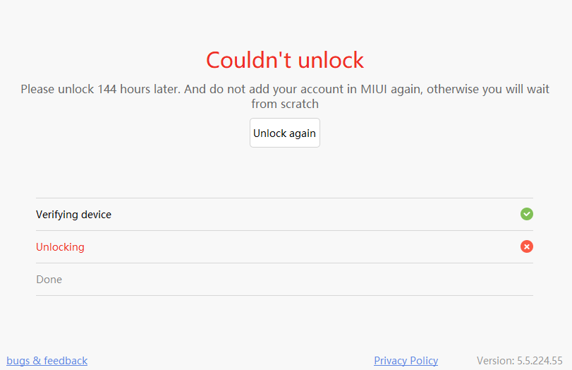

i can't unlock

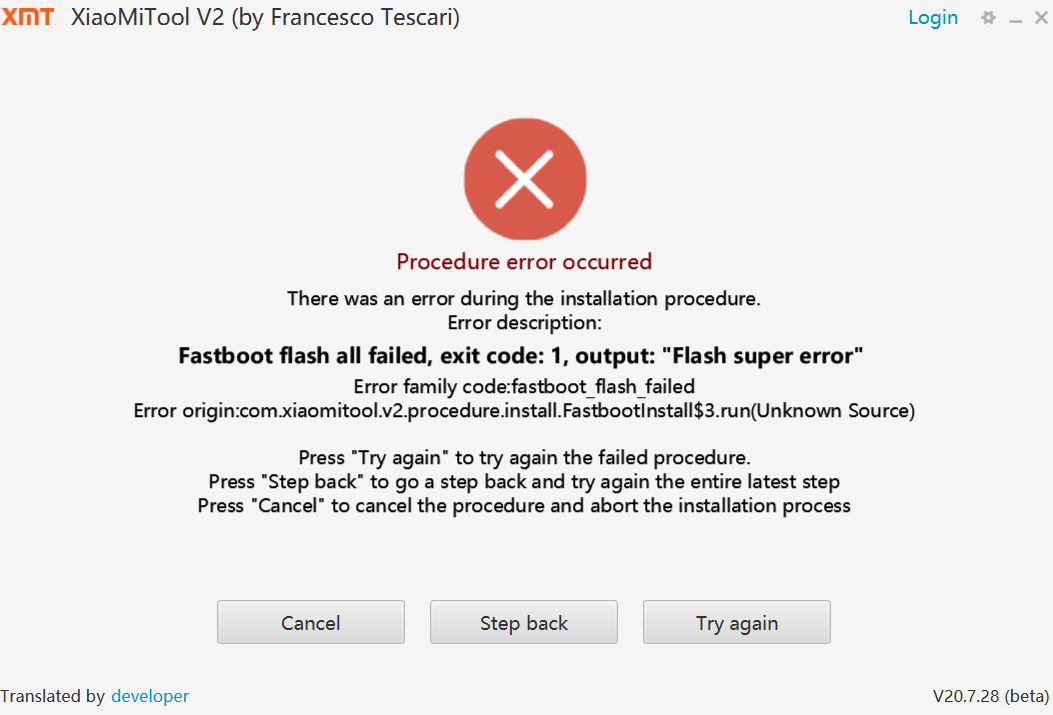

I am having the exact same errors. Tried with the provided scripts, tried with MiFlash, tried with XiaoMiTool V2, tried from different terminals in Windows and Linux. Phone stays in "Fastboot-Loop".
Seems like it can't correctly build the "userdata"-partition:
