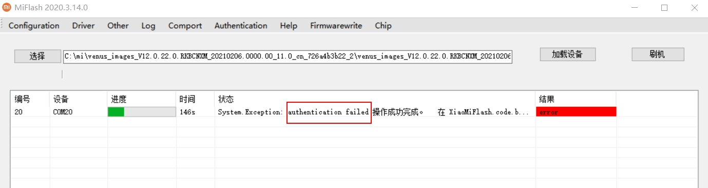

hello,
I have followed all the steps, and at the end of the process has finished as you can see in the image...
The phone turned on correctly with miui 12.5
But I'm worried, is this error normal?
thanks
hello,
thanks
It is normal for Windows users... as ROM booted fine for you, it has no effect on your device..
