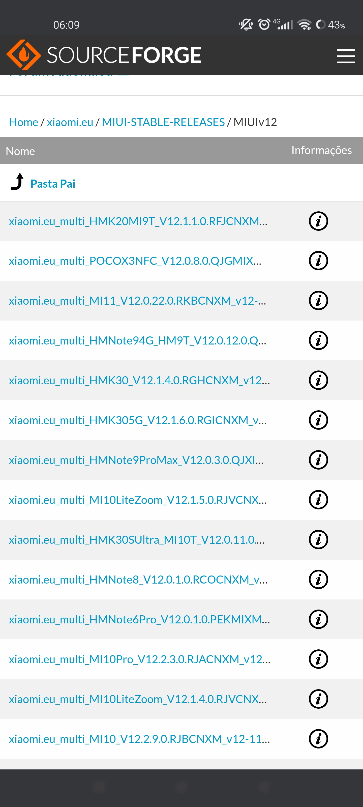

Personal a question: I now saw on the website a stable version of xiaomi.eu that when I clicked on the link appeared xiaomi.eu_multi_MI11_V12.0.22.0.RKBCNXM_v12-11-fastboot.zip.
This is a stability of the xiaomi.eu version, which has several languages, right? because it is CNXM and as I remember it looks like a Chinese version and not xiaomi.eu. Could you explain to me why I wanted to install and stable version of xiaomi.eu
No, it's our ROM..
This rom is stable of xiaomi.eu, alright?
Just can instal this rom?
And can I have language Portuguese?
How can I install this rom without twrp?
Stable ROMs by Xiaomi.eu are based on Official China "Stable"/"Stable Beta" ROMs for most devices. ;)
Do what you want. xD
It's a Xiaomi.eu ROM so answer is yes.
It's a "fastboot" zip, so you have to use fastboot to install the ROM.
Last question: I'll use it via fastboot where the file is inside. But will I need to back up? Like when executing the installation file, will you format everything and then install the stable version?
You only have to execute "first_install_with_data_format" installation script. So format data is automatically done. ;)

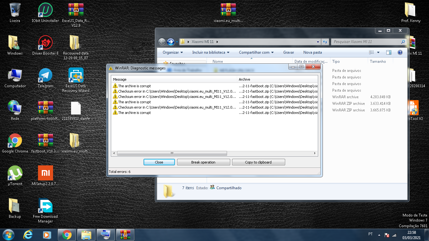

I did the same scheme as the others I entered the file and unlocked on property after I extracted the file and the corrupted file appeared.
What can it be?
