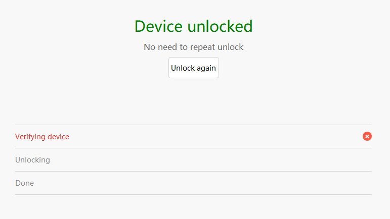

It just says is already unlocked

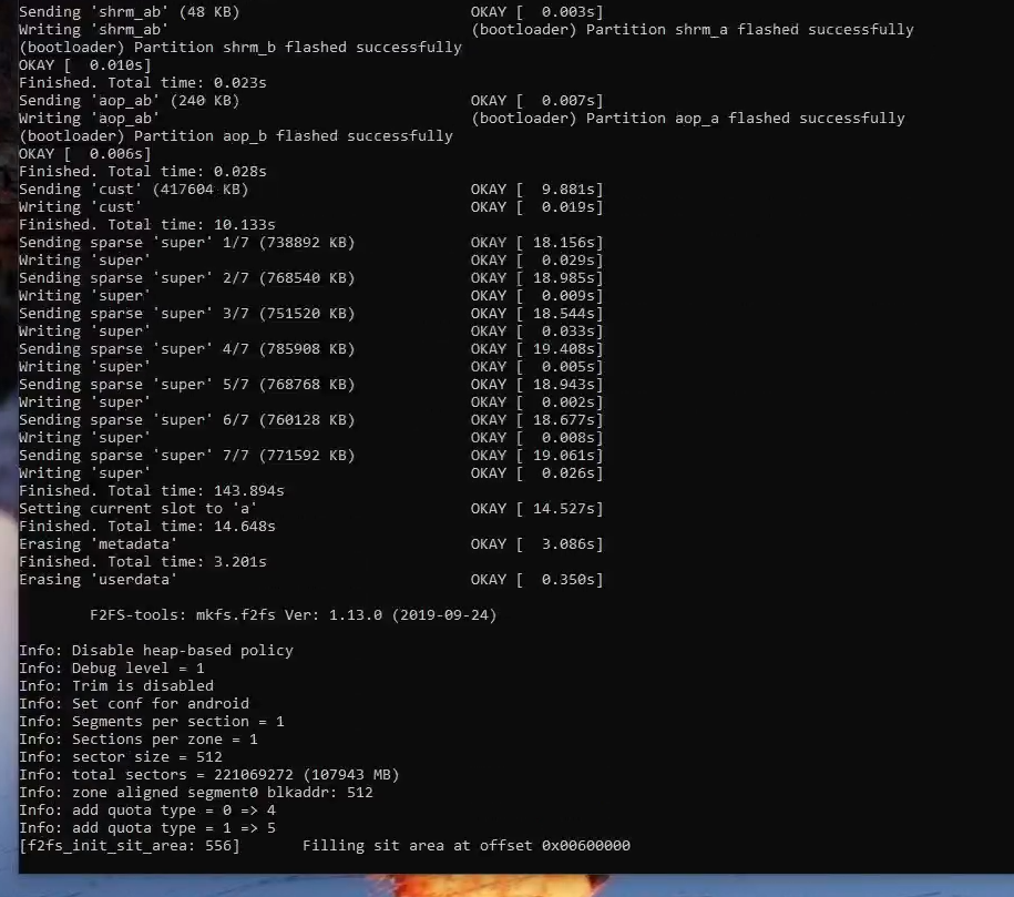

here is part of the log file and screenshot:
DEBUG <11:21:50.571,T:22704> : -s b01b1e76 oem device-info
DEBUG <11:21:50.601,T:22704> : ...
(bootloader) Verity mode: true
(bootloader) Device unlocked: true
(bootloader) Device critical unlocked: true
(bootloader) Charger screen enabled: true
OKAY [ 0.000s]
finished. total time: 0.000s
³LÓ
DEBUG <11:21:55.577,T:16916> : Unlock device error!

ok. I would try to flash the xiaomi.eu rom now
Tried with Xiaomi.eu 21.3.11
CMD closes fast so i had to record it lol ...
It just exits always at this same point (Is it the right finish?)
While it closes the phone reboots and reenters immediately in fastboot mode
Is there something else i could try?
Thanks again for the support mate

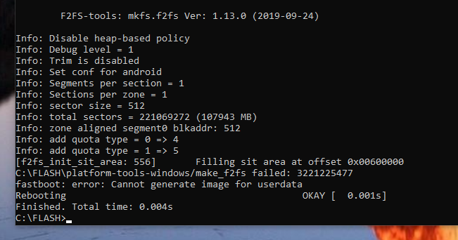

EDIT:
Same result but i could see the error now as it didnt close:
C:\FLASH\platform-tools-windows/make_f2fs failed: 3221225477
fastboot: error: Cannot generate image for userdata
here is the screenshot:

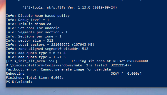

Tried all the steps this time from another folder using powershell
same result unfortunately... didnt try to re-unzip fastboot.exe, what do you mean by that?
Another thing to note: i noticed in video title there is "for already flashed from chinese ROM to EU" but i was coming from a 12.0.3 stock global, is this a problem?

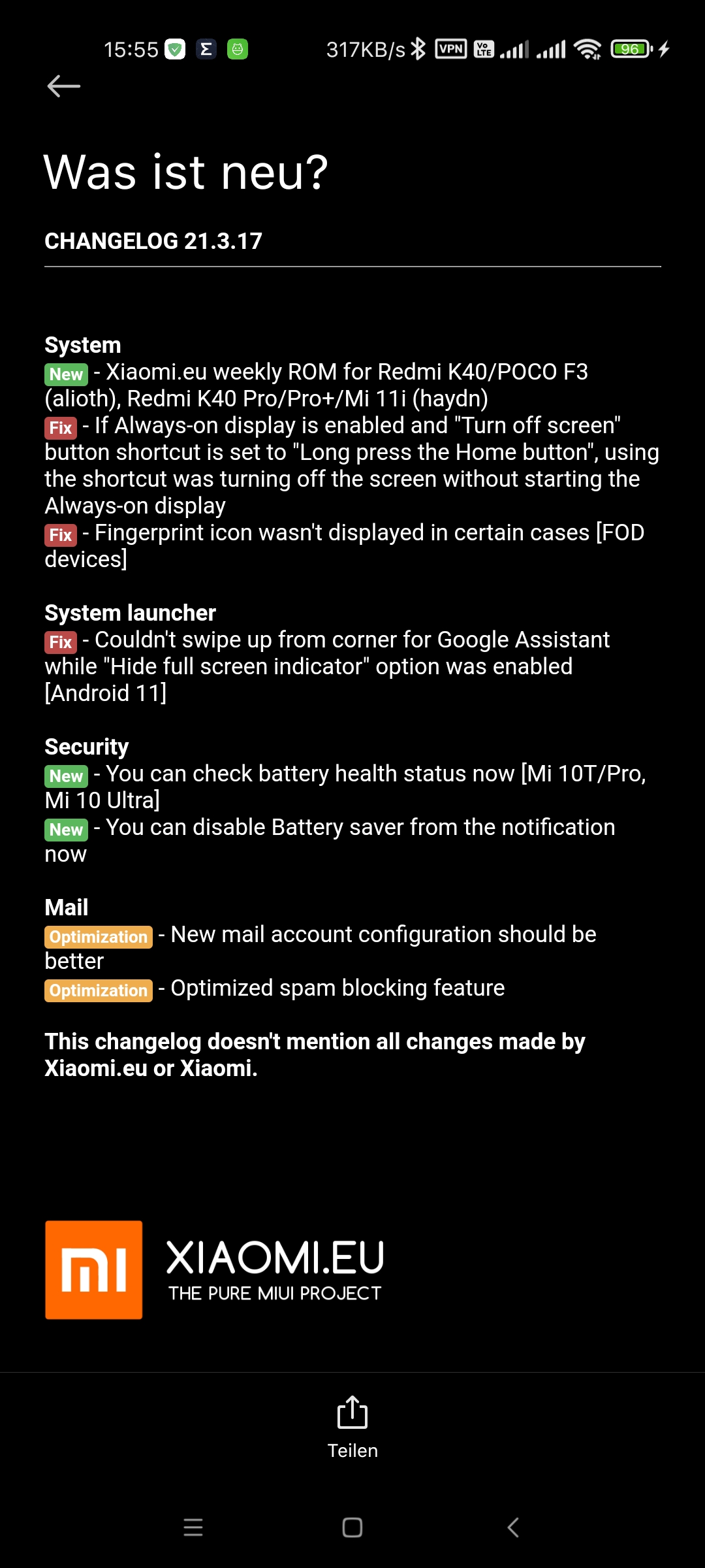

Flashed 21.3.17 successfully

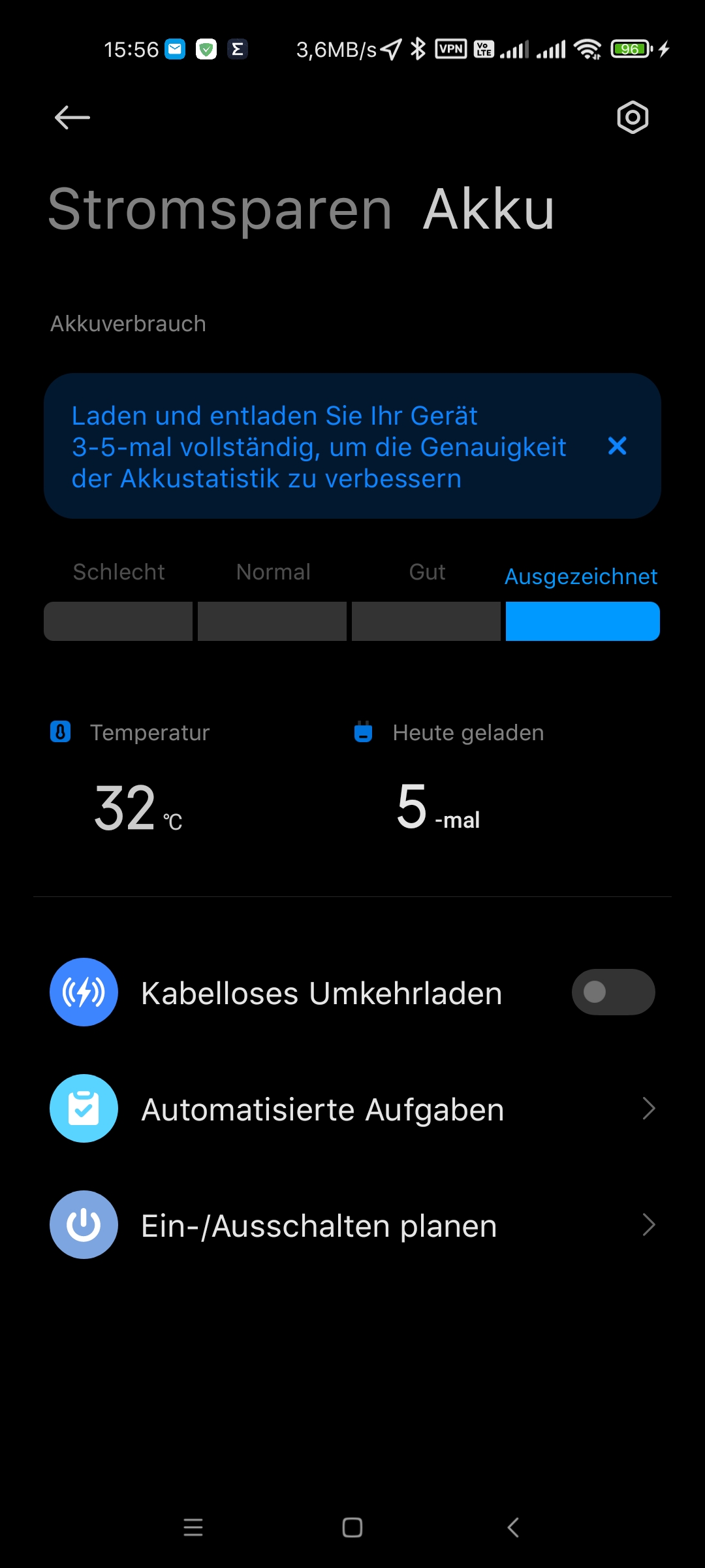

Mi11 has the battery health status too (changelog says Mi10)
GoogleDrive mirror in my signature
