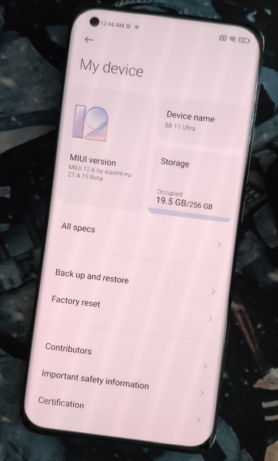

Do a factory reset after unlocking?YEYYY!!!! IT WORKED!!!!!
From Global 12.0.1 to xiaomi.eu_multi_MI11Pro_MI11Ultra_21.4.15_v12-11-fastboot.zip
Things I did differently (those in bold) from what I did when I bricked the phone, though not sure if those matters:
- unblocked zip file
- extracted to a folder
- removed the sim card
- factory reset the phone
- did not enable USB debugging
- fastboot mode
- opened cmd as administrator
- flashed using windows_fastboot_first_install_with_data_format.bat
I guess I'm happy now!![]()

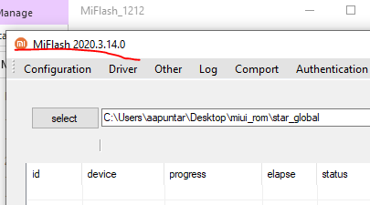

CN always..If the EEA or Global version has a different modem config than CN and allows for Carrier Aggregation on networks like Vodafone UK, are those changes likely to make their way into the EU rom, or will it always be only based on the CN config?
just for interests...
can someone who needs an edl service, record the teamviewer session (video) and can share the video pls ?
At least they don't charge you without knowing if it's working or not, so it's legit and fair.It's just a normal Mi Flash process. The only difference is it asked for key and password (xiaomi edl authorization) during the flashing.
first, the phone boots in edl. you get a blankscreen after the edl guy executes fastboot oem edl
then he downloaded MI flash package from his google drive
started flashing then somewhere in the process (I think like 70%) it asked for edl key/pwd
then edl guy asked you to pay (i think to make sure that you will not run away)
Thx for sharing.
