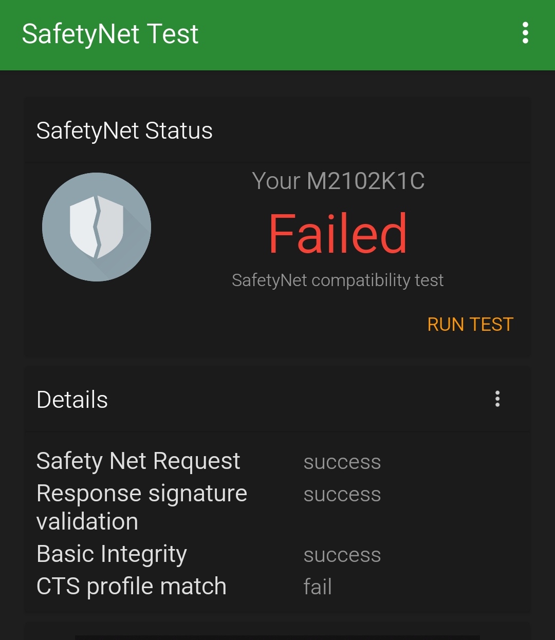

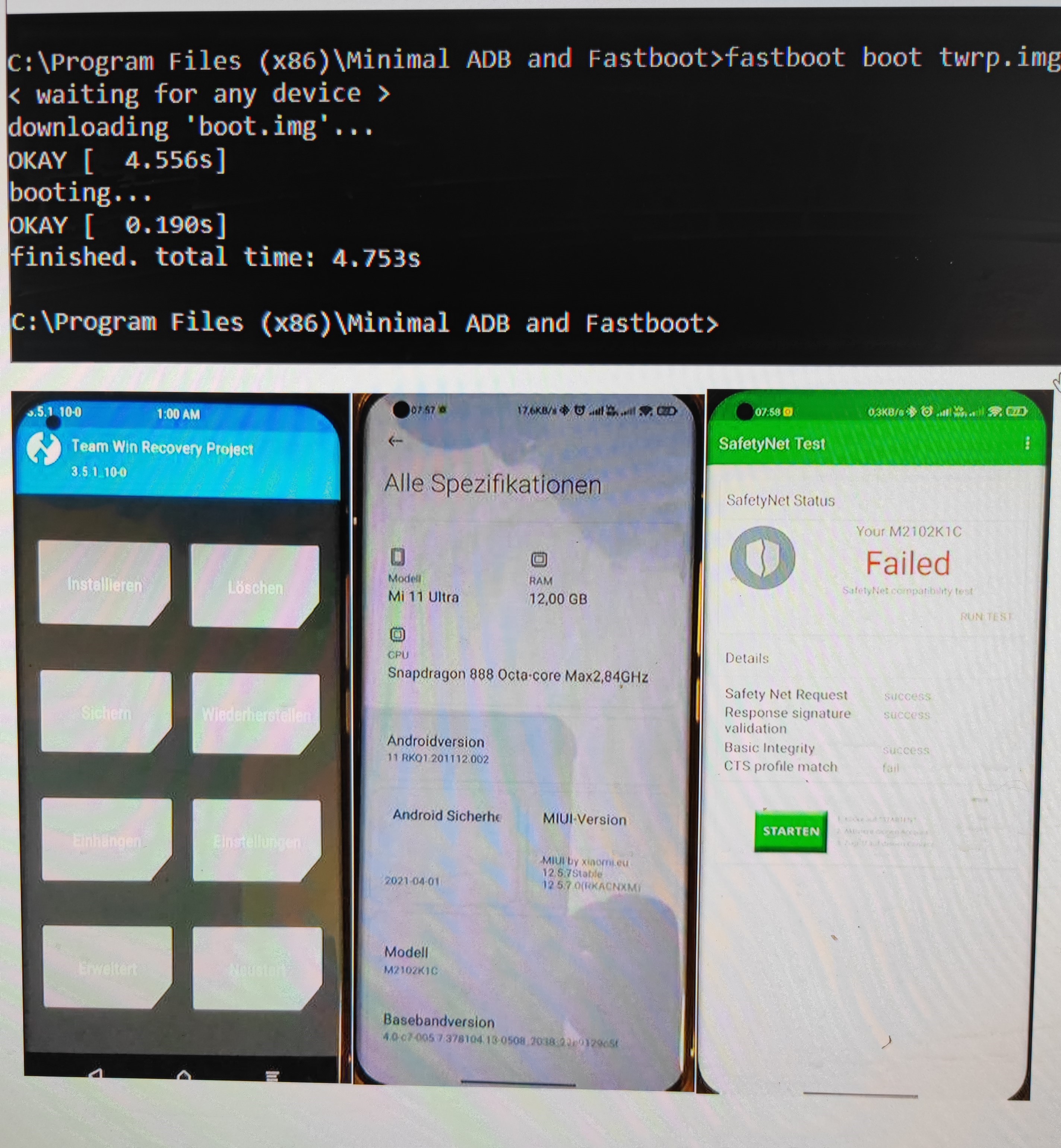

I've just upgraded to 12.5.7 and my banking apps start to crash. I checked safetynet and seen it failed. Is this normal?

were you already on a xiaomi.eu rom before this or were you just running normal stock ziaomi rom?
assuming you were already on a xiaomi.eu rom, as i was keep reading
i just successfully did the newest weekly install via TWRP so i will give you my steps as im sure they would be the same for the stable
-download twrp for mi 11 onto pc
-download latest weekly rom onto mi 11 internal storage and copy to pc or vice versa, keep both copies in both places
((EDIT: i dont know if it was necessary to transfer the rom zip to the pc or extract it, this is only my second xiaomi.eu install so i was just trying to follow steps, but you may have been able to rename the twrp file to twrp.img and opened a powershell from directly within the twrp folder and did the fastboot command from there, im not savvy enough with how fastboot works so i just kind of mirrored what i did to install the weekly rom via fastboot last week up until that step)
-turn on usb debugging
-turn off phone, go into fastboot mode, connect to pc
-extract the weekly rom zip (checking the properties first to see if the "unlock files" checkbox is available, it wasnt for me, check the box if available
-copy the twrp image file and paste it inside of the extracted weekly rom folder
-(i renamed mine to "twrp.img" for ease of typing in powershell)
-shift+right click in ampty space in the folder and open powerhell window here (or cmd window)
-type "fastboot boot twrp.img"
-this will put twrp on your phone and it will reboot into the twrp
(you may now disconnect phone from pc)
-click the lower right chinese button and select english and click the ok button (its in chinese but its the only button you can click and its where the "ok" button should be)
-twrp is now in english.
-select "Install"
-navigate to the downloaded location of the unextracted weekly rom zip folder, mine was just in downloads
-select it
-check the box that says reboot after install, i left the box for "verify zip signature unchecked
-twrp does some things and after a few minutes, phone rebooted into newest version with no loss of settings or data.
-turn off usb debugging if you wish
-youre done.

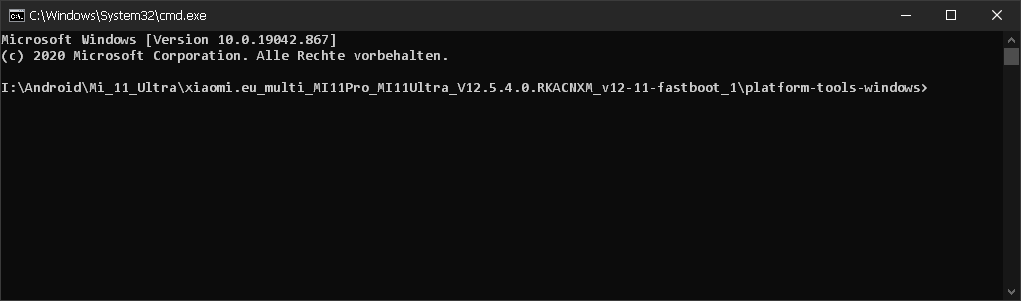

my problem is that my pc doesnt know the fastboot command. So powershell or cmd does not know it. What do I have to do?

12.5.7.0 seems not yet certified by Xiaomi.. you have to wait or install Magisk hide..

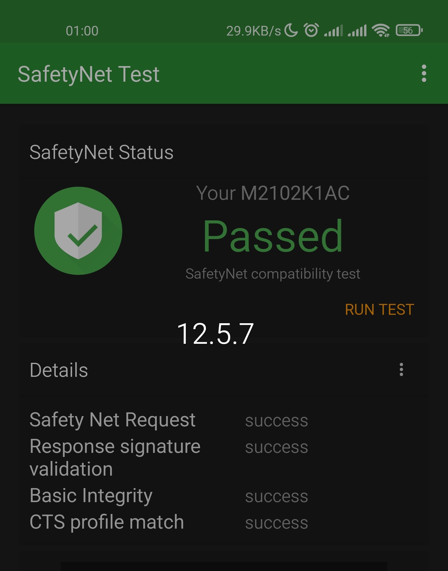

Thank you people :D I have now successfully 12.5.7 installed.

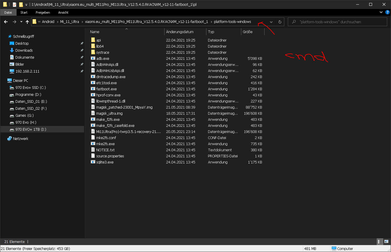

What i did was that I extracted the platform tools directory from the previous fastboot zip, put the recovery image there and ran directly from it... That should work just fine.
Is there any detailed instruction on how to flash Xiaomi TWRP? I am a beginner. No matter what command is input in CMD mode, it will run out "not an internal or external command, executable program or batch file". How to solve this???

I just installed twrp on my Mi 11 Ultra via fastboot. Previously the version xiaomi EU 12.5.7 stable copied into the donload folder of the phone and installed from there selected via TWRP. So far everything without any problem. But: Safetynet reports errors. Before, with the Xiaomi 12.5.5. it worked. What could be going on there?

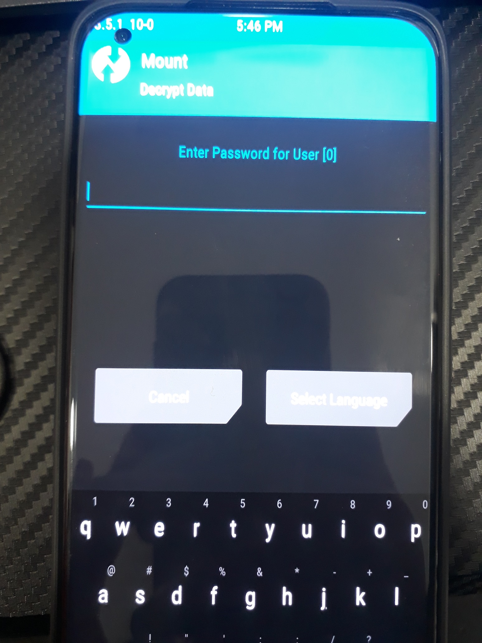

Hello everyone,
i need help please.
before starting can you tell me why the installation of the 12.5.7 rom is not identical to the 12.5.4, it was much easier to click on the "Windows fastboot first instal ..... bat" while on 12.5.7 it does not exist?

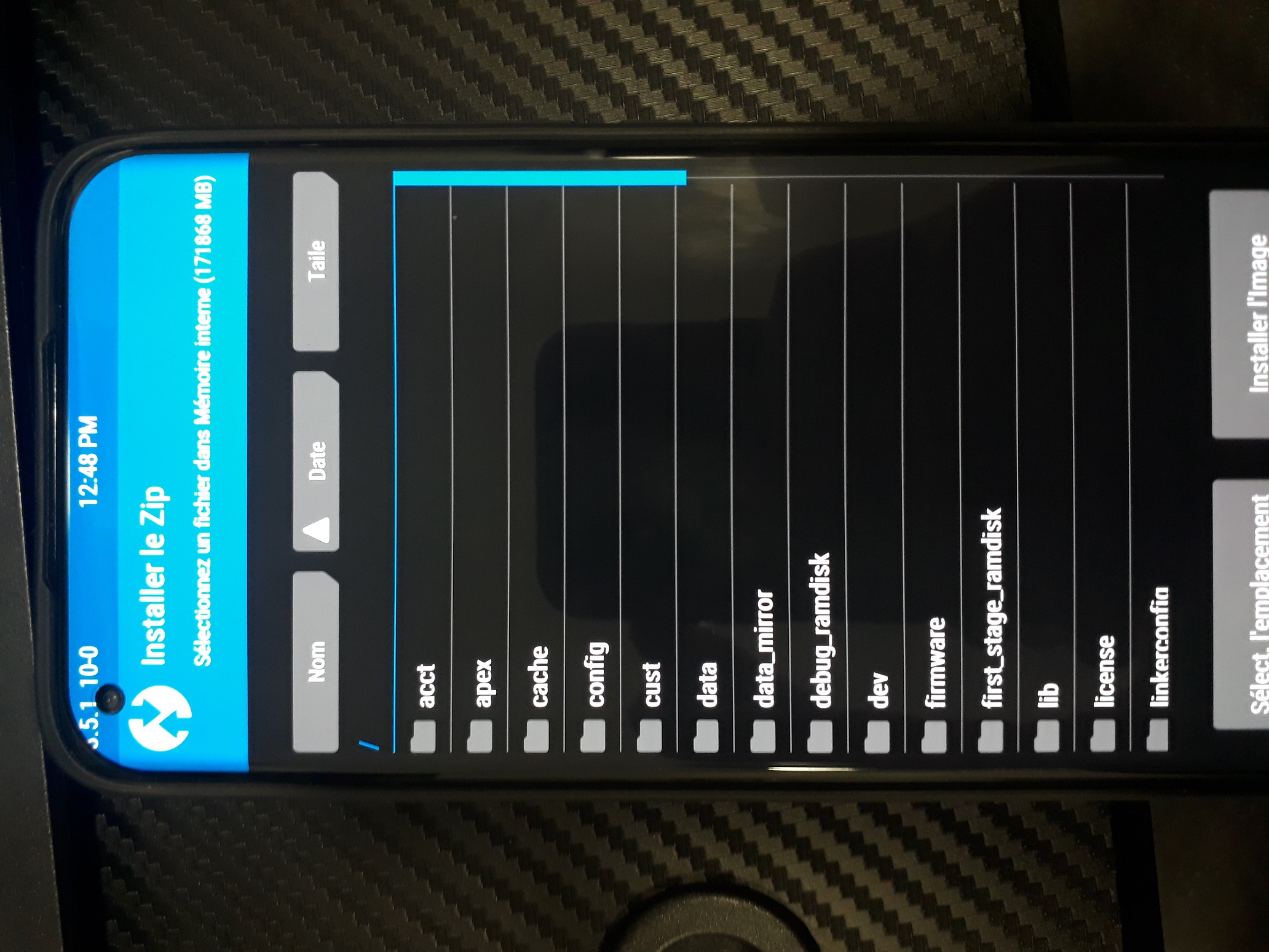

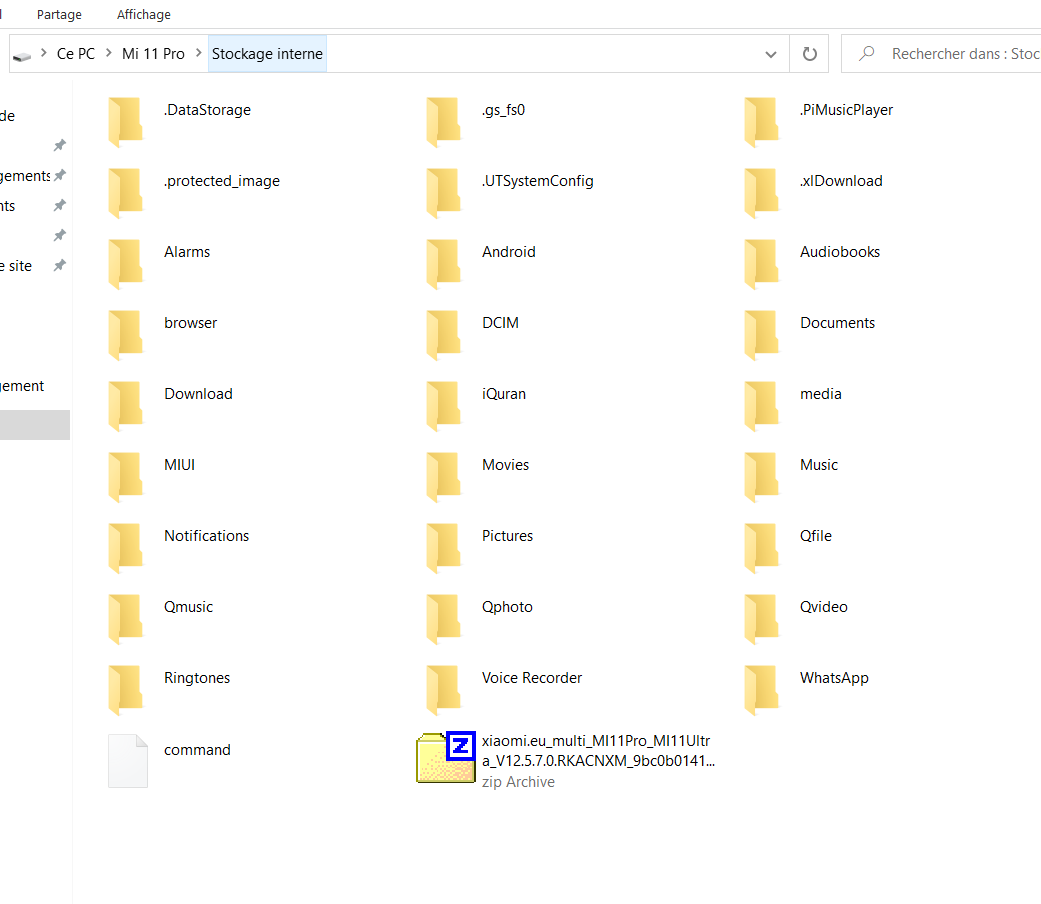

i try to install rom 12.5.7 but i can't.
I manage to start in recovery via the twrp.img but its asking me for a password (photo attached) then I click on cancel and I arrive on the folder tree, but in no folder is the rom 12.5 .7.zip (photo attached)
However, I have the rom at the root of the phone (photo attached).
how do I proceed for the installation please?
Can I have a detailed tutorial please?
Thanks a lot for your help.

Hello everyone,
i need help please.
Hey :D let me try to help you :D
The difference is now that finally a supported TWRP Version is available. Using TWRP the installation process changes.
When TWRP asked me for a password, i simply took the code i use for unlocking my phone when it was in lock screen to enter my phone. This worked 100% fine for me. So if you have a lock code simply try that one.
You are nearly at the end, so when you put in the code then you only need to hit install, wait for the installation to finish. I checked the box for restarting automatically after the installation and the device restarted automatically trying to boot up the OS.
Do you need something else or is this enough info? :)
beautiful, it worked, thank you very much.
indeed, you were right, you had to put the lock screen password, i don't know why i hadn't thought of it lol.
I understand better now, it allowed to mount the hidden partition or find the 12.5.7 rom.
thank you for your very clear explanations.
