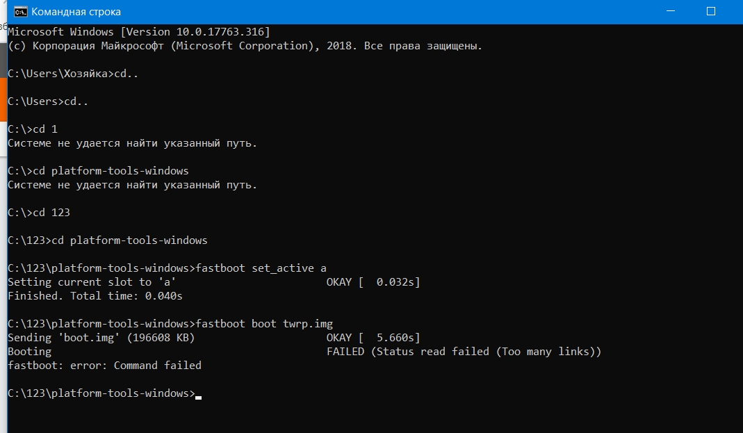

¿Dónde descargo la versión 12.5.7.0 de venus para twrp? He probado varios pero todos terminan fastboot
where do I download the 12.5.7.0 version of venus for twrp? I have tried several but they all end fastboot

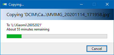

Thanks, backup my photos now just in case.
