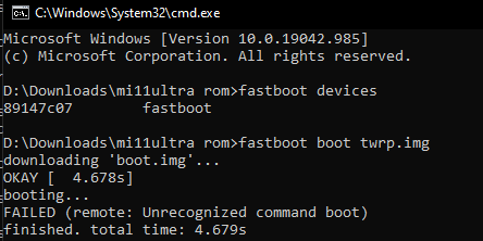

Keep getting this error :
downloading 'boot.img'...
OKAY [ 4.678s]
booting...
FAILED (remote: Unrecognized command boot)
finished. total time: 4.679s
OKAY [ 4.678s]
booting...
Try to avoid spaces in the name of the folder.
Sure a file named twrp.img is located in the folder?
It says Boot.img that's why I'm wondering.

Im sure the file has been downloaded and renamed twrp.img , i have tried this on my other folders too like for instance at C:\Program Files (x86)\Minimal ADB and Fastboot
After typing - fastboot devices ( to make sure it detects the phone ) and then - fastboot boot twrp.img , it keeps showing me this :
Sending 'boot.img' (196608 KB) OKAY [ 4.620s]
Booting FAILED (remote: 'Unrecognized command boot')
fastboot: error: Command failed
P/s : i have also re-downloaded the twrp file a couple of times to make sure it's not corrupted, etc.

Try: fastboot boot twrp.img.img
Error due to renaming file twrp.img

Try a different cable, use an USB2 port.
@JJay333999 It sounds dumb but... have you unlocked the bootloader of your device?
And what's the version of your "fastboot.exe"? fastboot --version
Yes it's unlocked, currently running eu version 12.5.4 stable
fastboot version 0.0.1-4500957
Installed as C:\Program Files (x86)\Minimal ADB and Fastboot\fastboot.exe
