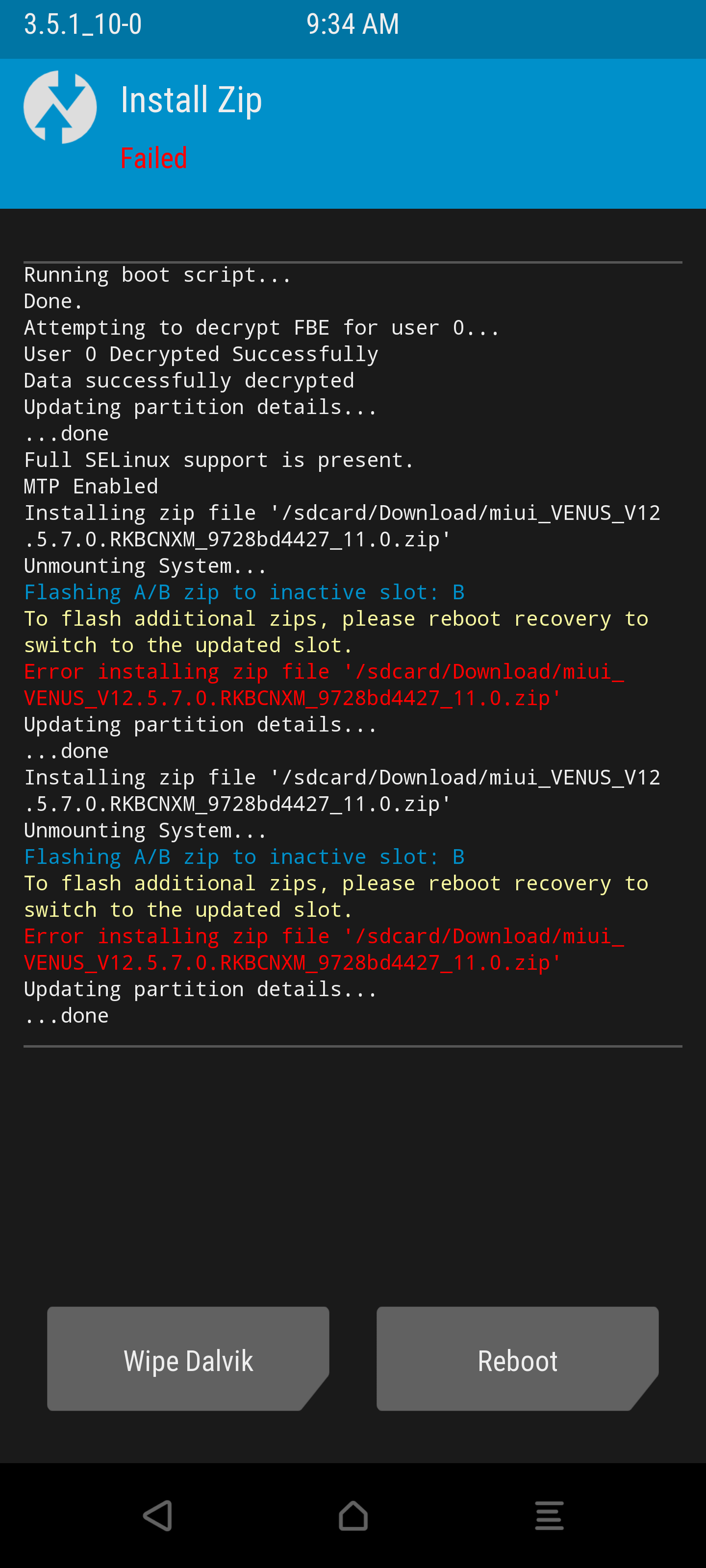

TWRP currently does not support the "update-package" command. So after updating you still have to manually select the downloaded zip file to install. So having TWRP saves the need for a computer, but it's not available for OTA yet :D
