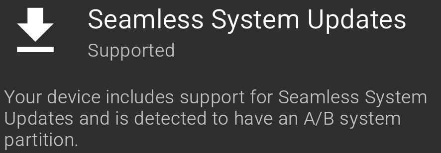

Check if you have a A/B device or not
- Download Treble Check
- Check for this entry

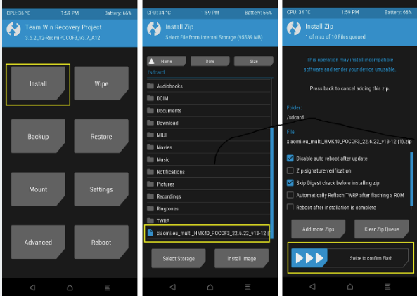

- TWRP should be loading and then enter PIN/Pattern/Password
- copy downloaded ROM to internal storage of your device

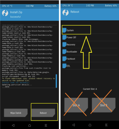

- install the ROM -> see nice pictures from @gogocar62
- optional you can flash TWRP permanent with "Install Recovery Ramdisk"
- Reboot to System -> see nice pictures from @gogocar62

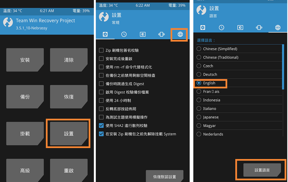

How to change the language in TWRP
- see nice pictures from @gogocar62

3.) BOOT-REC-TWRP -> you can use both fastboot commands -> see 1.) & 2.)
TWRP update shows ERROR: 1 / can not mount system ...
- this error can occur if you try the update with updater app or if you started TWRP manually
- Solution:
-> while you are in TWRP reboot your device in recovery mode
-> try to install the rom again
-> if it will fail, reboot in recovery again
-> or use "fastboot boot twrp.img" again
-> sometimes you need more then one try
-> if it will not work choose another twrp version
You can test if you have a A/B device with this command
# fastboot flash recovery twrp.img
If there is an error message "no recovery partition" you have an A/B device
or run this command it is true if A/B
# adb shell getprop ro.build.ab_update
