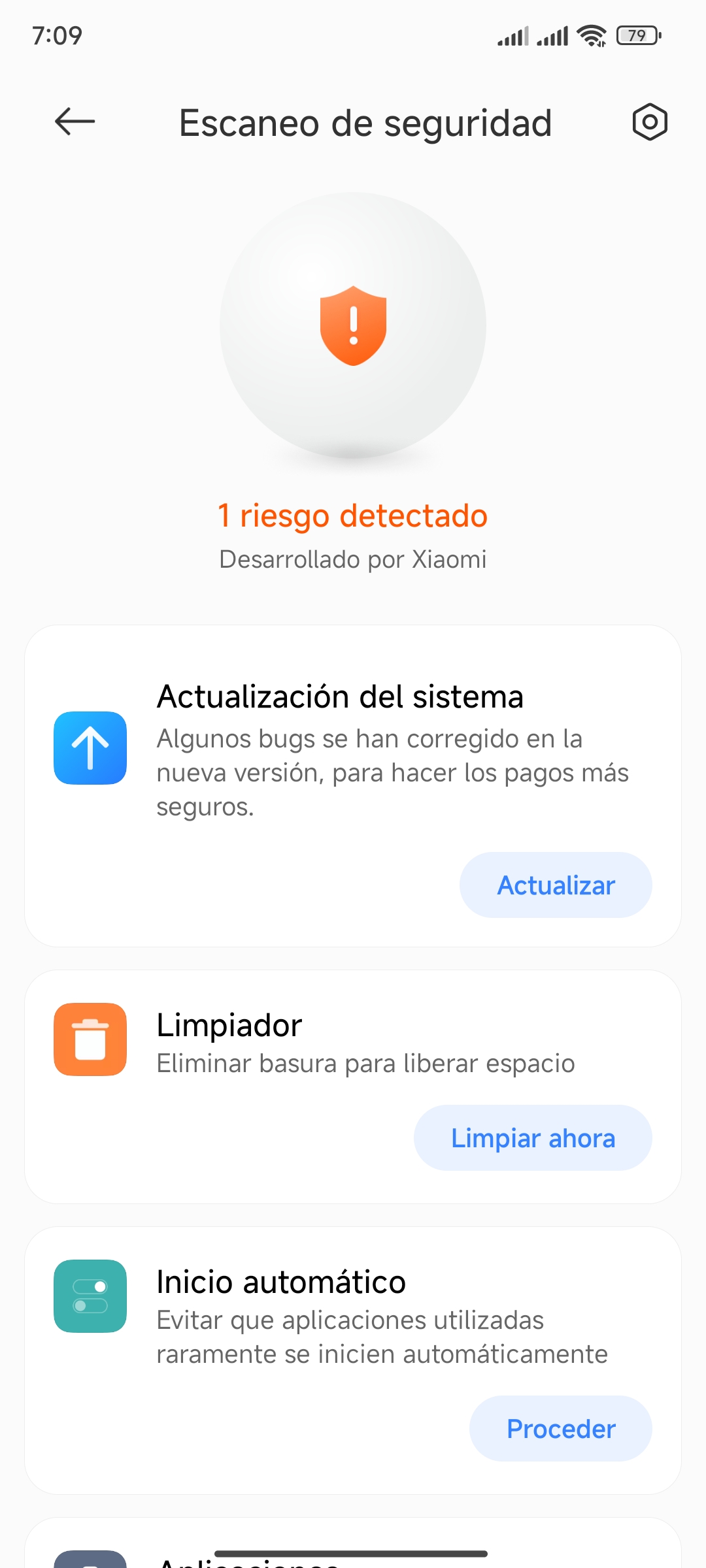

Redmi Note 12. I don't know why it shows that there is a danger. Before with the xiaomi inject module it did not show this. By the way I have the latest version installed, it is a clean installation

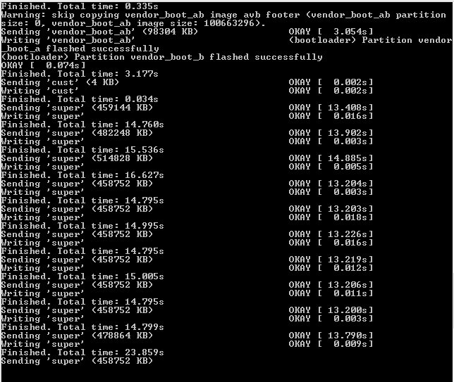

I am installing with fastboot and the installer stuck in the fifth "SUPER". Is that normal?
Same here. Finally reboot and now Im stuck in XIAOMI HYPEROS starting logo.
FUXI resets several times and I´m not sure how to proceed.
Updated via fastboot
In my case I soft bricked my cell phone, I canceled the first installation and corrupted the rom in the second. I solved it by restarting my phone and computer and installing MIUI 14
