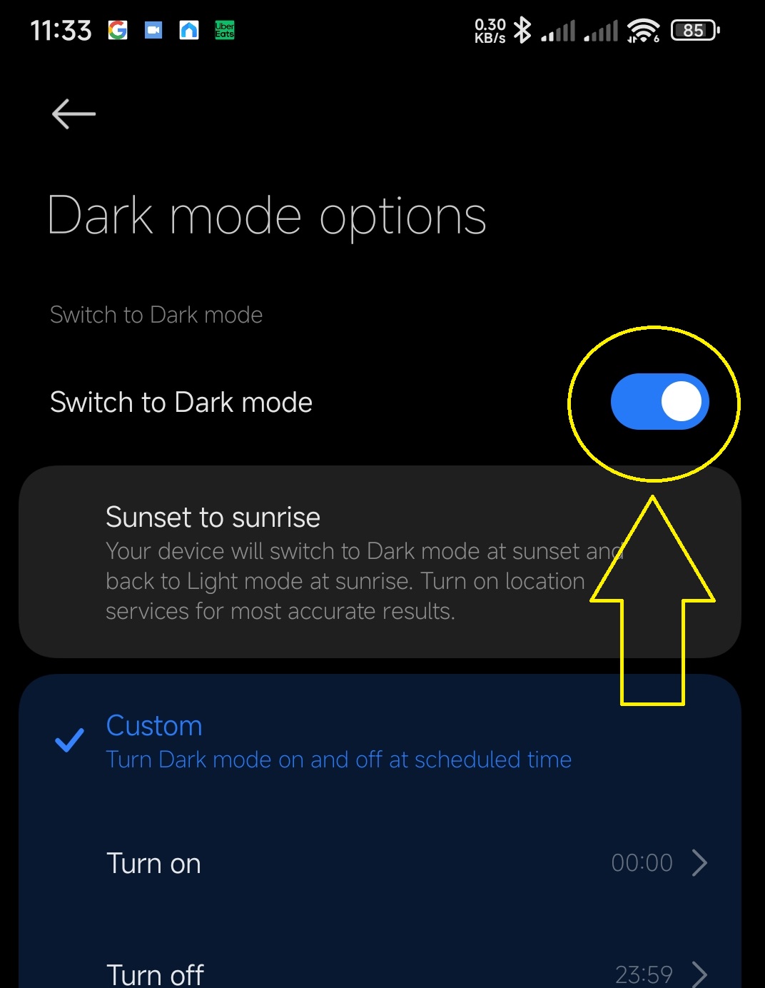

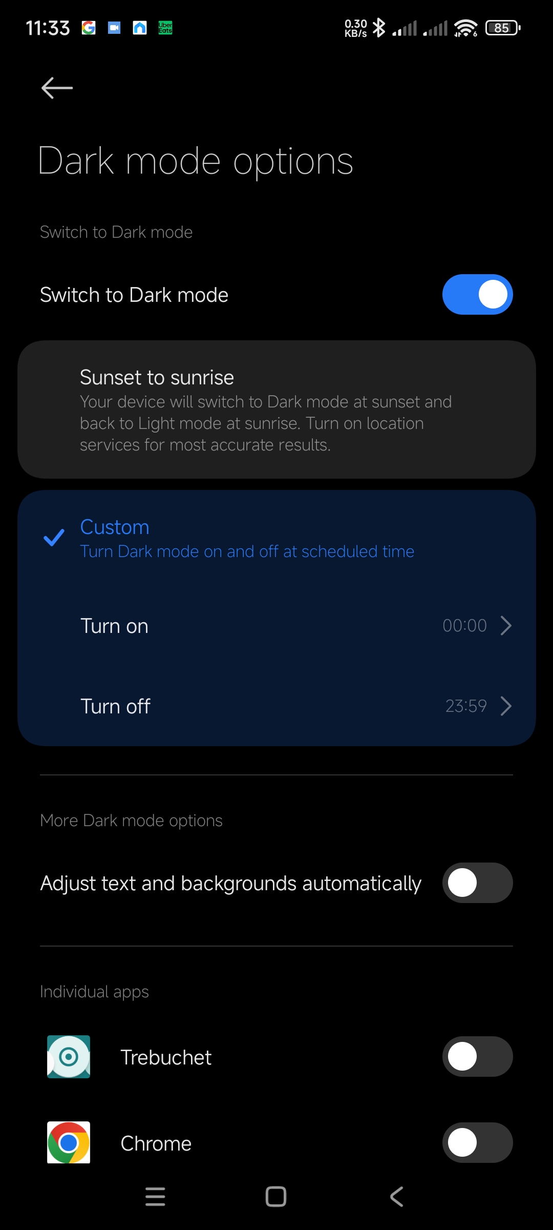

Would it be possible to have an option for Dark Mode to be on indefinitely without a sunrise or custom mode? It forces you to set either which means you'll always have it turn off at some point
The way around this currently is to set it to turn off at 23:59 and turn on at 00:00.

@ingbrzy

Ah, I missed that part.
I guess that's understandable, to be honest, and it worked great on MIUI. It's not a bug it's more just an annoyance but I'll see if the time adjustment actually keeps it on. The only time it will be off is for a minute if my times work correctly.

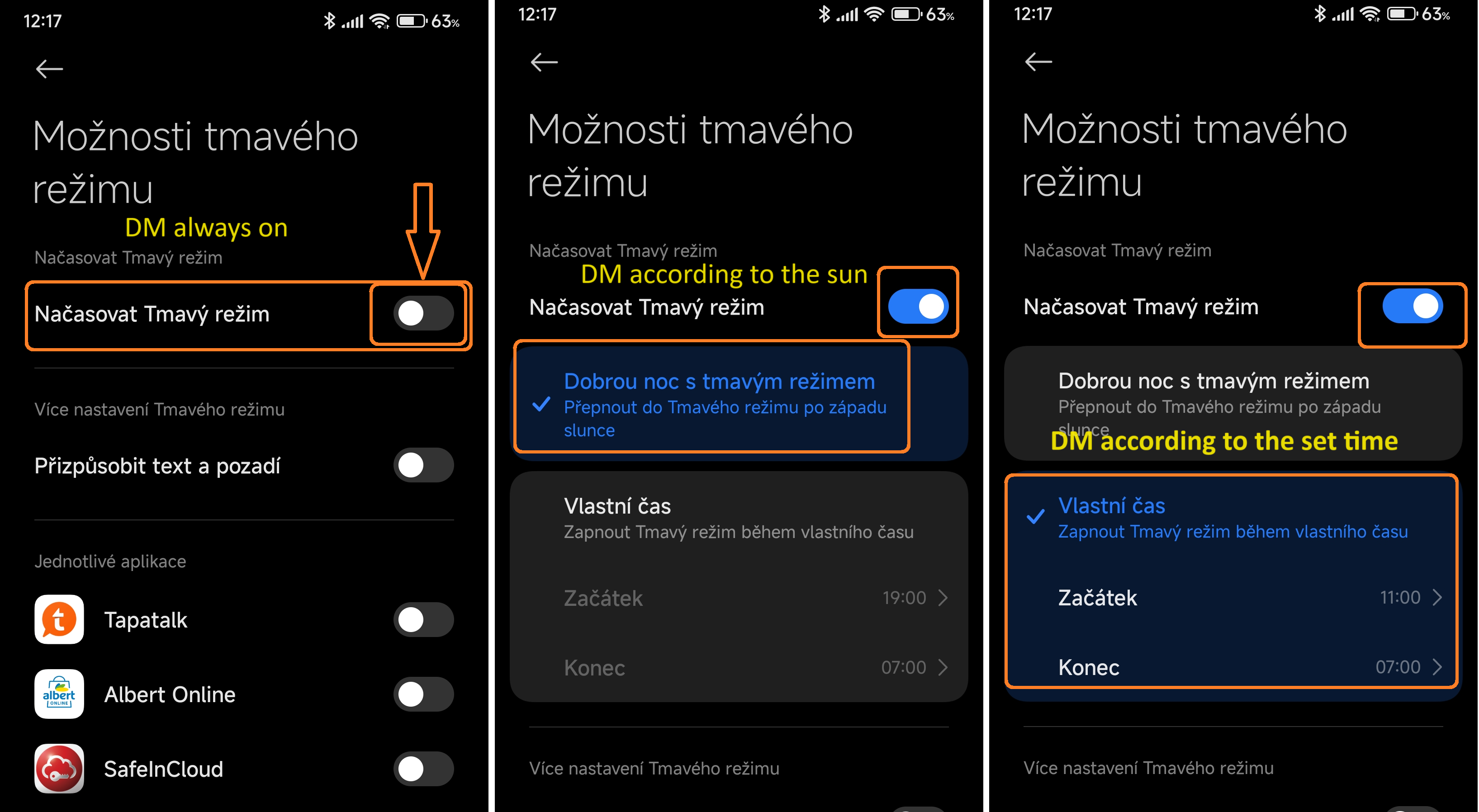

I guess I don't understand you.
DM has the following possible settings:
1- DM always on
2 - DM according to the sun
3 - DM according to the set time
1- DM always on
But your always on setting looks like the sun setting?
This is what I see
Turn off the marked switch and you will get DM always on.

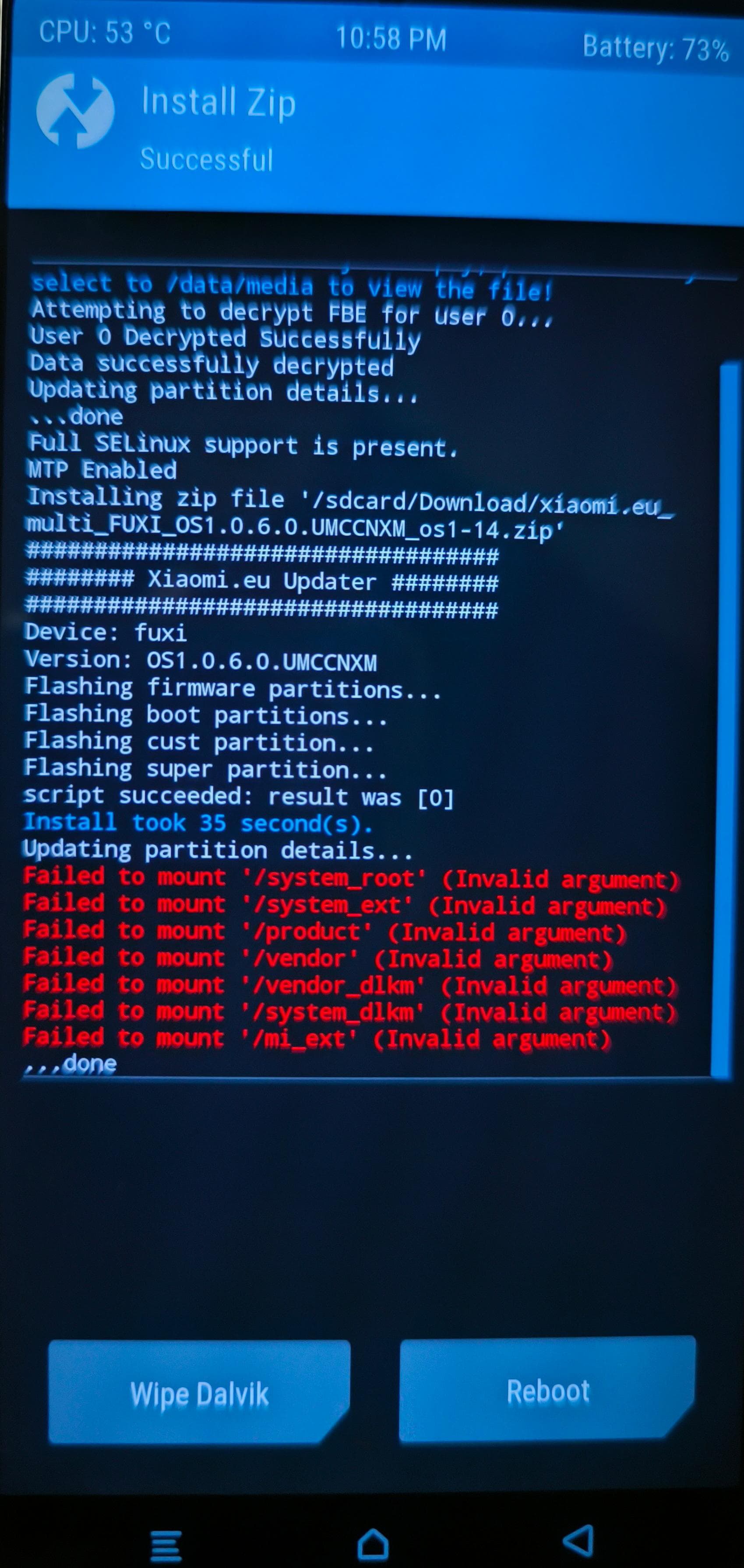

Hi there! I have a question on the TWRP recovery A14 version requirement for HyperOS. I have a fully working TWRP A13 installed now on my Mi 13 Fuxi. To use TWRP A13, I have to use the PIN to unlock first.
What is the correct order to upgrade from xiaomi.eu version 14.0.31.0 to the latest HyperOS while making sure TWRP works after that, and requiring no wiping of Data?
This is my guess, please let me know if it's incorrect.
1. Boot into TWRP A13. Unlock with PIN. Install TWRP A14 for Fuxi, i.e. using the image file twrp-3.7.1_12-v8.5_A14-fuxi-skkk.img.
2. Boot into the newly installed TWRP A14 for Fuxi. Unlock with the same PIN. Install HyperOS i.e. using the downloaded ROM xiaomi.eu_multi_FUXI_OS1.0.6.0.UMCCNXM_os1-14.zip.
Separately, will the TWRP A14 work with my current xiaomi.eu 14.0.31.0? I'm wondering if I can continue using the A14 TWRP with my current ROM, before upgrading to Hyper OS.
Thank you!
Edit: I did step one. I'm able to use A14 TWRP with the old xiaomi.eu 14. I'll update to the latest HyperOS next.
After updating to A14 TWRP, I used it to install the HyperOS ROM. The installation process was only 35 seconds, and there were errors. I thought it failed. I tried again, and got the same result. See the attached photo for reference.
But after rebooting, it worked! I got into HyperOS, my files and settings are intact, so far no crashes with Gallery. All good! :)
No worries about the errors.
"Script succeeded: result was [0]"
That's showing you that everything is alright.
Reactions: bmn11
