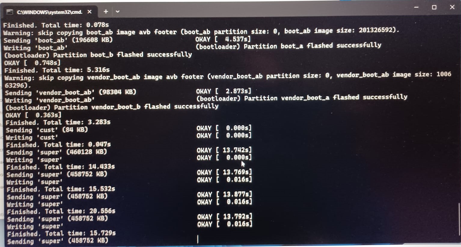

I tried installing HyperOS on my mondrian via fastboot, but when I open the cmd for fastboot_update_rom, the terminal only shows "Waiting for device". My phone is on fastboot mode already and is connected to my pc. Any help on this? Thanks
Edit: I fixed it!! Apparently I lack of ADB drivers on my pc, after installing those, I got the update. Thanks for the ROM devs :D
