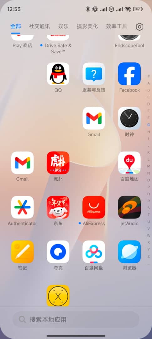

Similar issue with my FUXI. The menu is always missing one app icon when reboots.

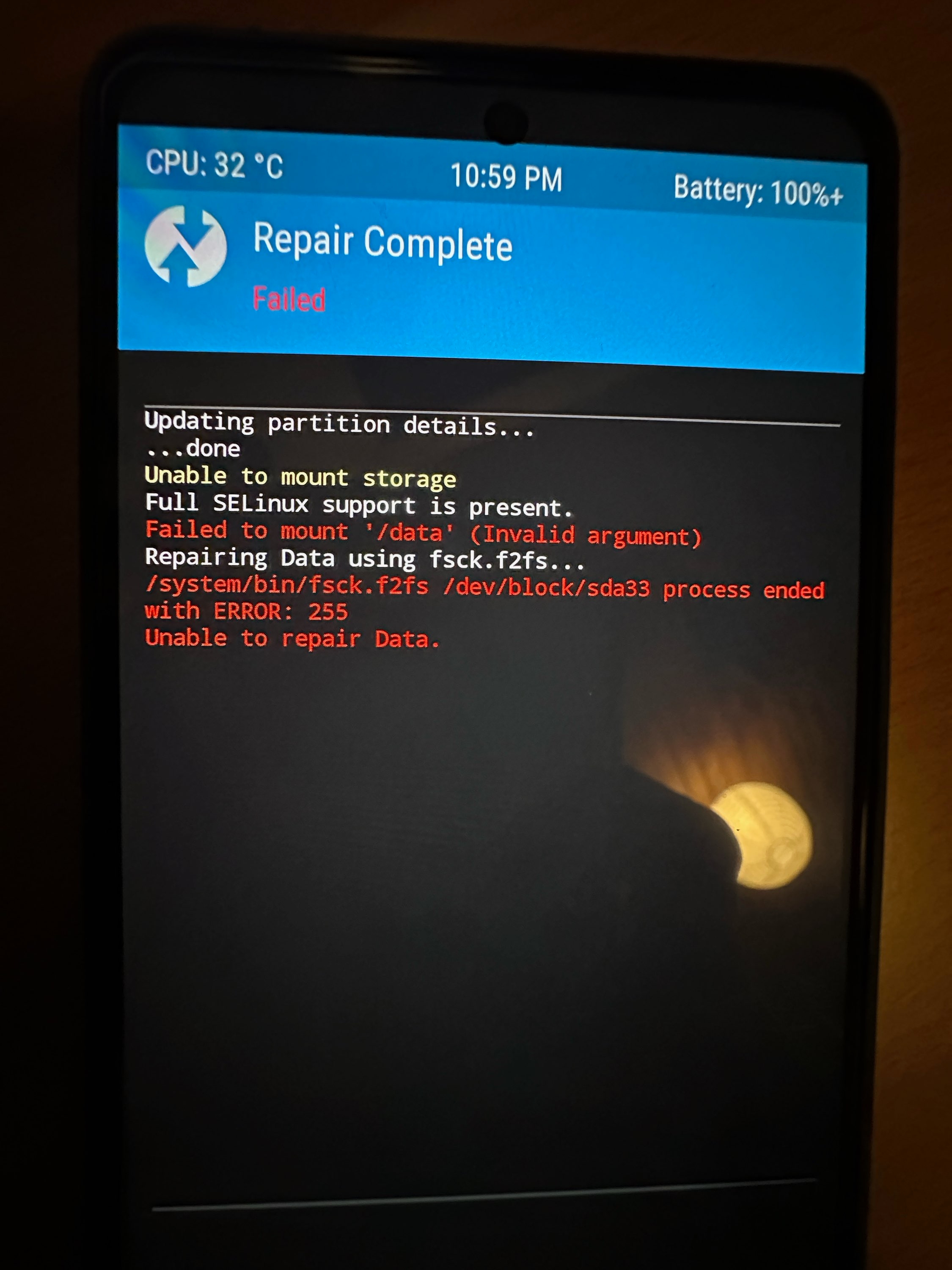

Hi everybody, please a little help would be really appreciate: after flashing HyperOS EU rom (made that 4/5 times already) i wanna re install twrp but after flashing it again (/advanced/flash current TWRP) then my storage is 0mb and impossible to mount /data (saying that unable to decrypt /data because of invalid argument...
But someone told me it was able to install it with no problem (so prob is on my side)...
Please how can i fix this problem please ?
In advance thanks a lot for helping me

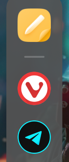

I have a question: The combination of quick note and sidebar does not work. From some point after updating all xiaomi firmware. EU (they fixed some problem with the payment system) the combination of these functions stopped working correctly. That is, if we turn on quick notes, a floating element appears on the side which you drag and quick notes appear. When you turned on the sidebar, the quick note function was fixed above, then the line went to the applications that can be launched in the window. In current versions this feature does not work together. Moreover, in the official stock firmware everything works. So the question is whether it will work). I just use it a lot. And it really hurts that it doesn’t work)
