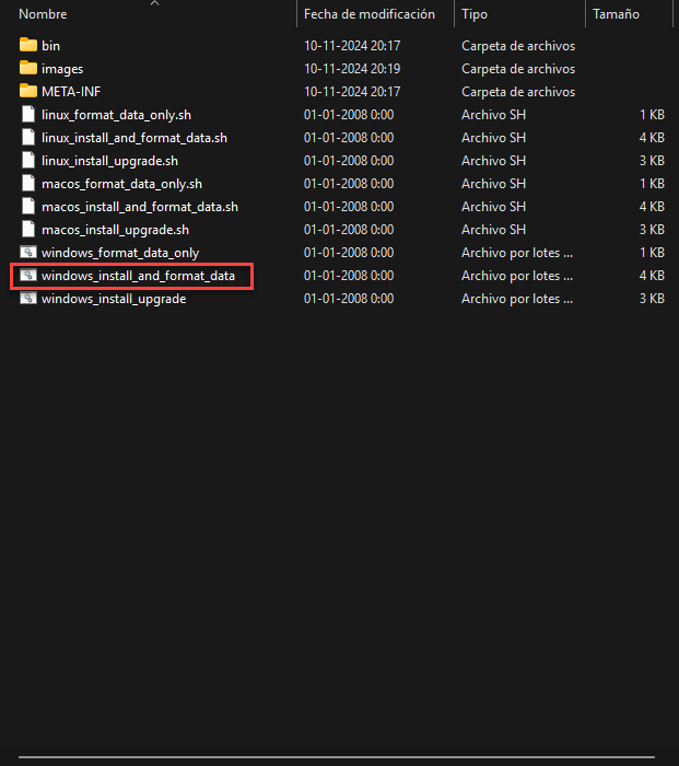

If you are going to do a clean installation, that's how I did it
1 install twrp, you can find it here
with this instruccions
Devices with Dedicated Recovery Partitions (A/B):
These devices have dedicated "recovery_a" and "recovery_b" partitions.
The custom recovery image can be flashed to "recovery_a" and "recovery_b" partitions directly.
Flashing to "recovery_ab" will flash to both "recovery_a" and "recovery_b" with a single command.
The custom recovery will persist across ROM updates.
Platforms: Snapdragon 685, 7/7s/7+/8/8+ Gen 1/2/3
Devices: cupid, diting, fuxi, garnet, houji, ingres, ishtar, marble(in), mayfly, mondrian, nuwa, shennong, socrates, tapas/topaz, thor, unicorn, zeus, ziyi
Image size: 100 MiB (104,857,600 bytes)
Installation:
Code:
fastboot flash recovery_ab recovery.img
fastboot reboot recovery
2 install the rom via fastboot, since twrp does not decrypt the internal space, using the bats that are in the zip of the rom, whether it is mac or windows, and if it is a clean installation, always with format data (with this you lose all the data, back up your stuff)
3 install the network fix that I leave you below, everything is done by fastboot

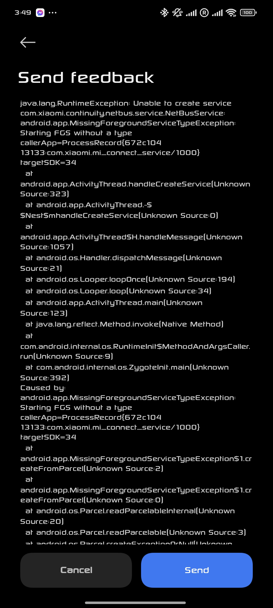

updated MANET to hyper os, fw 2.4.0, mi connect is crashing every 2-3 minutes... what to do ?
mi connect version 4.0.238.10
upgraded over hyper os 1

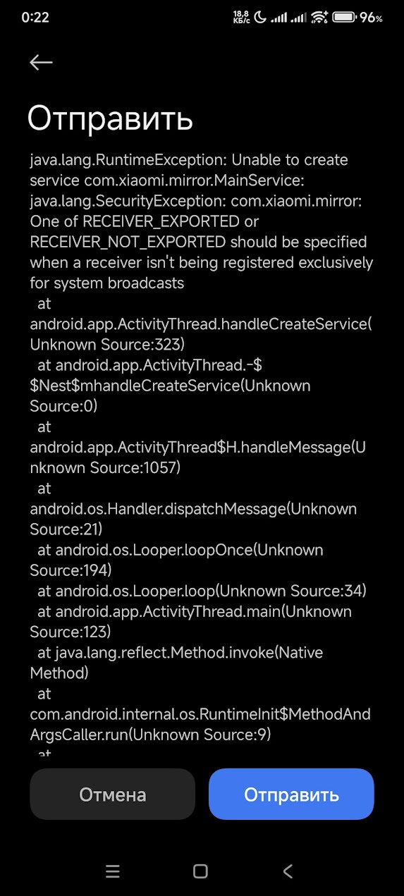

and second bug with some other service...

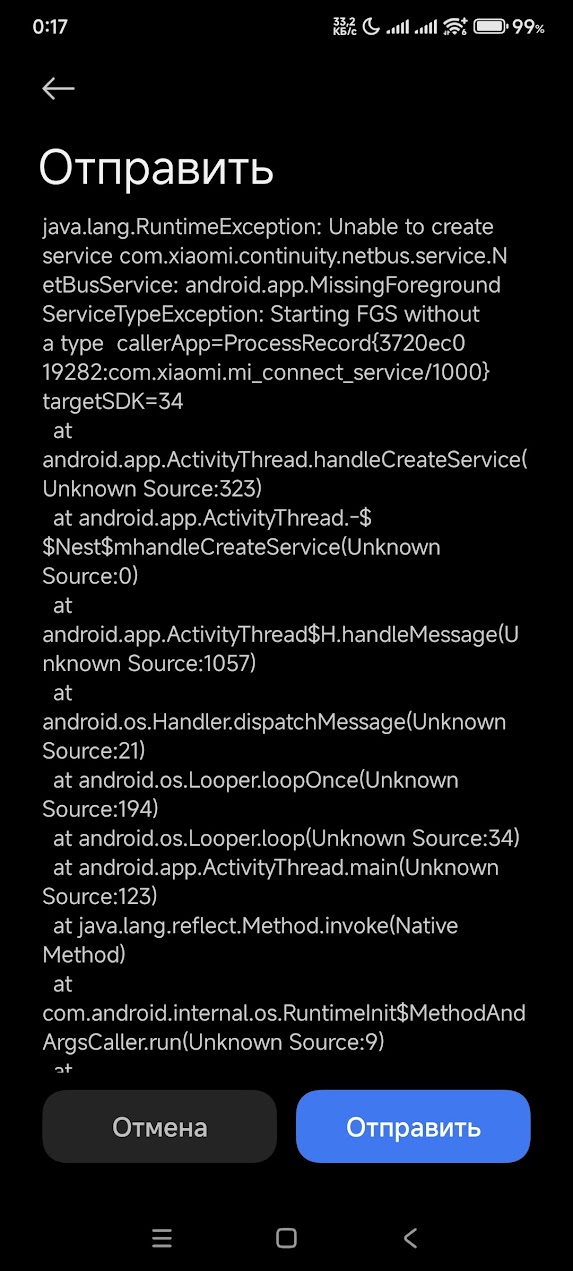

Same here. Mi connect is always crashing. Then, battery is draining fast. Manet (Redmi K70 Pro)

For Mi Connect problem, you can disable Mi Connect temporarily by
Code:
pm uninstall -k --user 0 com.xiaomi.mi_connect_service
until this problem is fixed by Xiaomi
