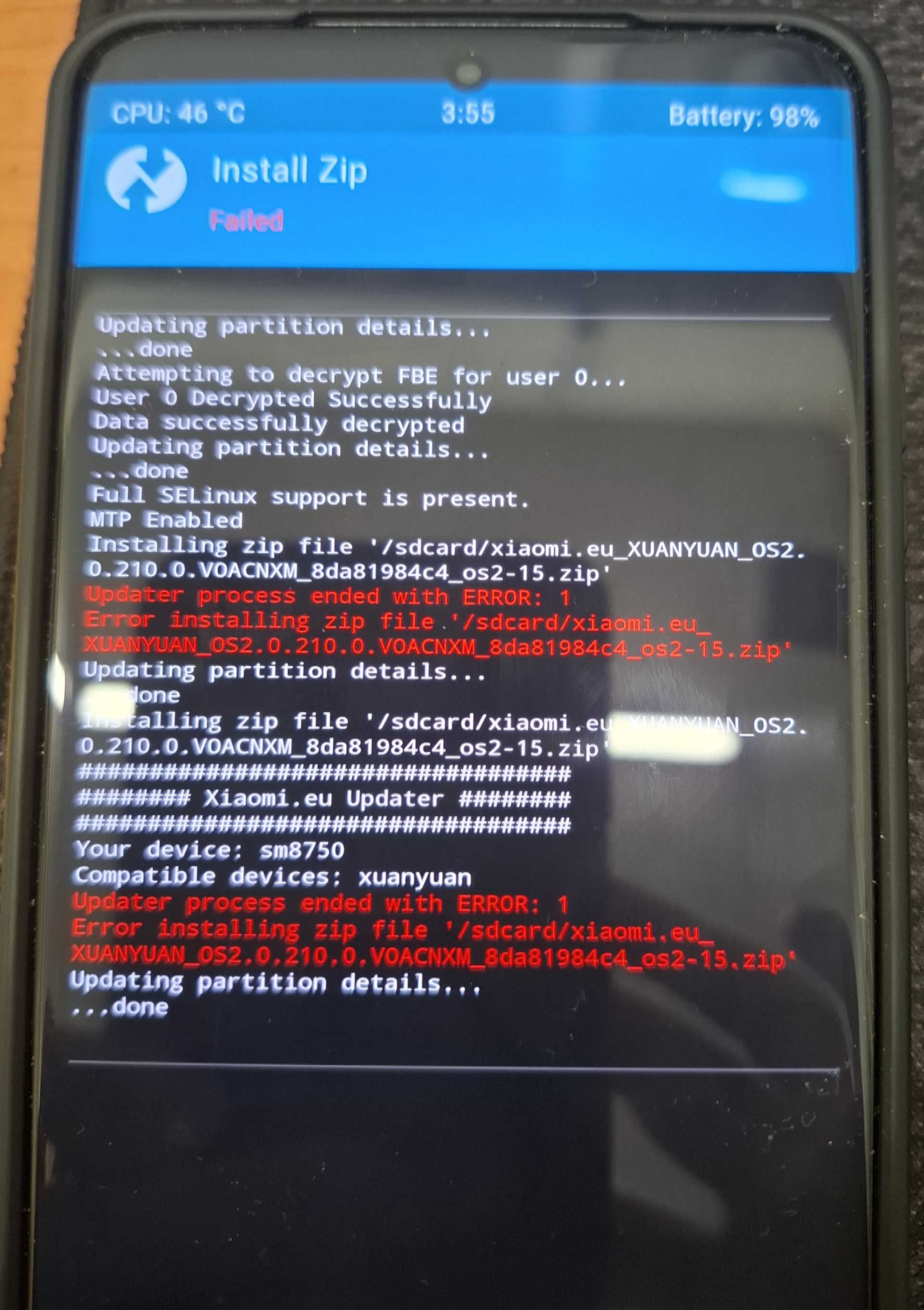

Hello! Yesterday I to install TWRP on my Xiaomi 15 Ultra ROM but it stops with an error. Is TWRP faulty or am I doing something wrong? I put the rom in the root of the storage, not in a folder, but it doesn't work.
Broken TWRP, install with the fastboot scripts.
