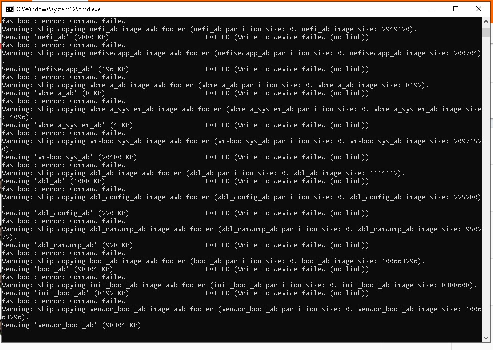

Hello. After running install and format_data, errors begin on the command line and everything closes. The smartphone itself does not start after all this. It turned out to bring the smartphone back to life after updating the official firmware.
