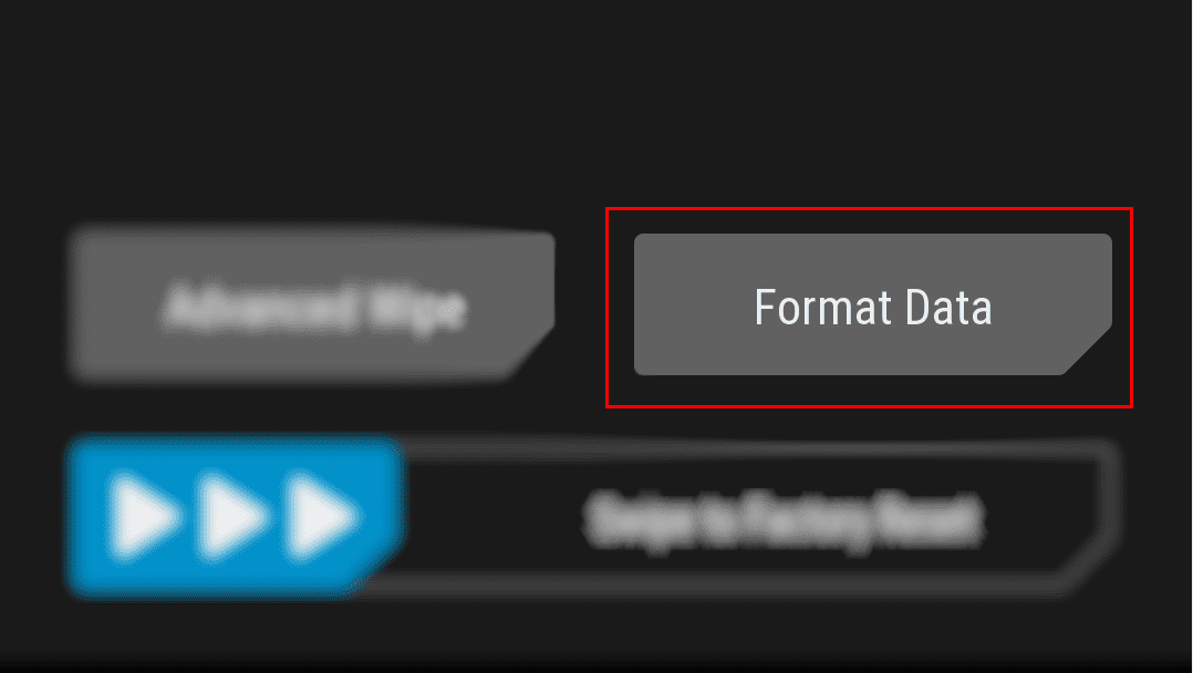

Did you wipe the data with the button (not the v check box)?
D
Deleted member 210509
I see some users are having trouble understanding the difference between wiping and formatting.
Wiping just deletes all the files but keeps the encyrption on. Formatting data will remove all the data including encryption. So, better back up all your files from /sdcard folder as everything will be wiped out from the phone.
Format the Data partition (Format Data - you will be asked to type "yes") and copy the files by either "adb push" or Mount/Enable MTP and copy it from your computer and continue with the installation.
