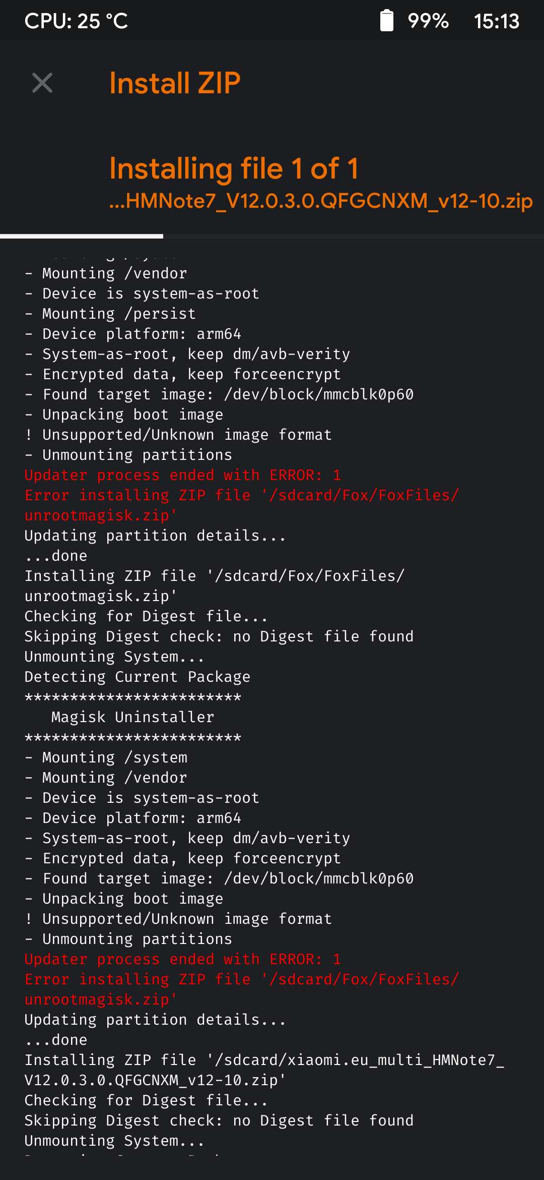

could anyone explain how we could update the latest magisk 22 because the magisk manager is no longer available....i turned the apk to zip file and it didnt want to be installed at all it gives you an error message
THE DEVICE IS NOT BOOTING TO SYSTEM IT DIRECTS TO FASTBOOT....any way i managed to flash the full rom zip file to get the thinks settelled as it was before and in order to restore the stock boot image.....there is a serious problem with thhis magisk stuff

To get back to your issue, are you able to try the same with TWRP recovery instead of OrangeFox? Maybe there is some compatibility issue with OrangeFox.
Reactions: fatjoez
orange fox is a custom version of twrp
we use the step 1 just when you don't have twrp, you already have it
step 2 does not concern our Xiaomi.eu ROMs so forget about it
best way is to rename the app and go through recovery
or uninstall magisk binary completely and install the apk file on ur system then install from the inside with the recommended option listed there
