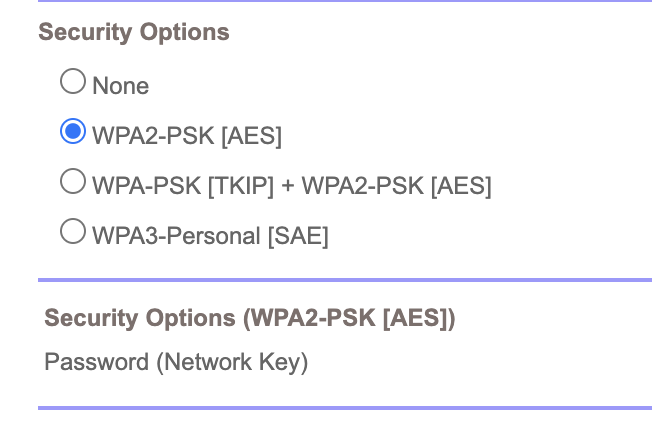

Hi, here is a solution worked for me. I changed the security options of my wifi to wpa/wpa2 encryption and now the projector works without dropping the internet. Try a slightly lower level of encryption. Mine was a very secure, maybe the projector not have been able to handle this.
hmmm mine is set to this already, but still having problems
Did you try reboot the projector and connecting again to the wifi? I am pretty sure this update has made it harder for the projector to handle encryption for some reason, so somewhere here will be your solution as well.
yeah it reboots every day, but still the same

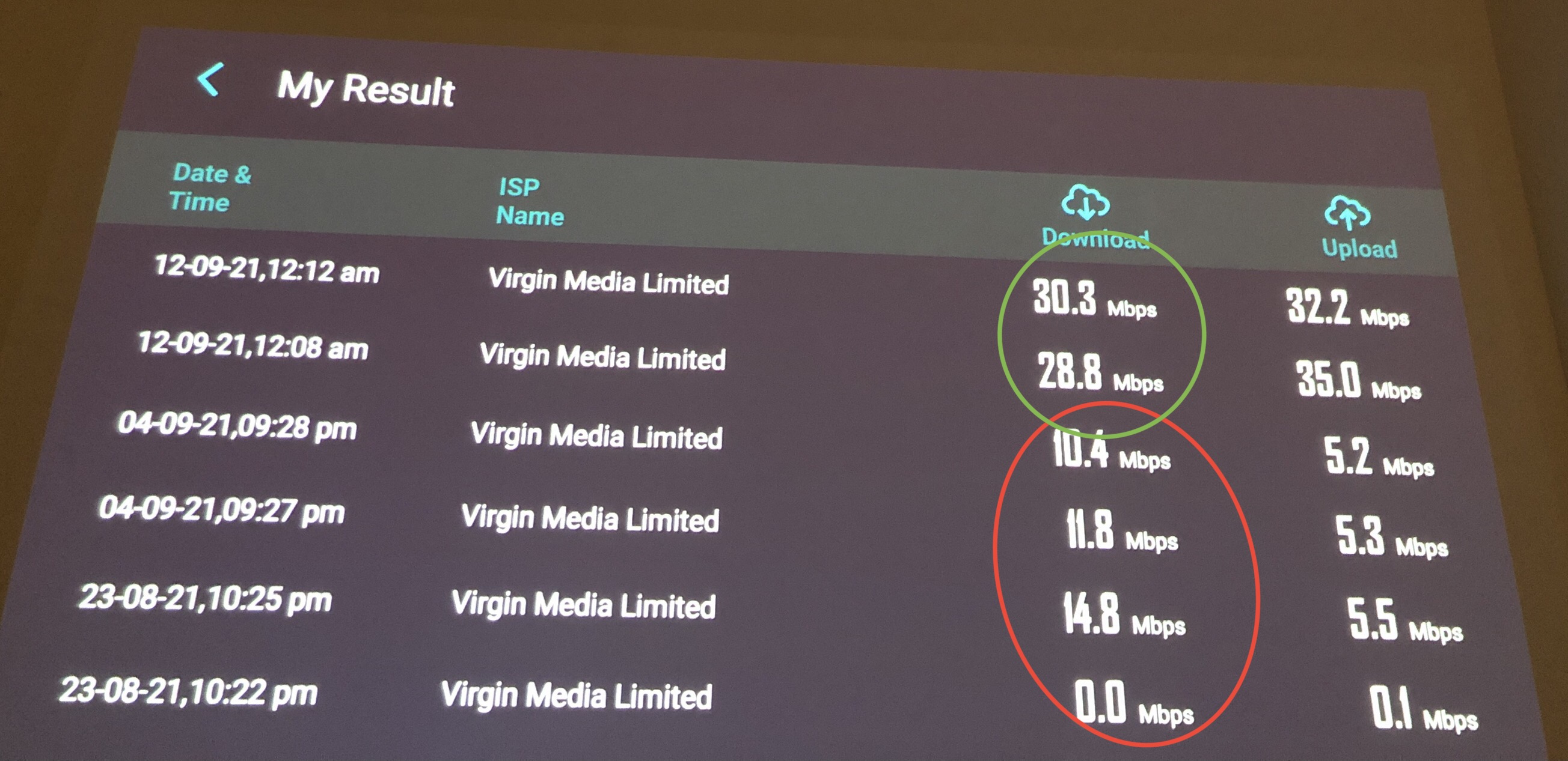

hey I don't want to speak too soon, but I might have found a clumsy fix.
my network set up previous to this evening was:
Virgin Media Superhub 4 running in modem-only mode >>> Orbi mesh network >>> Mi Projector
I just remembered that I have another small xiaomi extender (this one) plugged in to extend my wifi outside the house. It has its own network name from the main mesh.
I tried connecting the projector to this network and it suddenly seems to be working ok!
Virgin Media Superhub 4 running in modem-only mode >>> Orbi mesh network >>> Xiaomi Extended Network >>> Mi Projector
Look at these speed differences. I've gone from being totally unable to connect and on good days only getting an intermittent 10 mbps (red circle) to consistently getting around 30mbps without dropouts (green circle)
I guess it might just crap out again in the coming days, but I'm ok with this if it holds up.
