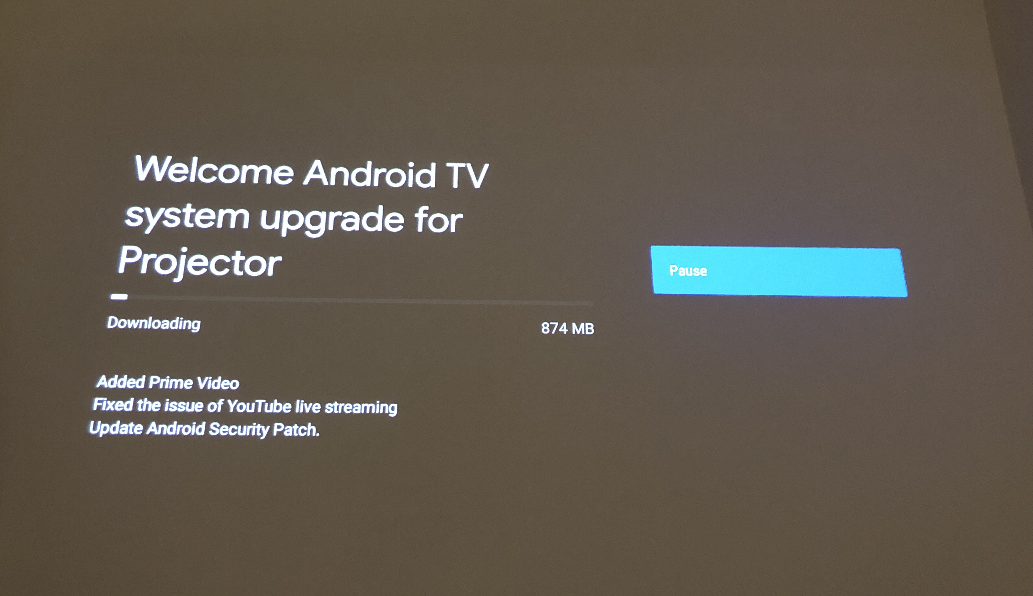

There are message to upgrade on the top to the right.
Casting work for me before.
Hmm I only got this android update
I hasn’t fixed the WiFi problem for me. Connection still flops between too slow to use and not working at all

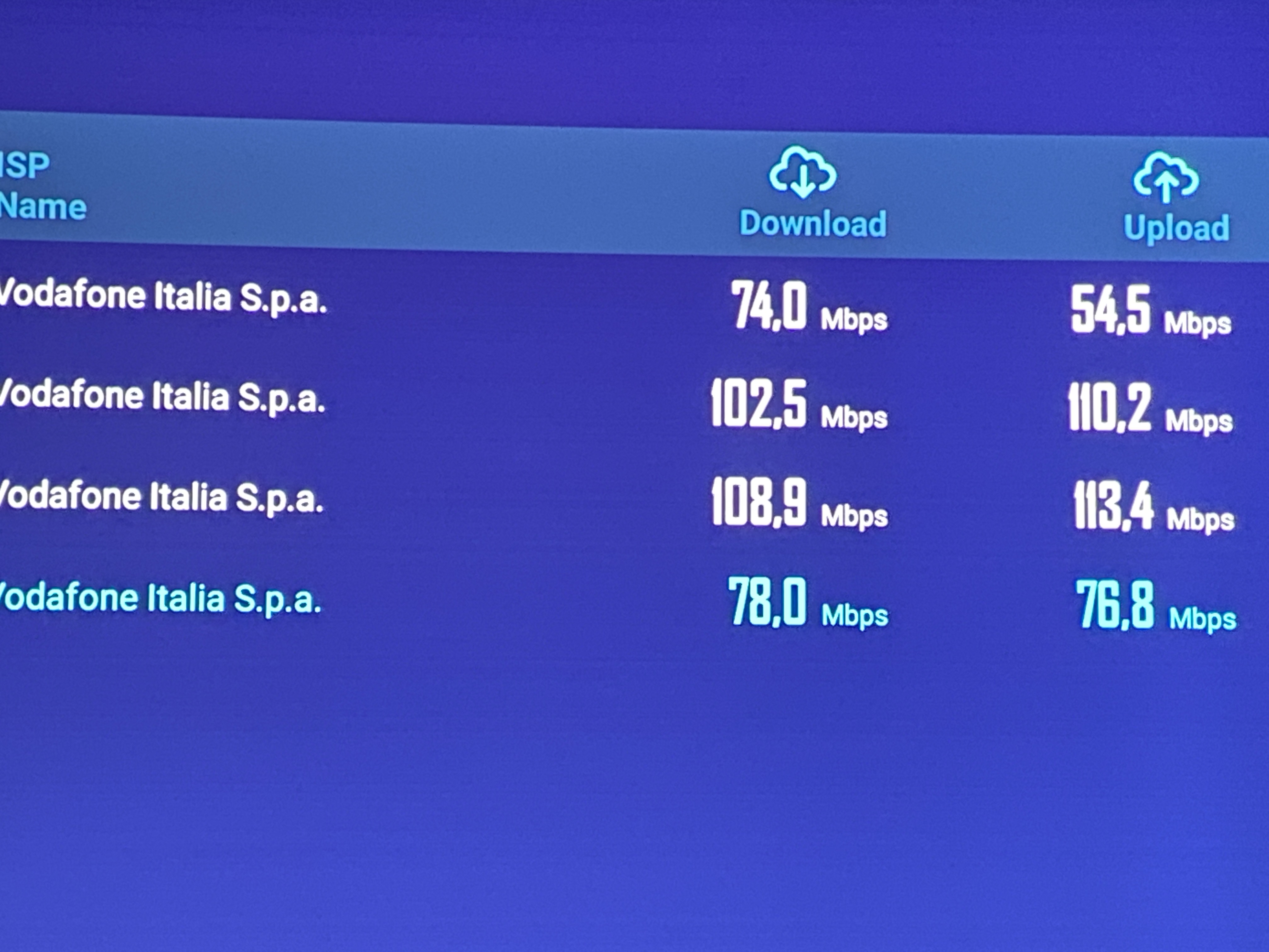

oh i restarted it a couple of times and my wifi is finally connecting again at over 120mbps!
yeeeesssss!!!
I make some speed test at 2.4 and at 5ghz...hear the difference neare double fast in 5ghz

Yes, new update and wifi is 10x times better. No disconnections on 5GHz network.
FINALLY....
