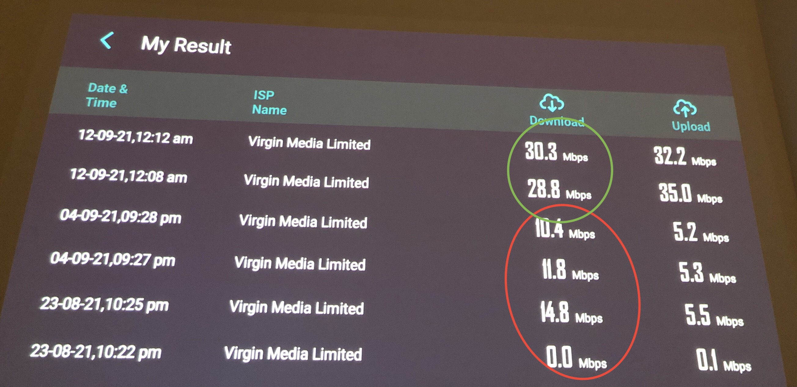

Look at these speed differences. I've gone from being totally unable to connect and on good days only getting an intermittent 10 mbps (red circle) to consistently getting around 30mbps without dropouts (green circle)
I guess it might just crap out again in the coming days, but I'm ok with this if it holds up.

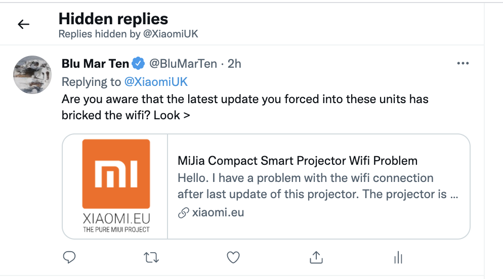

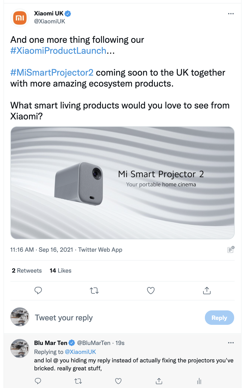

lol @ xiaomi uk

if you use twitter, you can add your comments to this thread -

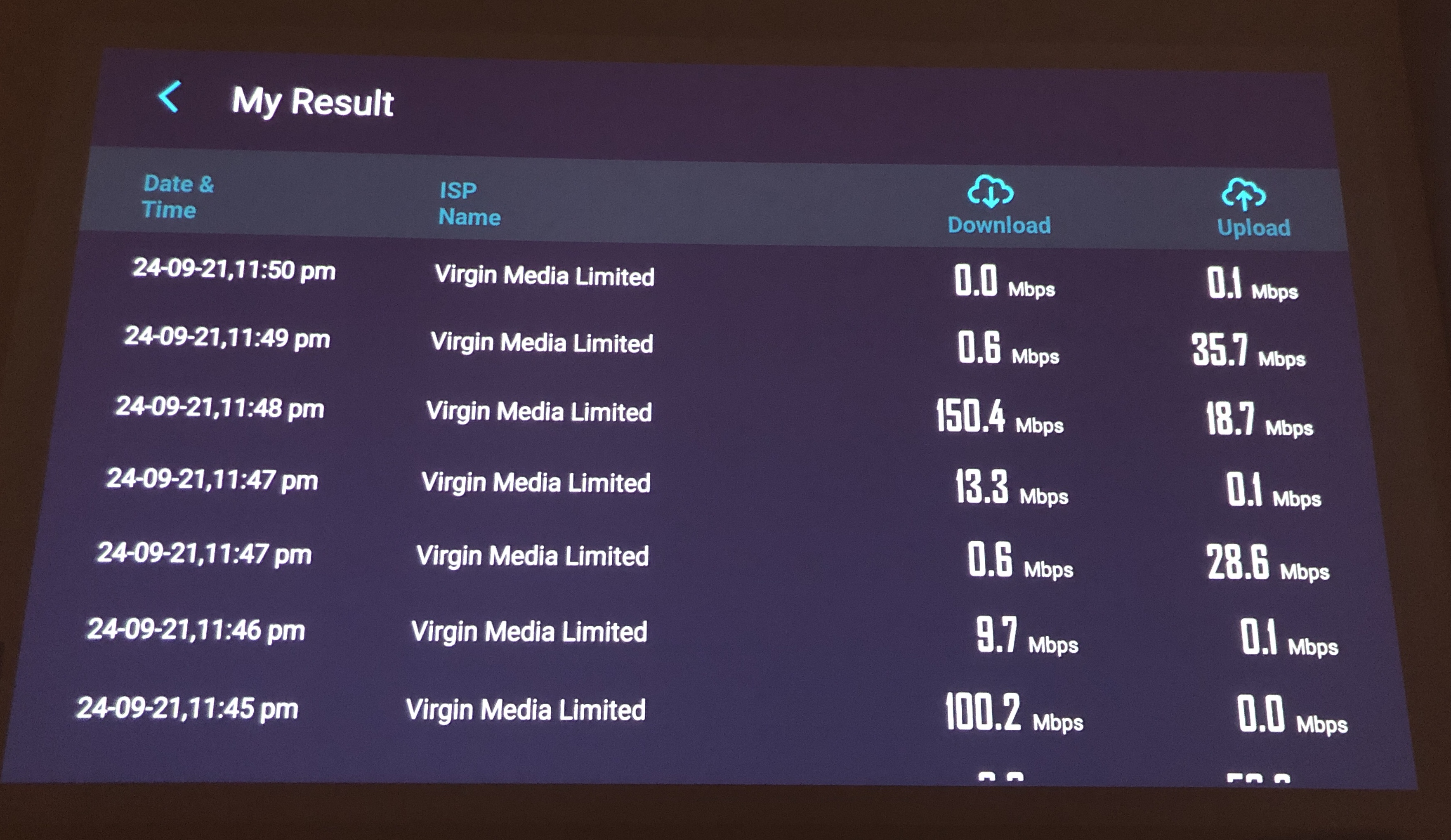

yes look at just how unstable the wifi is.
in the space of 60 seconds it can swing from 150mbps to 0.6mbps

lol no. add your comments to this thread -
