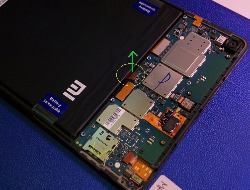

My mipad was totally bricked because a wrong selection on a superSU upgrade prompt.
WITH THIS SYSTEM YOU LOSE YOUR WARRANTY
I am not responsible for any damaging your device
Following the russian forum , i made the following steps ( I’m not English speaking ):
On the PC , run Miflash ( follow other guides on forum how to use it and flash )
Remove the plastic cover : with the fingernail you should easily separate the plastic cover from the screen , running around the perimeter; the cover is quite soft , so don’t worry to break it. In the area of the camera cover there’s some scotch tape.
Remove the plastic panel near the battery: there are a lot of screws, by unscrewing them you LOSE THE WARRANTY!
Disconnect the battery flat cable by pulling it gently up , it’s very easy to do
Connect an usb cable to the mipad side but don’t connect it to the PC, wait
Make a bridge ( short circuit ) between the two pads located inside the SD card slot: you can use everything that is metallic .
Connect the other side of usb cable to the PC , keeping the short circuit.
Once you connect it , remove the short circuit and Miflash should recognize the device ( the pc detects a a new device USB (Nvidia, Qualcomm) Boot-recovery driver for Mobile devices )
The first time I did this, miflash saw nothing ( but the driver were detect ) so I disconnect the usb cable gain , made the bridge ( short circuit again ) , connect the usb cable again and miflash then saw the device.
Then you have just to flash it with miflash.
After flashing , connect the battery , close everything and run your mipad.
Many thanks to the russian guy.

Just to add my 2 cents about bognik's procedure. I went through exactly the same thing and finally brought the pad back to life this afternoon:
1) It didn't work within Windows 8 for me. I had to do it on a Windows 7 machine.
2) You have to start Windows 7 with Driver Digital Signature turned off. You accomplish this by pressing F8 while restarting windows and then selecting to turn off driver signature.
3) The computer only recognized the pad as an APX device. I had to update the driver via Device Manager.
4) I have never found google translate so useful in Chrome.
Good luck everybody!
Ben Li
Apr 7, 2014
8
21
PS. You would not void your warranty if you do not unscrew the top-right and bottom-left screws(they are covered by a orange Mi sticker). It is possible to disconnect the battery with some delicate handiwork. Or, if you have some way to drain the battery, you wouldn't have to resort to opening up the pad, though I have no idea how to do that).
