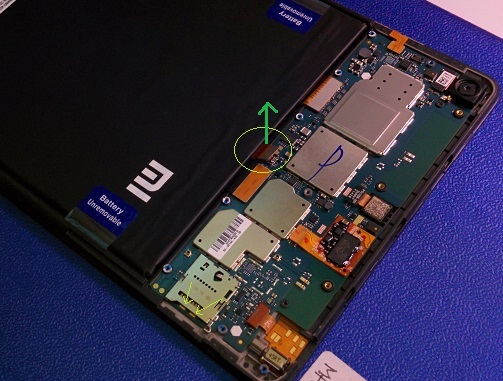

My mipad was totally bricked because a wrong selection on a superSU upgrade prompt.
WITH THIS SYSTEM YOU LOSE YOUR WARRANTY
I am not responsible for any damaging your device
Following the russian forum , i made the following steps ( I’m not English speaking ):
On the PC , run Miflash ( follow other guides on forum how to use it and flash )
Remove the plastic cover : with the fingernail you should easily separate the plastic cover from the screen , running around the perimeter; the cover is quite soft , so don’t worry to break it. In the area of the camera cover there’s some scotch tape.
Remove the plastic panel near the battery: there are a lot of screws, by unscrewing them you LOSE THE WARRANTY!
Disconnect the battery flat cable by pulling it gently up , it’s very easy to do
Connect an usb cable to the mipad side but don’t connect it to the PC, wait
Make a bridge ( short circuit ) between the two pads located inside the SD card slot: you can use everything that is metallic .
Connect the other side of usb cable to the PC , keeping the short circuit.
Once you connect it , remove the short circuit and Miflash should recognize the device ( the pc detects a a new device USB (Nvidia, Qualcomm) Boot-recovery driver for Mobile devices )
The first time I did this, miflash saw nothing ( but the driver were detect ) so I disconnect the usb cable gain , made the bridge ( short circuit again ) , connect the usb cable again and miflash then saw the device.
Then you have just to flash it with miflash.
After flashing , connect the battery , close everything and run your mipad.
Many thanks to the russian guy.

Thanks a lot BogNik..... I was able to unbrick my MiPad by following your guidance.....
I had to face some problems but eventually it got resolved....
I would like to share some info for those who are facing problems like I had and for those
who want to save their time in troubleshooting....
First of all those using Windows 8, in order to overcome driver signature, restart your PC by
pressing Shift Key and clicking restart simultaneously. After your PC restarts you will be provided
with a number of options.....Select Troubleshoot then select Advanced Options then select StartUp
Settings then select Disable Driver Signature......
The other problem I faced was my device was not detected because of old version of MiFlash.....
So please use the latest version of MiFlash....
And the last problem was during flashing MiFlash was unable to flash my device with numerous
errors like nverror....The problem got resolved by connecting the battery again as soon as the
device is detected by the PC and then flashing it with MiFlash
That's it....Enjoy and Once again special thanks to BogNik (member of this site) for providing
such a great tutorial :)

I just couldn't thank you enough! Its only because of following this guide that I was able to revive my hard bricked Mi Pad.
