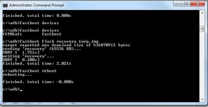

Hi all!
First time trying to install TWRP through adb to Xiaomi mi8SE.
Bootloader is unlocked.
All was ok... but after reboot can not boot into TWRP, but Mi-recovery 3.0 in launching instead of it.
Have tried to re-install TWRP twice... nothing....
So .. what I could be done wrong from my side?
What points need to be rechecked from my side?
Have someone full manual step by step about the process ? or give pls link to proper forum thread.
Thank You in advance.

Hi all!
I think you are not following Post #1.
After fastboot flash recovery twrp.img
you should execute
fastboot boot twrp.img (not fastboot reboot)
See post #1.

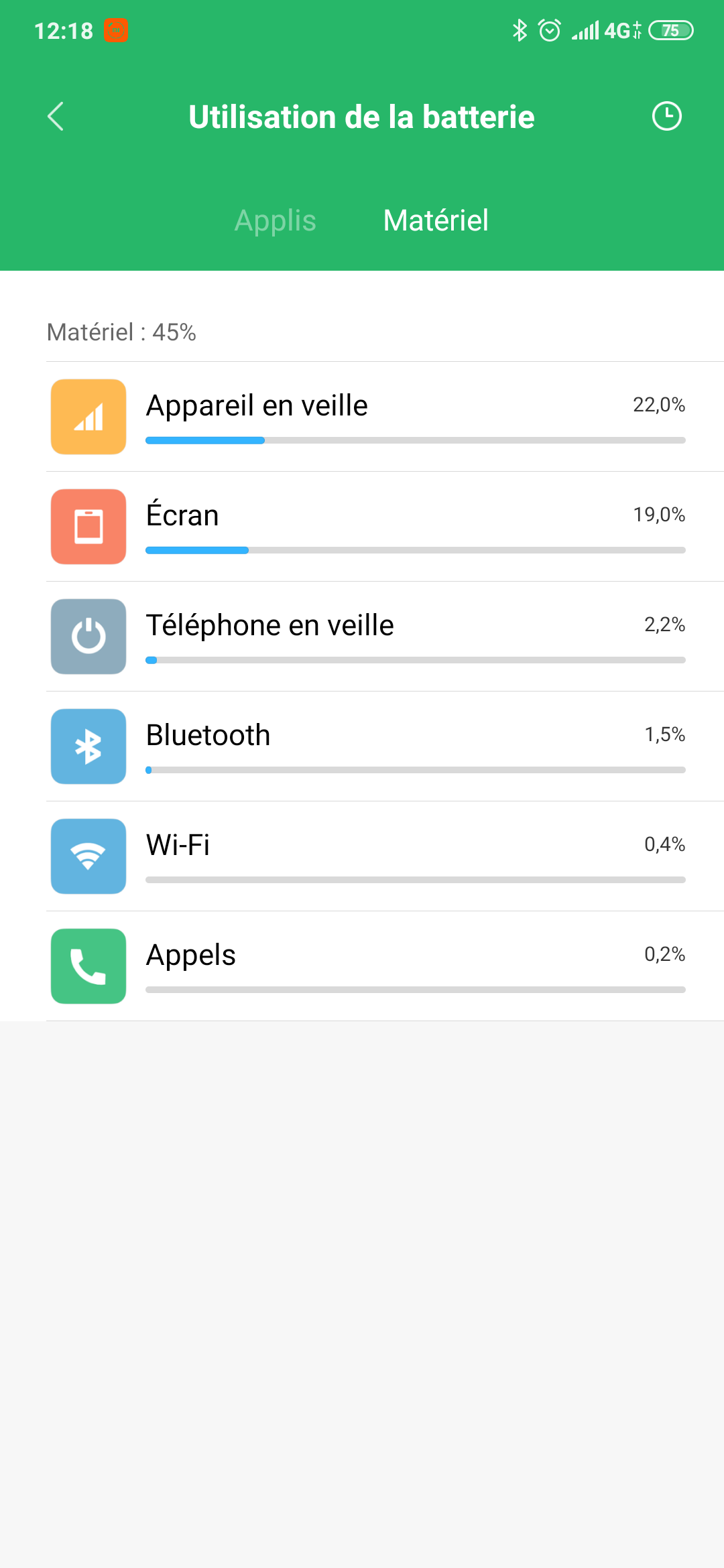

Hi everybody,
I'm on stable 10.2 on mi mix 3 and i've Big battery drain with 25% of cell stand-by. I have one sim in the phone. Someone have the same issue? And do you have a solution ? Sorry for my pour level in english and thanks for tour great works.
I post a screen capture of the battery indicator
Is the consumption of
"android system 30% for 4h30"
"screen 28% for 7h30"
is high ?

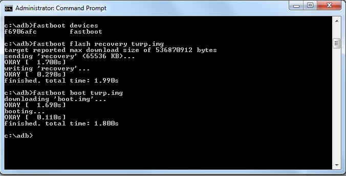

Thank You very much!
Really my mistake. Understood wrong from post #1.
This time did everything in proper way, BUT... after fastboot boot twrp.img+Enter
everything came smoothly (see attachment), then fastboot rabit switching off and nothing happens, just black screen.
Phone is ok. Not like a brick. :) It is possible to switch ON by Power button. I have been trying to switch on with volume UP pressed button as well. NOTHING.
Can not launch TWRP. :(
What else problem can be?
