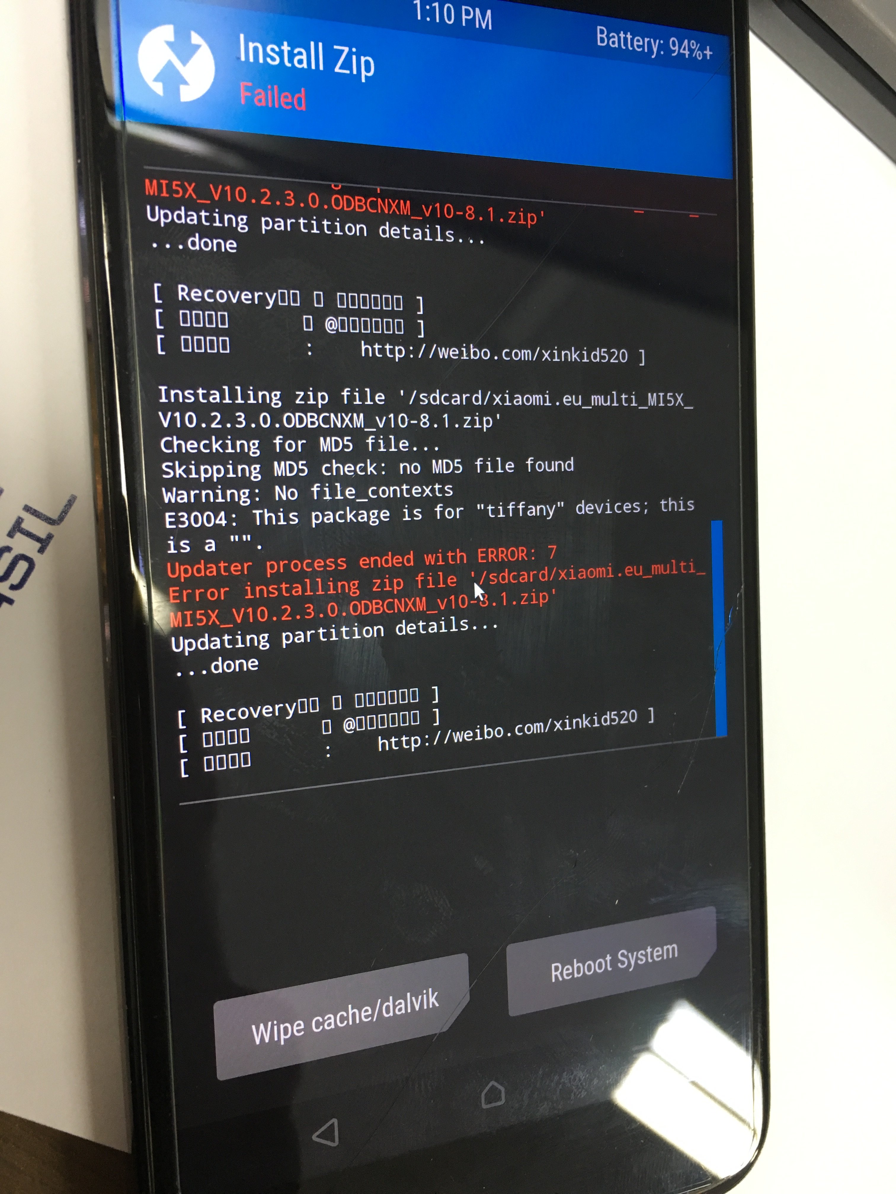

TWRP version MUST be 1102 or 1217 not 1227.
Do a simple "fastboot boot ......img" in order to check.
i don't have to do that , i have it in my computer from back when I flashed the xiaomi.eu software. it is the twrp 3.2.1 version . funny thing that from miui 10 oreo to miui 10 pie i updated via the phone updater after downloading the update package. Ok so, please tell what now???. flash twrp via fastboot??? some link to step by step or video for that?
thank you in advance !

I am sorry but our chinese friends made modification at rom level that makes earlier TWRP obsolete from latest STABLE rom to this new release.
You must change it by yourself and move to 3.2.3 version.
https://drive.google.com/drive/folders/1IeCtb6vRO4CRe76s0BD_5TQiSnymPBTT
The Simplest is to boot twrp ( 1217 or 1227 version, to be tested in order to keep the one that boot fisrt) from your computer via fastboot command and then install the rom you have downloaded from the site here.

Succefully flash 10.2.3.0 from 10.0.1.0 on my Mi 8 SE.
You need :
- Twrp1102.img
- Twrp1217.zip
- Eu Rom 10.2.3.0
---------------------- INSTALLATION ---------------------
- Backup your data on your computer if needed.
- Flash Twrp1102.img with adb.
- Boot to recovery then FORMAT data + wipe.
- Copy 10.2.3.0 from computer to your phone.
- Flash 10.2.3.0, DON'T REBOOT and simply go back.
- Copy Twrp1217.zip from computer to your phone.
- Flash Twrp1217.zip.
- Wipe Dalvik Cache.
- Reboot to recovery.
- Reboot.

working on it right now unforunately does not work with twrp 1227 , i am trying twrp 1217 . I just cannot boot in to twrp. stays stuck in the black mi screen
