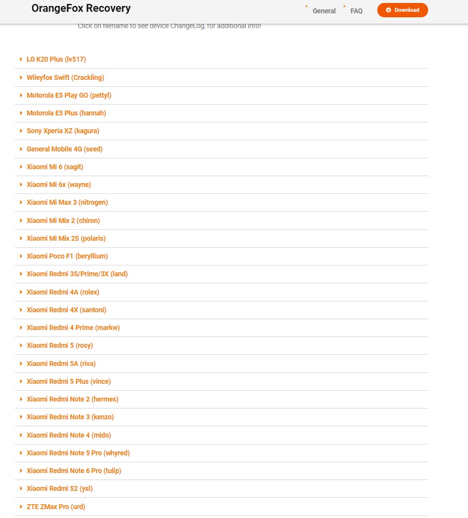

Procura na net orange fox recovery e instala a partir dai
Good afternoon!
Not available for the MI5x version
You're serious? What do you think this forum is for? You didn't inform yourself what this here is about. You should do that before you post any more comments.
