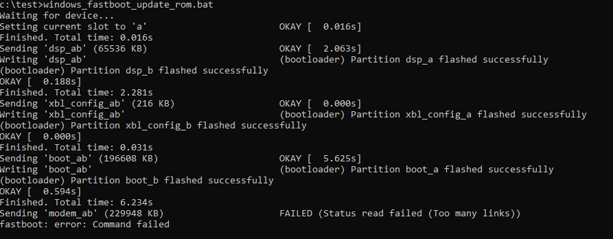

Hi guys,
Just want to know what went wrong here. I was on xiaomi.eu 12.5 stable Ã11 and wanted to update to 13.
Used the update_rom script.
Got stuck in here and then phone died on hard brick.
Should I use first install instead?
Does it fail on different part? My friend's phone fails with same error on different part.

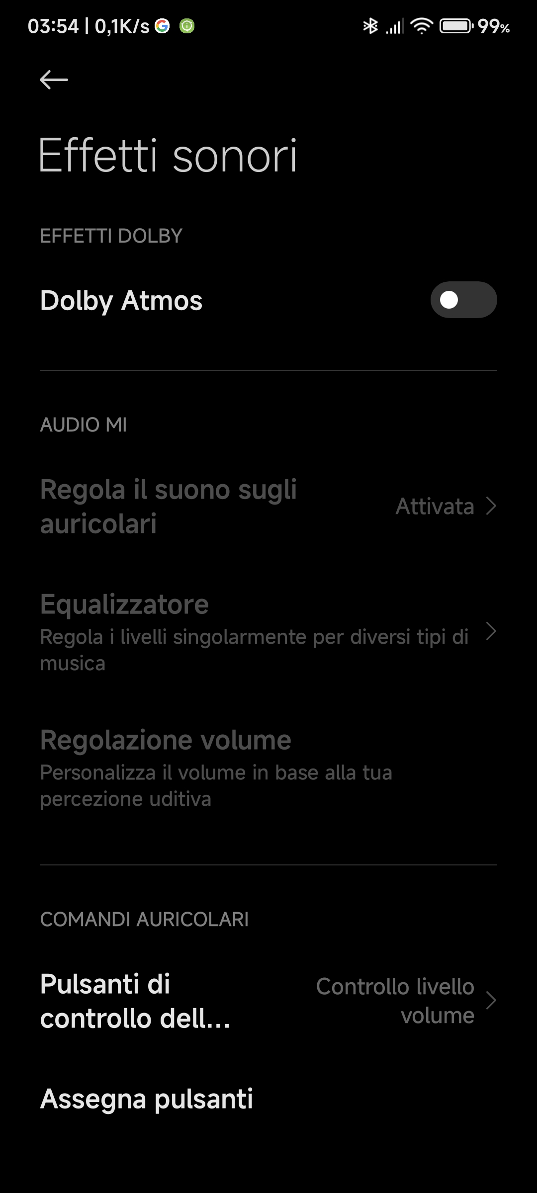

Hello, I updated from 13.0.3.0 to 13.0.5.0 on Poco F3 and I no longer have the ability to change the sound of the bluetooth headphones ... I had changed and activated it but now it no longer allows me to enter as you can see is the gray menu. however it says it's active ... Any solution ? Thx

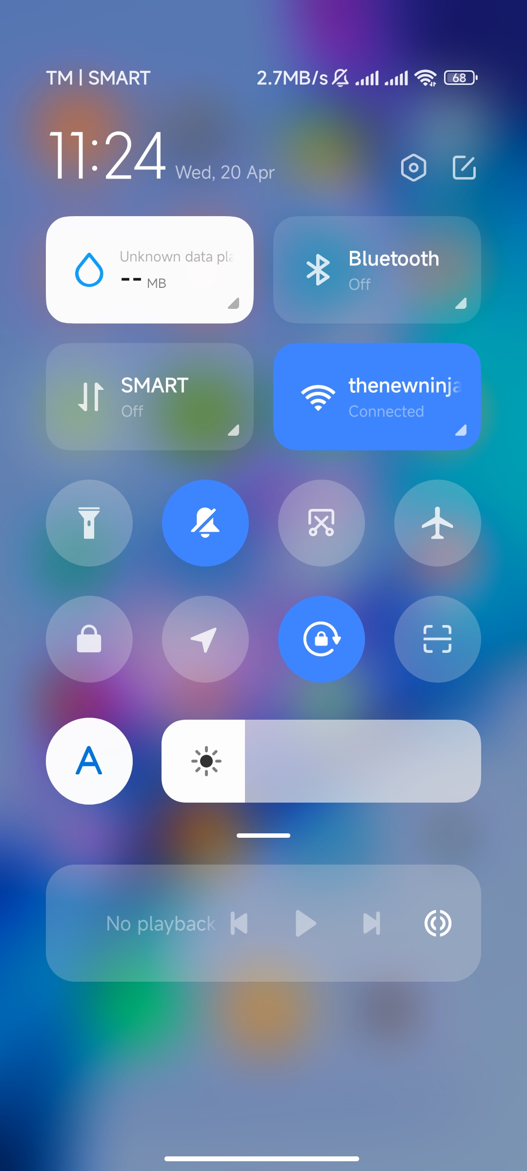

I have no problems with smoothness and speed of this update. However, the notification panel seems the old one. Am I right?

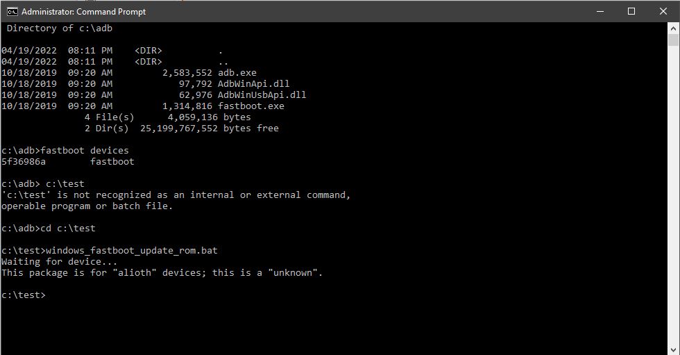

my f3 update from 13.3.0 to 13.5.0,but i use cmd to fastboot update,the f3 cannt to detected
what is problem?
what is problem?
check your device codename
# fastboot getvar product
- it should be "alioth"
if it is the correct rom you can try this
- delete the line in the script with the check
- try to use cmd.exe instead of powershell
- change USB port / change USB cable
- use USB 2.0 / use an USB Hub
- check driver installation

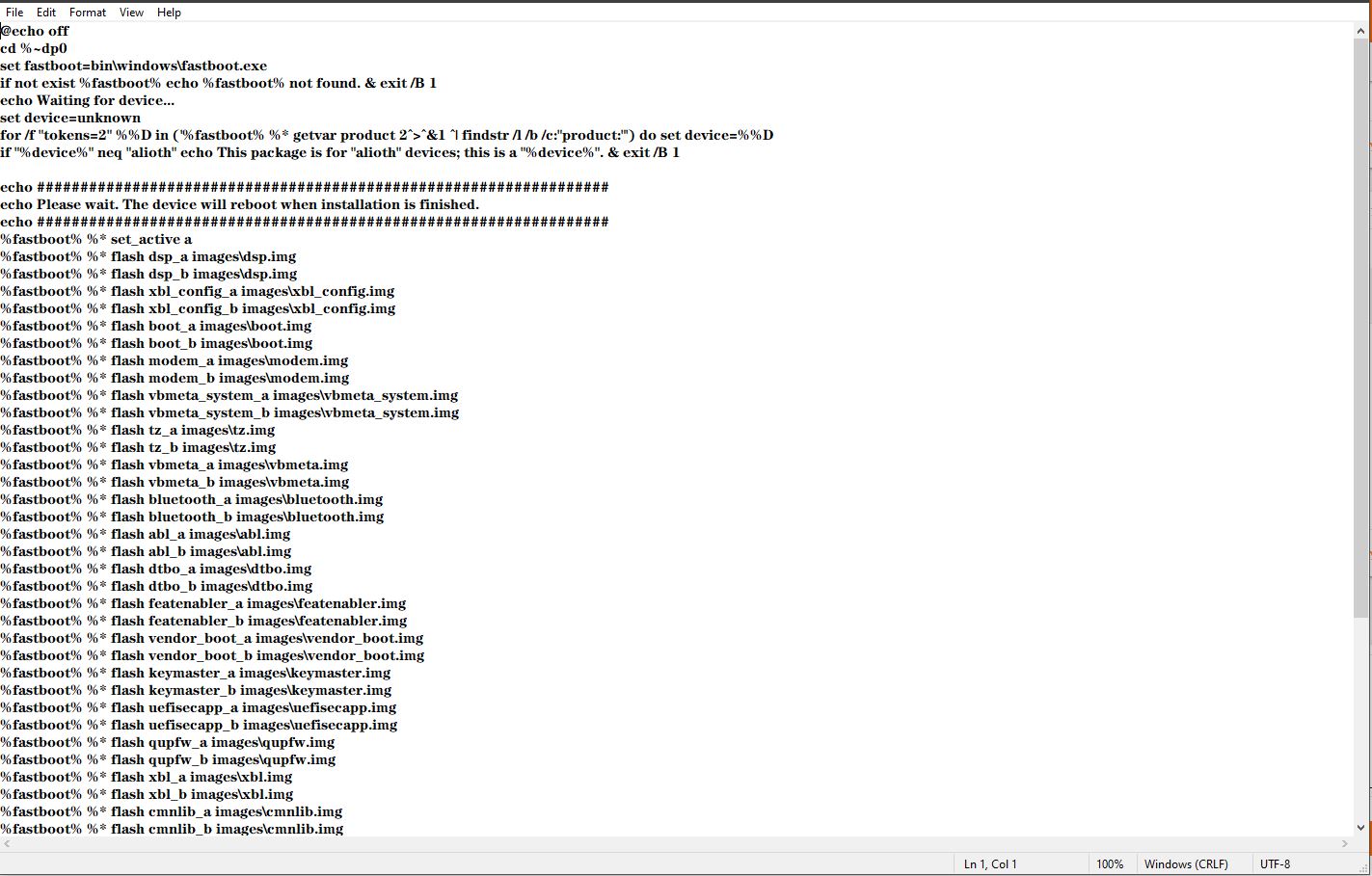

which link i need delete?
