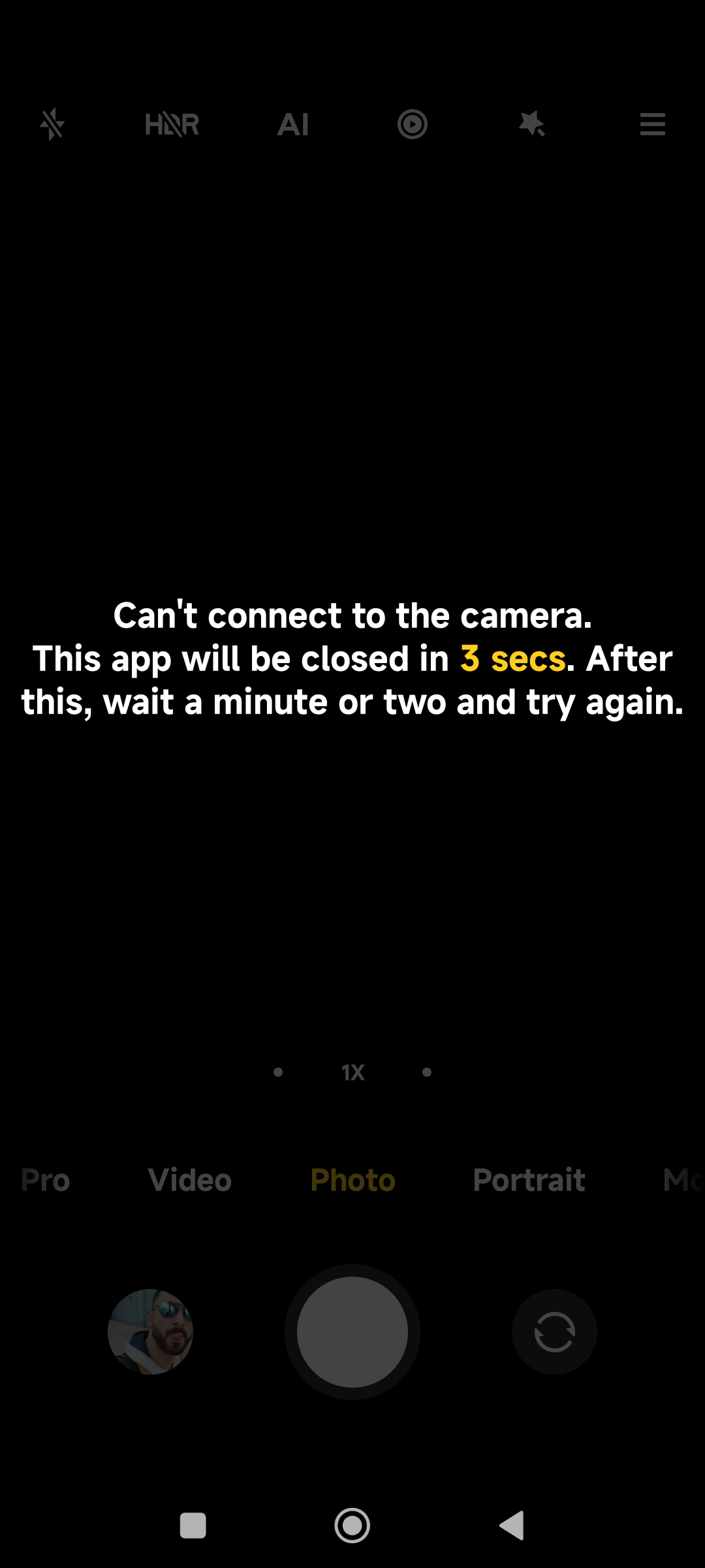

Hi folks.
After trying the last MIUI 13.0.4.0 SKFMIXM (stable) on my Redmi Note 10 Pro for some days, I'm experiencing a frecuent camera app crash everytime I open it. A warning message pop ups and cam closes after three seconds.
If you are lucky and the camera stays on, you can't change to other modes (selfie, pro, etc.) because it crashes. I've tried to fix this situation with the long-press back button, cleaning the cache/data, rebooting the terminal and checking all the permissions but no luck. I have no idea about what to do next. I've reinstalled the ROM (without clean DATA) but no effect. Any clue about this issue?. Is anyone having the same problem? Thank you!!!

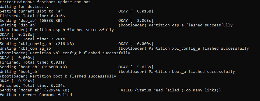

Hi guys,
Just want to know what went wrong here. I was on xiaomi.eu 12.5 stable Ã11 and wanted to update to 13.
Used the update_rom script.
Got stuck in here and then phone died on hard brick.
Should I use first install instead?
