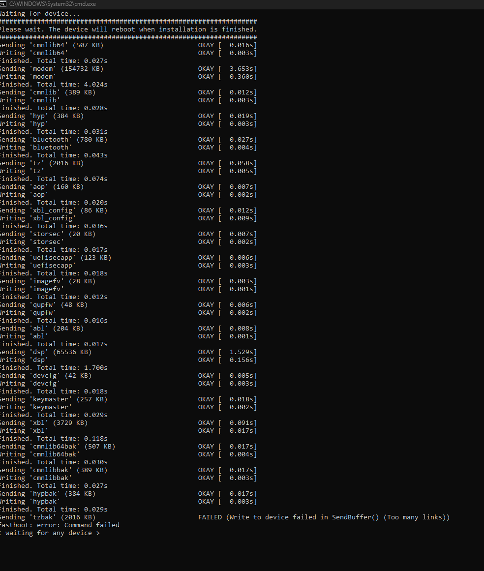

Hi my phone is Mi 11t pro miui 13.0.4 global , when i want to unlock my phone this whats happend . how to do that in right way ?

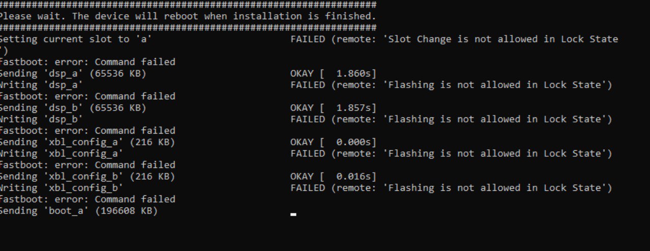

I'm runnig xiaom.eu 13.0.8 in my Poco F4 GT and got a new update to 13.0.9 that I need to install using fasboot.
My question is if I install the new version, if it will format data or not, to avoid losing information or if I need to install everything again like a clean flash.
Steps to install update of xiaomi.eu ROM (All your data and files on internal storage will NOT be deleted!)
- Download our ROM zip file
- Unpack downloaded zip file in the PC using WinRAR
- Connect to PC via USB cable
- Run fastboot installation script from unpacked zip according your PC operating system:
--- For Windows OS - windows_fastboot_update_rom.bat
--- For Linux - linux_fastboot_update_rom.sh
--- For MacOS - macos_fastboot_update_rom.sh
I've follow those steps to install version 13.0.8 and the phone was formatted, if I do the same to install version 13.0.9 the "system" will identify that a previous version of xiaomi.eu is installed and it will only update the ROM, like a "dirty flash"?
Maybe you're wrong.
You used a script to install that clears everything. (clean flash):
For Windows OS ./windows_fastboot_first_install_with_data_format.bat
For Linux ./linux_fastboot_first_install_with_data_format.sh
For MacOS ./macos_fastboot_first_install_with_data_format.sh
A script that does not delete any data is used for the update. (dirty flash):
