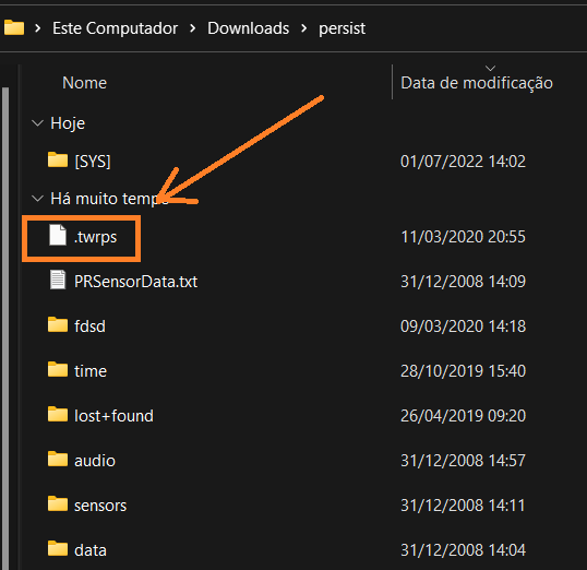

Alright so let me break this down for you.
Installing TWRP on the mi mix 3 5G WOULD break the persist partition, BECAUSE TWRP would create this file inside of the persist.img, im attaching a screenshot of my old persist backup right after flashing the custom recovery so you can check by yourself.
Removing the twrps file and flashing the .img once again solved the issue i was having with my phone (a message popping up saying my storage was corrupted and i couldn't use mi find my phone).
Why this happened, how, and why it was like this? I dont know, im not a developer, all i can tell you is that this was a s**t show, everyone in the mix 5g group was having trouble with the persist after using twrp.
I dont know how everyone did "something wrong" in this simple process, but that's how it went.
That's the reason i came here to ask if using xiaomi.eu has negative effects like this, i was away from xiaomi for years and unfortunately i had to come back with this Mi 11. But somethings never changes, people like you that instead of helping with useful insights are full of self entitled jokes thinking everyone is a moron.

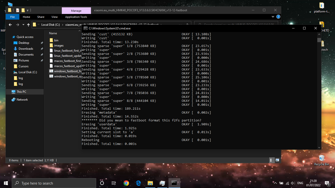

that's what mine looks like but with MacOS and the terminal. takes about 5 min total.
worked with 13.0.2 through 13.0.4 on my Mi 10 Lite Zoom
I encountered a random reboot today, Poco F3, latest MIUI 13.0.6. Any way to find the culprit?
Installing should take 200-300 seconds...that's what it should look likeView attachment 42906
