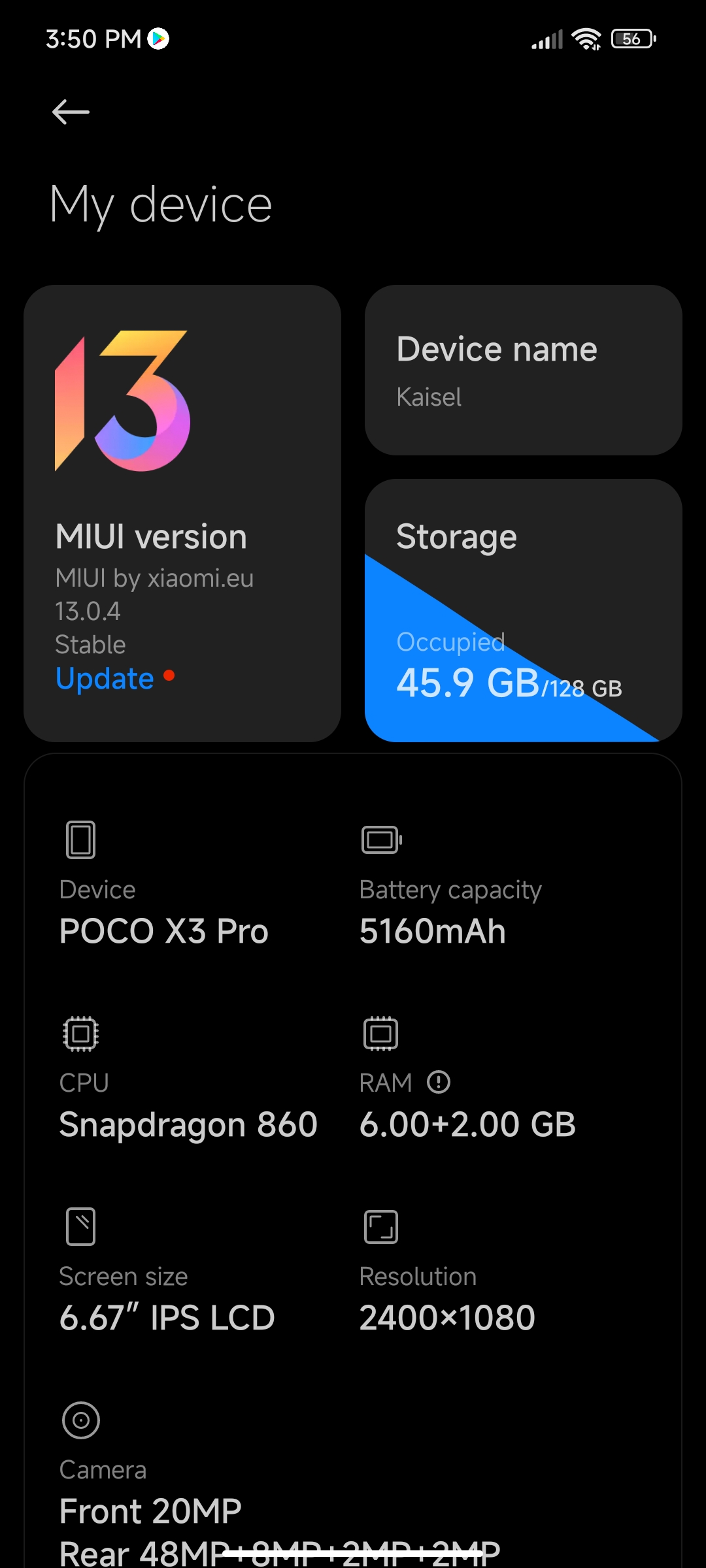

Damn, I just installed MI EU 13.0.4 Via Fastboot and i just received a notification that 13.0.5 is available and its only recovery rom and i dont have custom recovery i only have the stock recovery 5.0
Is there any other way to install the update without installing custom recovery?

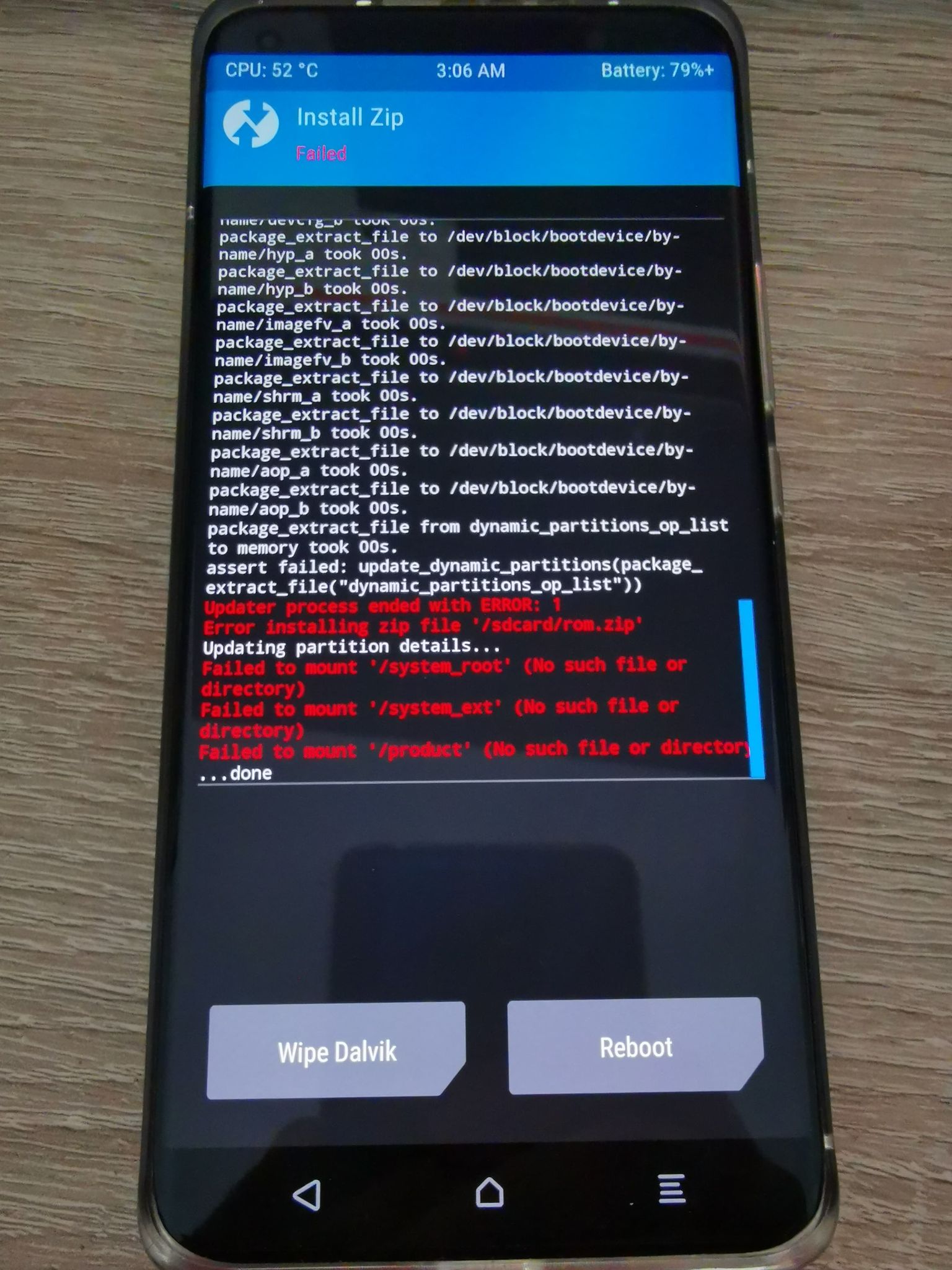

That version of TWRP worked for me but the tutorial on how to install TWRP should be ignored. It was designed to install TWRP before there was a working version of TWRP on Android 12. All people need to do is boot into TWRP (bootloader boot TWRP.img) and install the recovery ROM zip. For the MI 11 phones the ROM itself will replace the stock recovery with TWRP automatically and install it on the phone. The version of TWRP you recommended decrypts the memory fine. It also eliminated the can't mount system partition errors that I was encountering. After hours of unsuccessfully trying to install the recovery ROM on my MI 11 that build of TWRP installed it on the first try exactly the way it's supposed to install so I'm guessing most of the problems people are encountering is being caused by TWRP. Thanks again.
