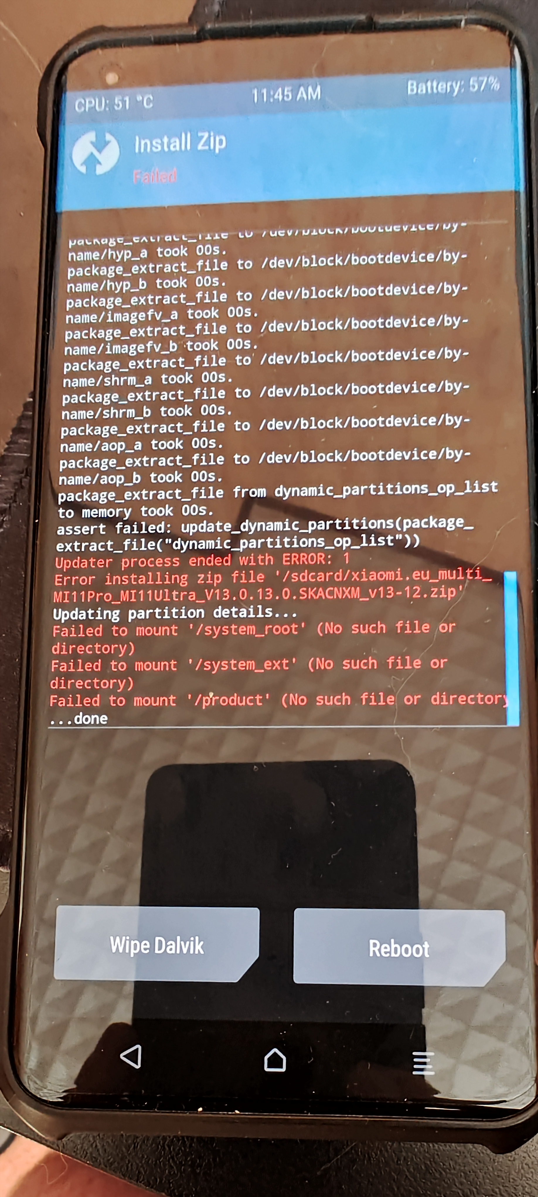

i installed the new stable recovery over my last fastboot rom version on my mi11pro without any issues....the one and only (maybe dumb) question is, is now twrp installed on my mi11pro or did the device only booting in twrp to install the new recovery?:rolleyes: because i cant find any twrp folders on my device...

Get ur twrp.img
Drag to your internal storage
Boot again into the Recovery via fastboot
Go to Install and Switch to Image
Choose the twrp.img and mark in the next step the Option "Install recovery ramdisk"
Install reboot done
Reactions: culi1972

How to start TWRP manually
# fastboot boot-recovery
# fastboot boot recovery
# adb reboot recovery
restart device
# hold "power on" and "volume +"
