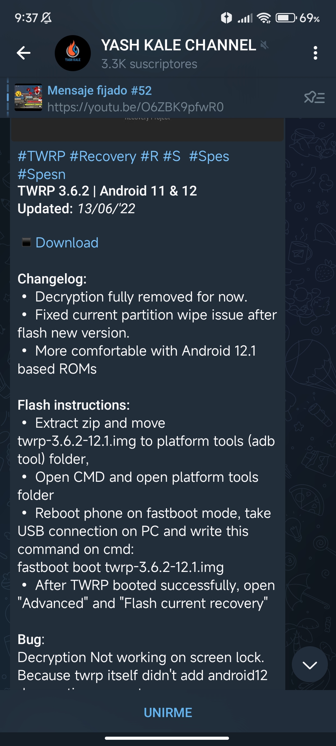

My error is this:
After flashing Xiaomi eu 13.0.2 via twrp, I reboot my phone to system and there is a red Xiaomi logo. Which it means there Is no system on my device. I'm so sure about it because when I go to recovery (twrp) there is no files. Also, I can't transfer files with a PC.
That's my "same error" that I talked about in the lasts posts.
I booted into this recovery: twrp-3.6.2-12.1.img
then "flash current recovery". I went to install option. I selected xiaomi.eu_multi_HMNote11_V13.0.2.0.SGKMIXM_v13-12.zip
Then wipe Dalvik
Then reboot to system
Then red Xiaomi logo
Then it immediately boot to recovery.
(Screenshot)
My error is this:
Moreover, I boot and flash this recovery: twrp-3.6.2-12.1.img
(Screenshot)
please contact the telegramm channel where you have downloaded the artifactories… thank you
on the other side look at this howto and tell us in detail where is your challenge
Reactions: emeftee
