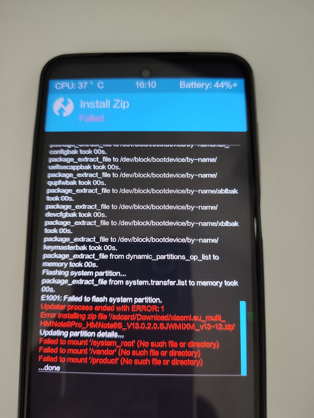

I am stuck with this. Can someone help? Tried to install directly MIUI 13 from TWRP
Phone is Redmi Note 9S Global

just reboot to TWRP again and try again until it is OK.. it is TWRP issue on A12..

Ingbrzy Sir, you are love <3 I will keep trying.

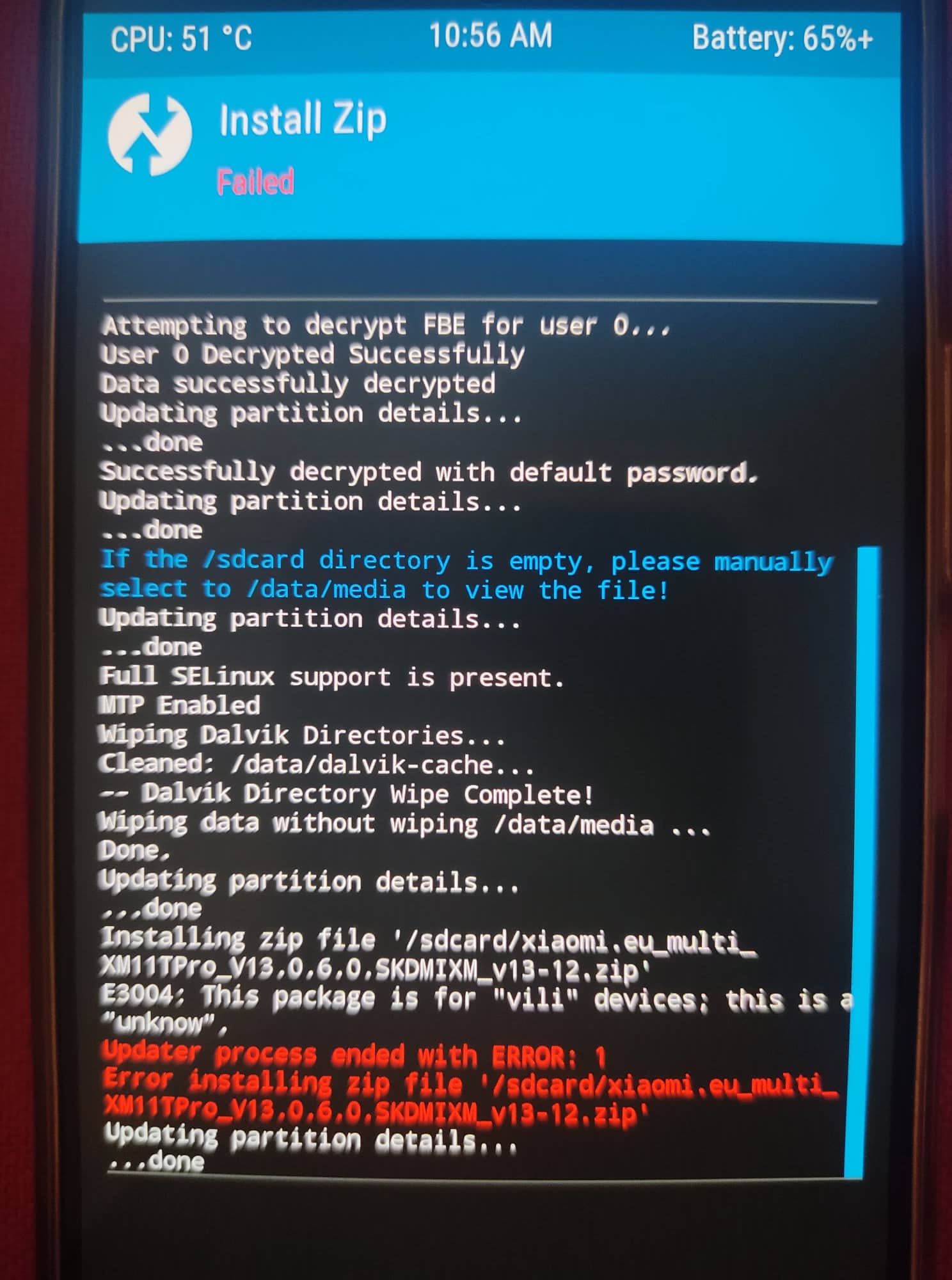

hi ingbrzy,
I have a Mi 11T Pro, and the TWRP has no official img for vili.
Because of that, I keep getting an error everytime I try to install v13.0.6.0
Hopefully, I installed v13.0.4.0 via fastboot, but still I cannot update do v13.0.6.0 because TWRP is not working properly for vili.
Can you please make a fastboot file for v13.0.6.0 ?

tried 10 times. Not working :|
HOW is it not working? How do you want to be helped if you provide absolutely no information at all about your issue?
Just a guess - did you really format /data? When you have to type "yes"?
If yes, I guess you should revert to the TWRP which has been working fine before (for MIUI12).

Nobody said it has to be official TWRP.
There are two sources for working TWRP in the guide which has been shared and explained on almost every single page in this thread.
Also in almost every single page in this thread it's been said - no more fastboot versions if a recovery version is available because recovery ROM means working OTA updates. There is no way anyone is making individual personalized ROMs here.

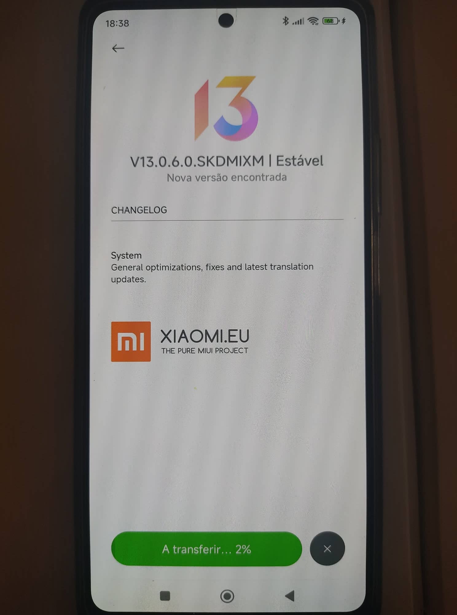

As you can see on the attachment, the OTA is downloadable, and then... if official TWRP doesn't exist to vili, guess what? doesn't update!
When you click "check and install", it reboots to TWRP, and gets the same error... The error: 1 E3004.
Any real helpfull answer?
Why are you hellbent on TWRP being official?
These issues have been answered and solved. Please do (re)search.

Show me 1 post where someone, successfully installed v13.0.6.0 on a Mi 11T Pro (vili) and I rest my case.
You are absolutely right. There is no way any user with the Global vili model managed to flash the ROM with skkk's TWRP, due to a typo...
Notice the
Code:
sku == "vivlgl"
instead of
Code:
sku == "viligl"
I made a pull request for this issue: https://github.com/sekaiacg/android_device_xiaomi_vili_TWRP/pull/1/files

I managed to flash the ROM fine on my 11T Pro.
But seeing the problem above, i didnt know that the other models have another sku name.
