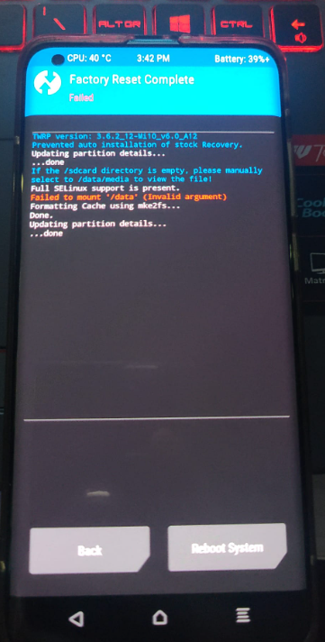

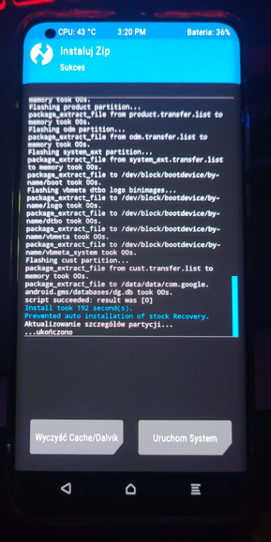

xiaomi.eu_multi_MI10_V13.0.7.0.SJBCNXM_v13-12.zip
on Mi10 using
[REC_BOOT]3.6.2_12-Mi10_v6.0_A12-umi-skkk_ee869b41.zip
After ROM instalation it just goes back to TWRP
What can i do at this point?

It is impossible to install
on Mi10 using
Try using the recovery provided here , first post. I'm fine with it. ( twrp-3.6.2_12-v6.0_A12-umi-skkk.img )
