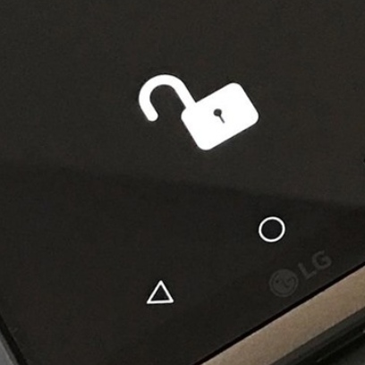

Just start your phone in fastboot mode and connect it to the PC and check the bootloader status in Mi unlocktool.
For my M11 Venus the bootloader status is in the top and not bottom, if I restart my phone. Its Just a open lock or closed of the bootloader is locked.
Example as attachement.
yes, i just noticed, there is an OPEN lock symbol on top of my screen when I (re)boot my device. so still can't understand why i can't get a number when typing "fastboot devices" in command line under ADB... ?

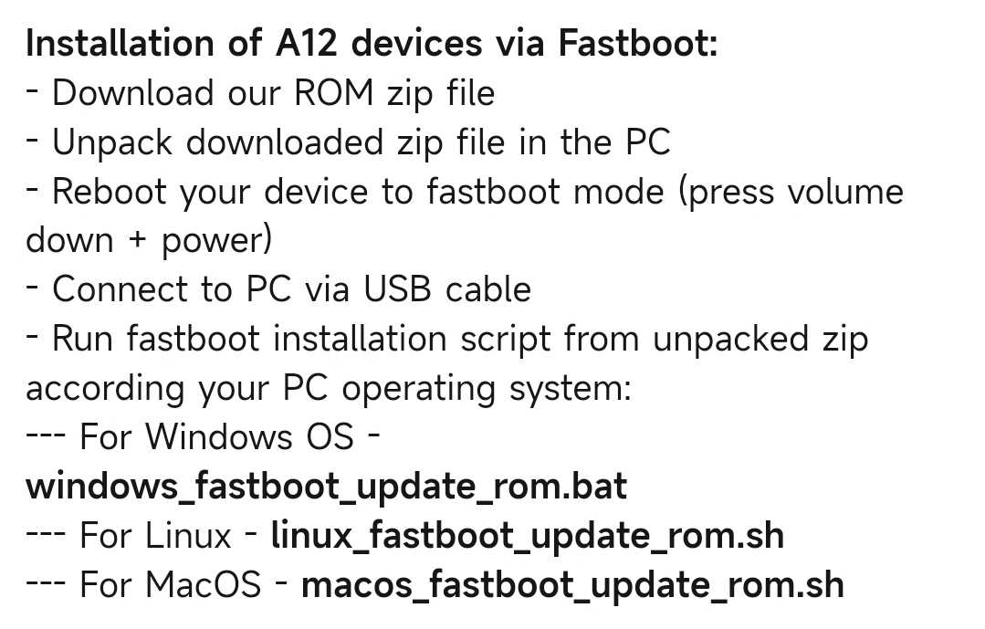

well, basically that's the instructions I follow as per instructions in the beginning of the topic under MIUI 13 STABLE ROMS, except that on your pic is missing the instruction as follows (as at the end it says "do this only if "fastboot devices" shows a number" I did not try to flash the new ROM):
- type in "cmd window": "fastboot devices"
- check if you see a number -> then all is fine
- if you dont see a number:
change USB port / change USB cable / use USB 2.0 / use an USB Hub / check driver installation
- "cmd window" should be open on PC
- change to c:\test eg "cd c:\test"
- start the appropriate bat-file (dont click in explorer)
-> start the file from command-line
Reactions: davital

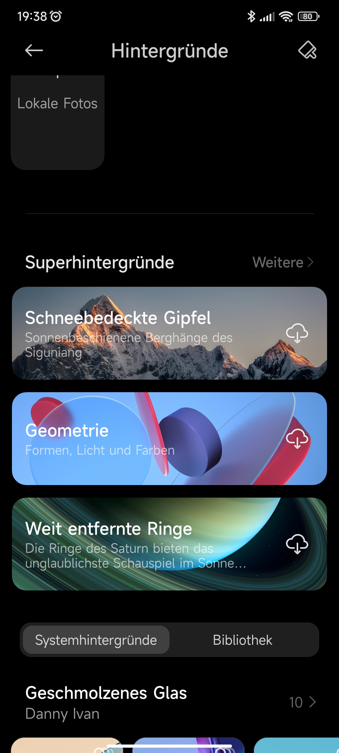

Can somebody check if on stable 13 Super backgrounds are working (Poco F3)? I cannot set them up or download them. Thanks!
I checked the known bugs and its mentioned that super wallpapers have some issues about day and night time, but not a general issue of picking them.
