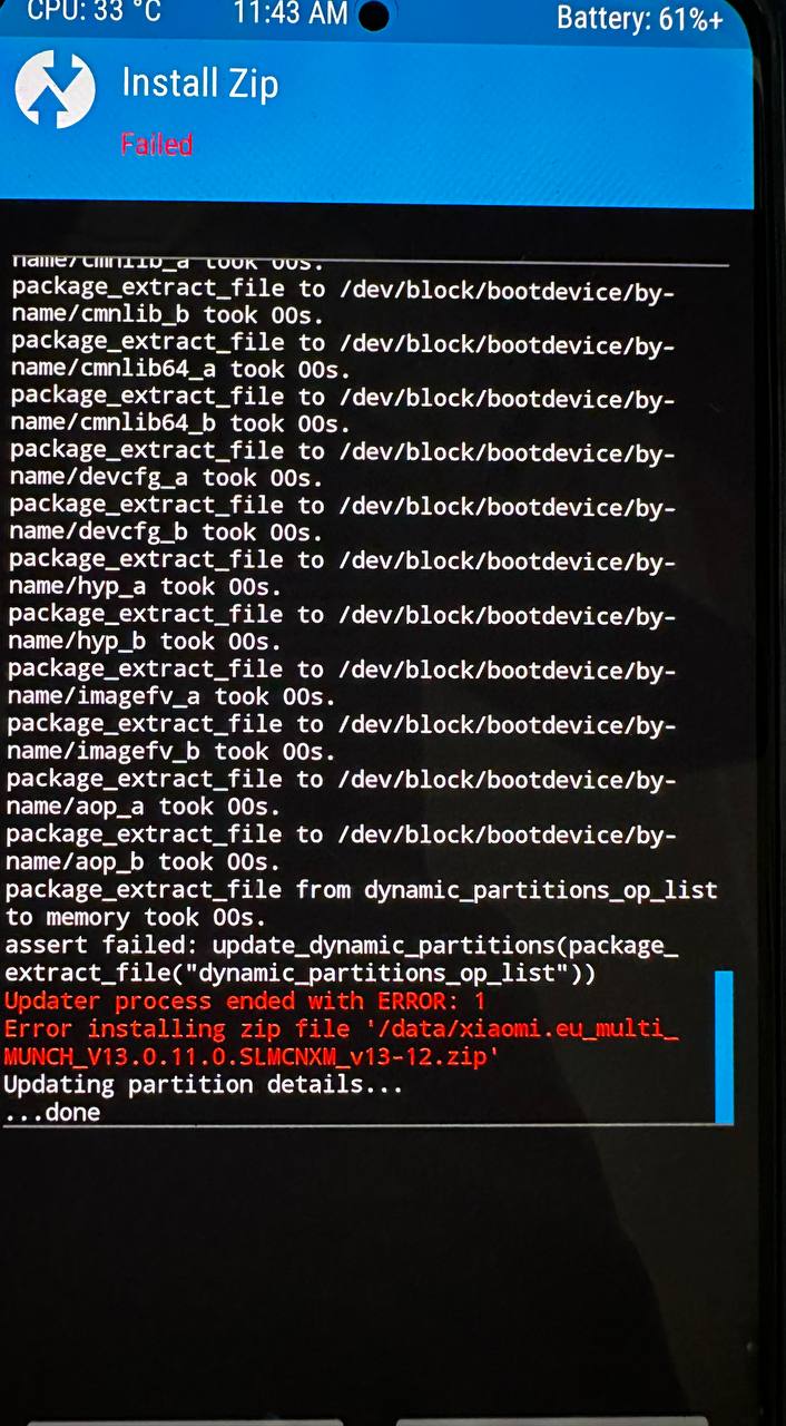

look does not work
after 13 attempts it moved on installing EU ROME BUT NOW it keeps restarting only in TWRP mode (running a chinese UI!)

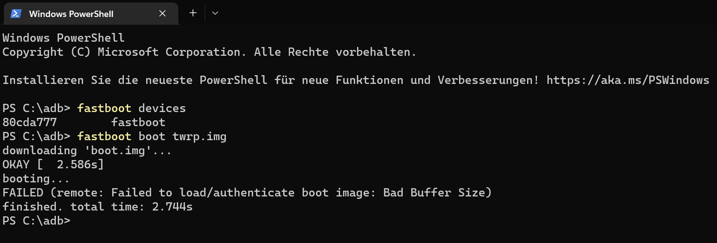

look does not work
I thing you are using the false TWRP for boot TWRP
BOOT / REC TWRP for some devices
For some devices there are different TWRPs available
1.) BOOT-TWRP -> fastboot boot twrp - boot TWRP only
2.) REC-TWRP -> fastboot flash recovery_ab twrp.img - install TWRP permanent
3.) BOOT-REC-TWRP -> you can use both fastboot commands -> see 1.) & 2.)

I am always getting this error, maybe its too early for recovery :p :
fastboot boot TWRP.img"
downloading 'boot.img'...
OKAY [ 1.609s]
booting...
FAILED (remote: Failed to load/authenticate boot image: Load Error)
finished. total time: 1.675s

@FlexWheeler The Android 12 ROM you tried to flash was a recovery ROM, and the new Android 13 ROM is a fastboot ROM and does not include TWRP so has to be flashed from PC using the update script. By the screenshot you sent, looks like fastboot flashing went fine. We'll move back to recovery ROMs when Android 13 supporting TWRPs become more common.
OKAY [ 1.609s]
booting...
On cupid, you're supposed to flash it to recovery partition, not boot it.
