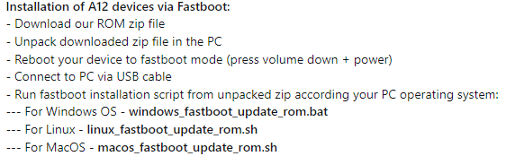

I have Poco F3. Im using 13.0.2.0 Stable.
If I want to upgrade to 13.0.3.0, do I have to make it again with fastboot? I dont want to wipe evetything again... The Updater App doesnt work for me. Is there any other way to do? Is there maybe TWRP for Poco F3 for Android 12?

yes fastboot, download to computer and click on it. u wont loose photos r files. go ahead, take backup for emergency. tnx.

Read first post or look here:
A12 devices no update via TWRP or updater app.
Thank you for your answer! My problem is not about the fotos, music... But I dont want to install each time all my apps, i dont want root again each time when I update... I think its better, I wait until have TWRP, and flashable zip...
Wording is indeed ambiguous but there are only fastboot ROMs available so you need to use fastboot.
Thank you! Wasn't clear. And am i guessing correct, after flash via fastboot i'm loosing my twrp? SO i flash the image,then before i restart the device,i need to reflash twrp too?
If you update, you won't lose any apps, it will say like it was before with just a newer version, like a regular update....
To be true it is even easier than TWRP, as by me.
