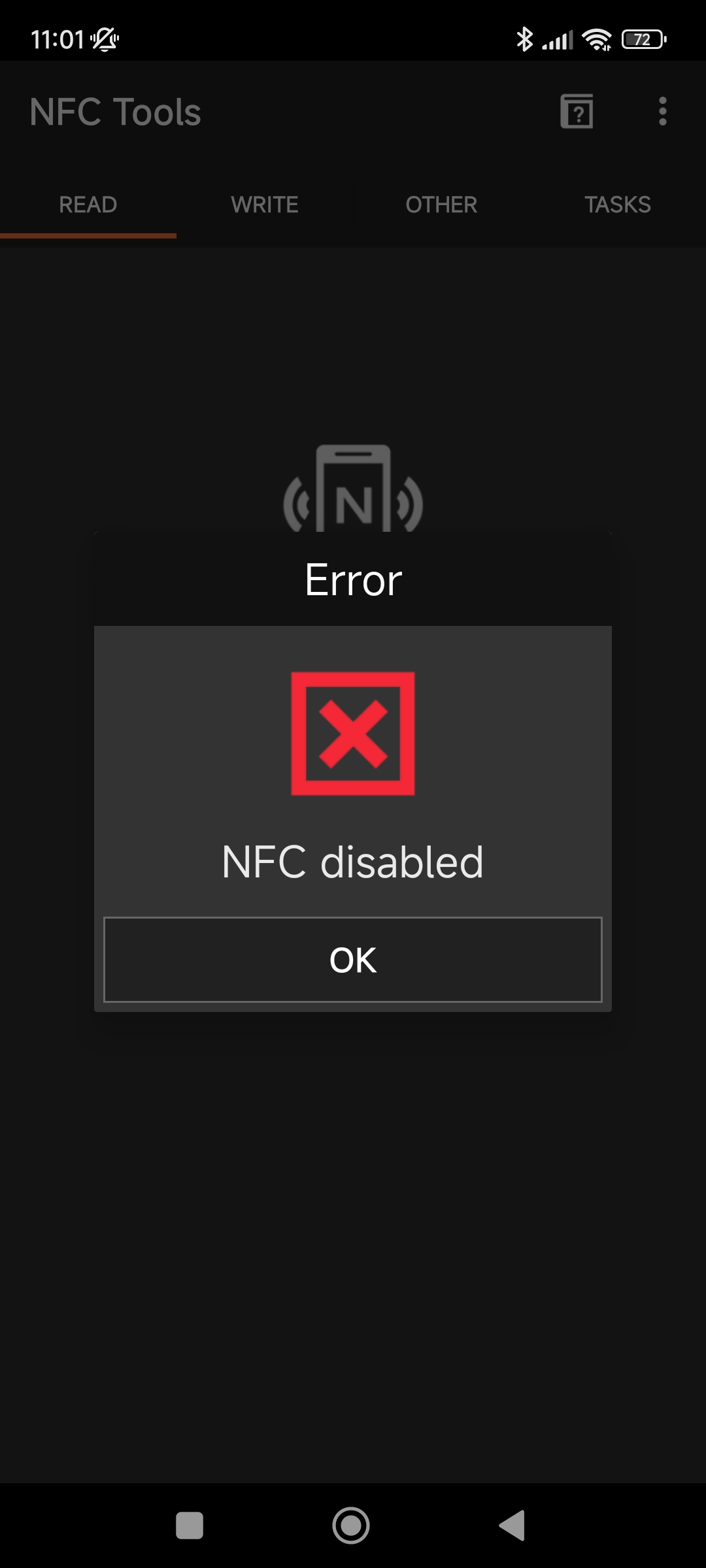

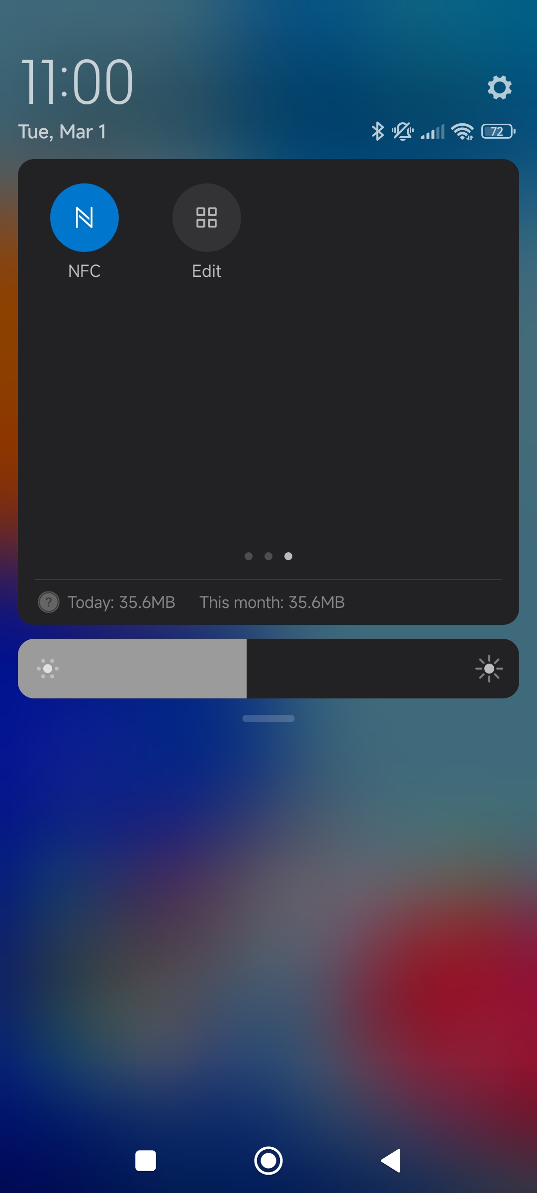

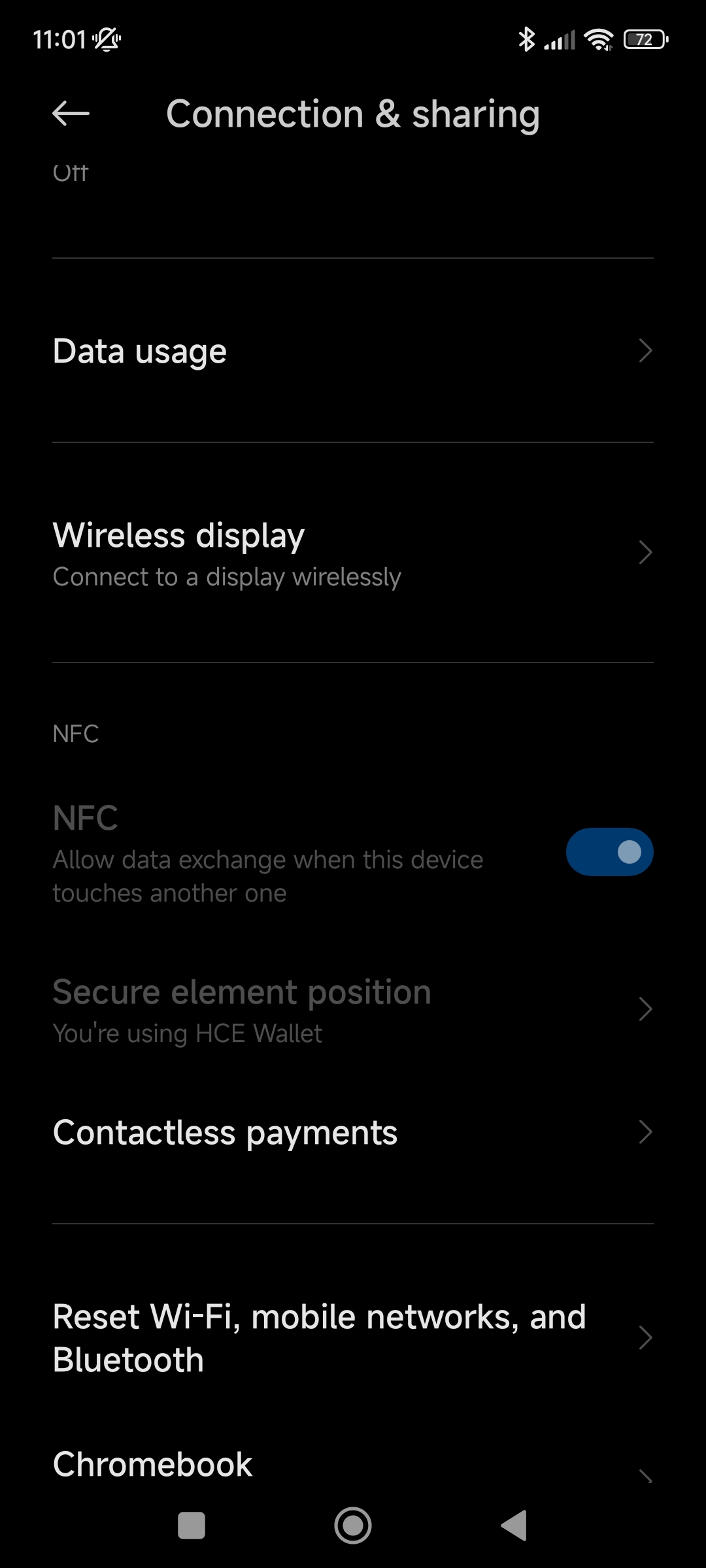

I have installed stable MIUI 13 (xiaomi.eu_multi_HMNote11_V13.0.5.0.RGCMIXM_v13-11-fastboot) on my Xiaomi Redmi Note 11 for the first time via fastboot using batch file "windows_fastboot_first_install_with_data_format". When I try to use NFC, it doesn't work. In the control Center the NFC icon is activated, but when I chek the NFC with the app NFC Tools, just says to enable the NFC sensor. I have also check the NFC status in Settings, and it is deactivated.

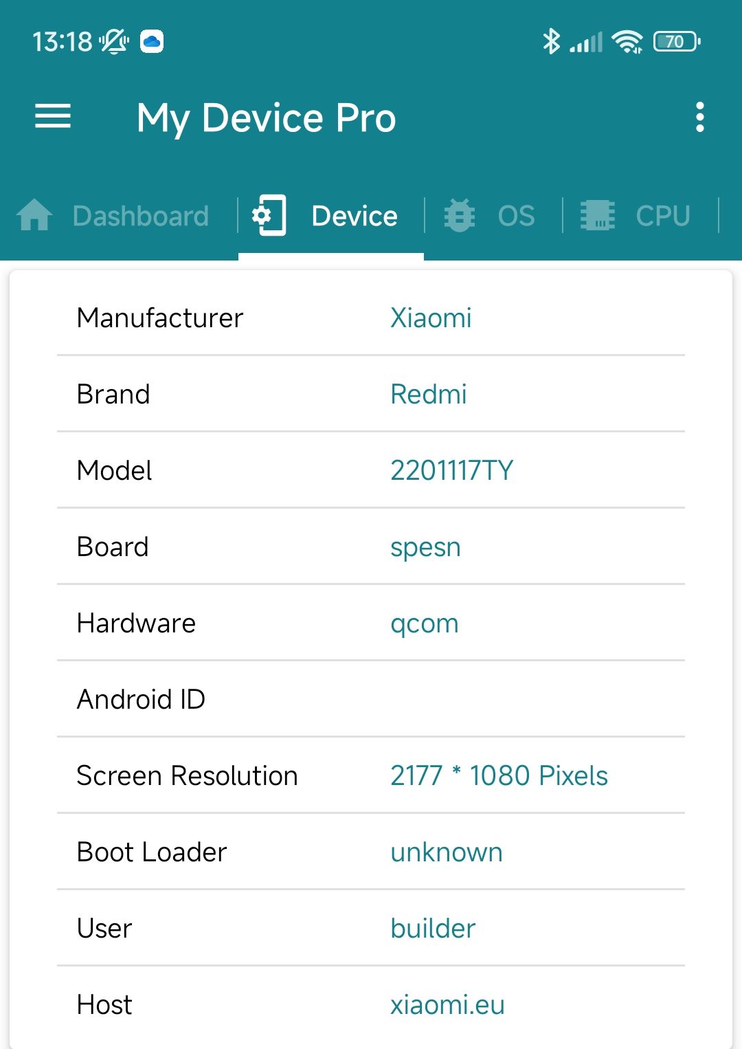

Did NFC work with original firmware? AFAIK there's two different models, "spes" which doesn't have NFC and "spesn" which do have.
Yes, it worked. My device is spesn
