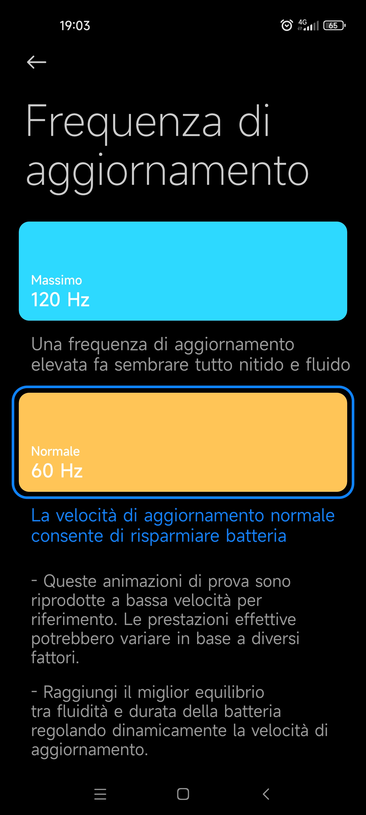

When Miui EU will support 120fps Mobile legend? Miui global already support...
I think the support needs to come from Mobile Legends developers (and I don't expect them to specifically support a custom ROM)

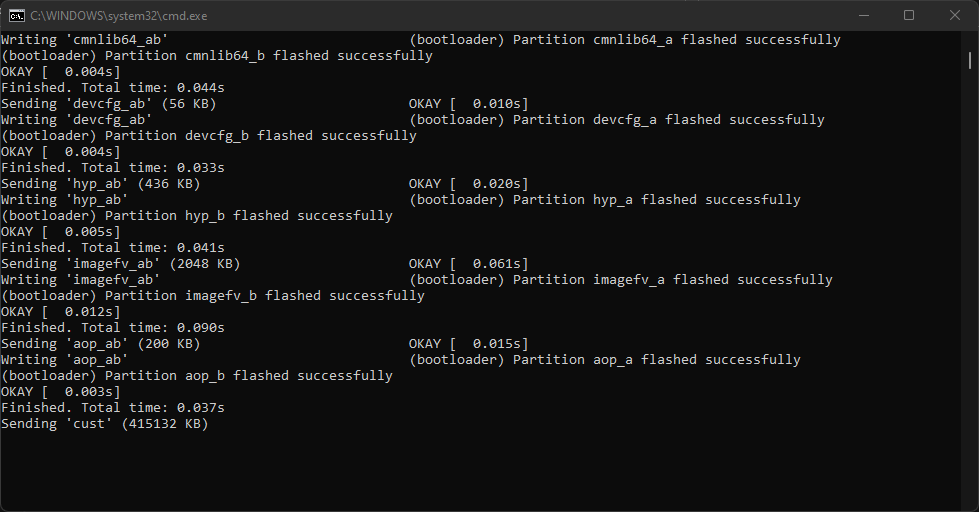

Hey, i have a problem with the update to MIUI13. I tried to install it with fastbood and now it's stucked at "Sending sparse 'super' 1/9 (721168 KB) for over 1 hour.
Any solution for that? Is it save to unplug and to try another usb slot?
//edit: just started the update new, it works now

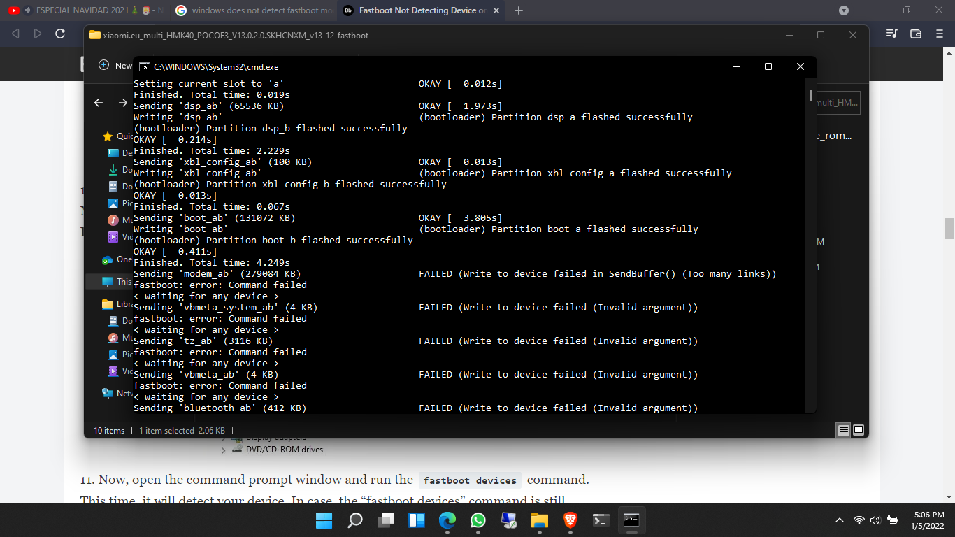

Hi guys i was trying to update via fastboot but when i open the batch file and is sees like nothing happen then unplug and plug again the phone and mark some error i do not why, then with fear a tried yo boot normal because te errors and the phone is not responding could bea way to recover the phone
