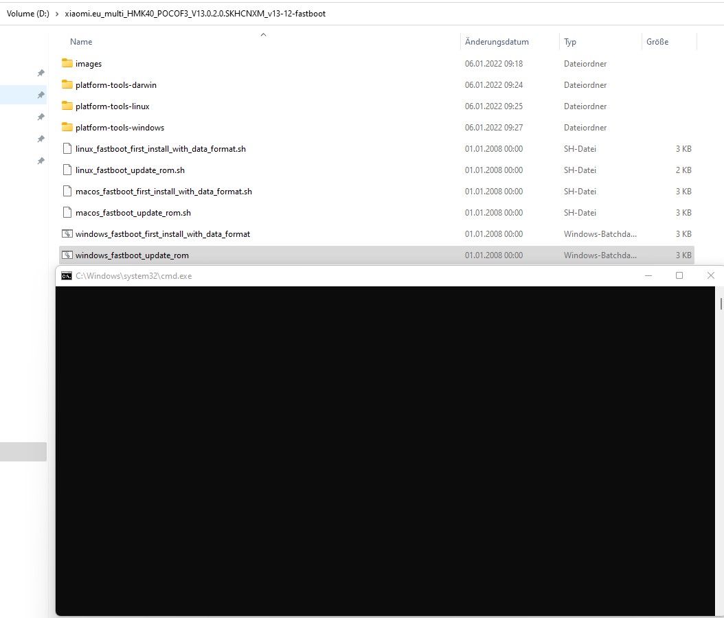

@mar_robHD (because you asked about Win11)
Downloaded the ROM for Poco F3 and followed the steps. ROM is extracted on my Win11 desktop. I used the correct bat file. Poco F3 on 12.5.19 stable.
Installation of A12 devices via Fastboot:
- Download our ROM zip file => DONE
- Unpack downloaded zip file in the PC => DONE
- Reboot your device to fastboot mode (press volume down + power) => DONE
- Connect to PC via USB cable => DONE
- Run fastboot installation script from unpacked zip according your PC operating system:
--- For Windows OS - windows_fastboot_update_rom.bat => DONE
Command window opens, but simply remains black with no actions taken place (cursor is blinking though). My Win11 is relativly fresh installed, do I need to install some kind of drivers for the phone? When I connect the phone in fastboot mode to the cable, I get that sound of a USB devices being connected.

black window… maybe driver issue look here I have described it in detail…

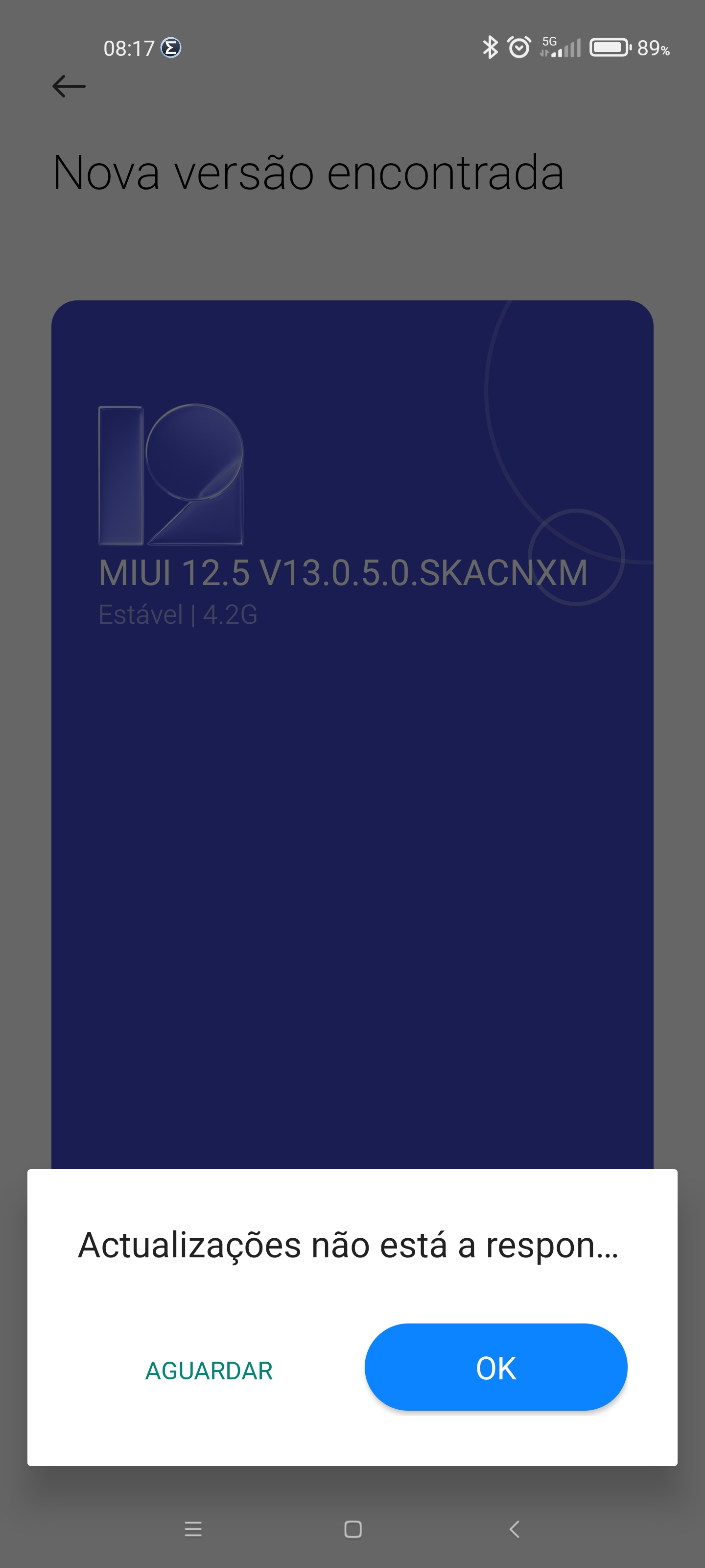

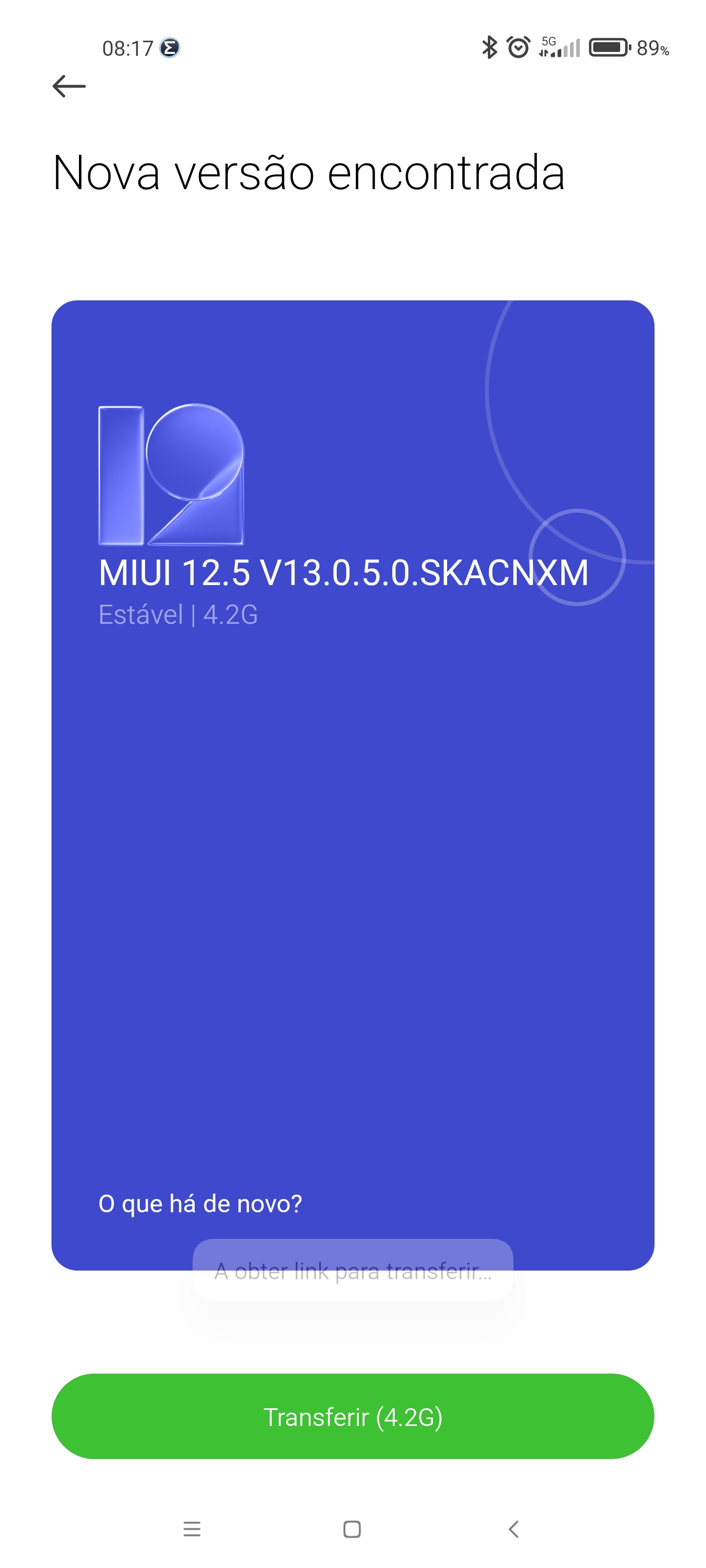

Hello. Sorry but i need help and Im rookie in this Kind of stuff.
I bought the mi 11 pro, with xiaomi.eu ROM via trwp.
Yesterday the system said that i have a new version to update, but when i try to download, it takes to long, and return the error :the update not respondi g (error in português attached).
With trwp the seller said that the update is automatic.
Can Anyone help me?
Thanks.
José Miguel Costa.

download it to PC from here… see first page of this topic
its only fastboot availabe no twrp recovery image at the moment
then read my post how to install…

Please go to the device-manager (Geräte-Manager) and check if there's a usb device with no driver. Typically windows should automatically install the correct driver.
Could you please share the script.
