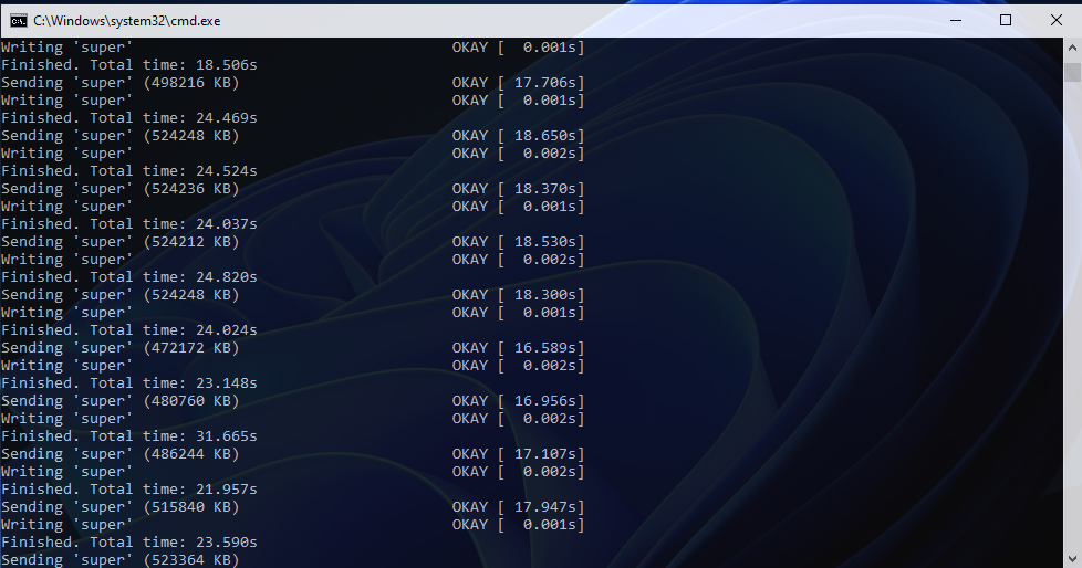

Hello! I decided to upgrade from the stable POCO F3 version 14.0.6.0 to the stable POCO F3 14.0.7.0 using a fastboot with windows_fastboot_update_rom.bat, I had not encountered such a problem before. At the step: "Sending "super" 523364" I have been waiting for about 40 minutes and I'm still waiting. Very scary. What can you advise?

Sounds like the USB connection is hanging. The vital partitions are already flashed at this point, so bricking shouldn't be possible.
The only thing you can do is swap to a trusted cable and USB 2.0 port and retry the flashing process. You'll need to hold Power+Volume Down buttons to re-enter fastboot mode. There's nothing else you can do here.

Thanks a lot! Now I will try
Update: Everything went well, god I was scared

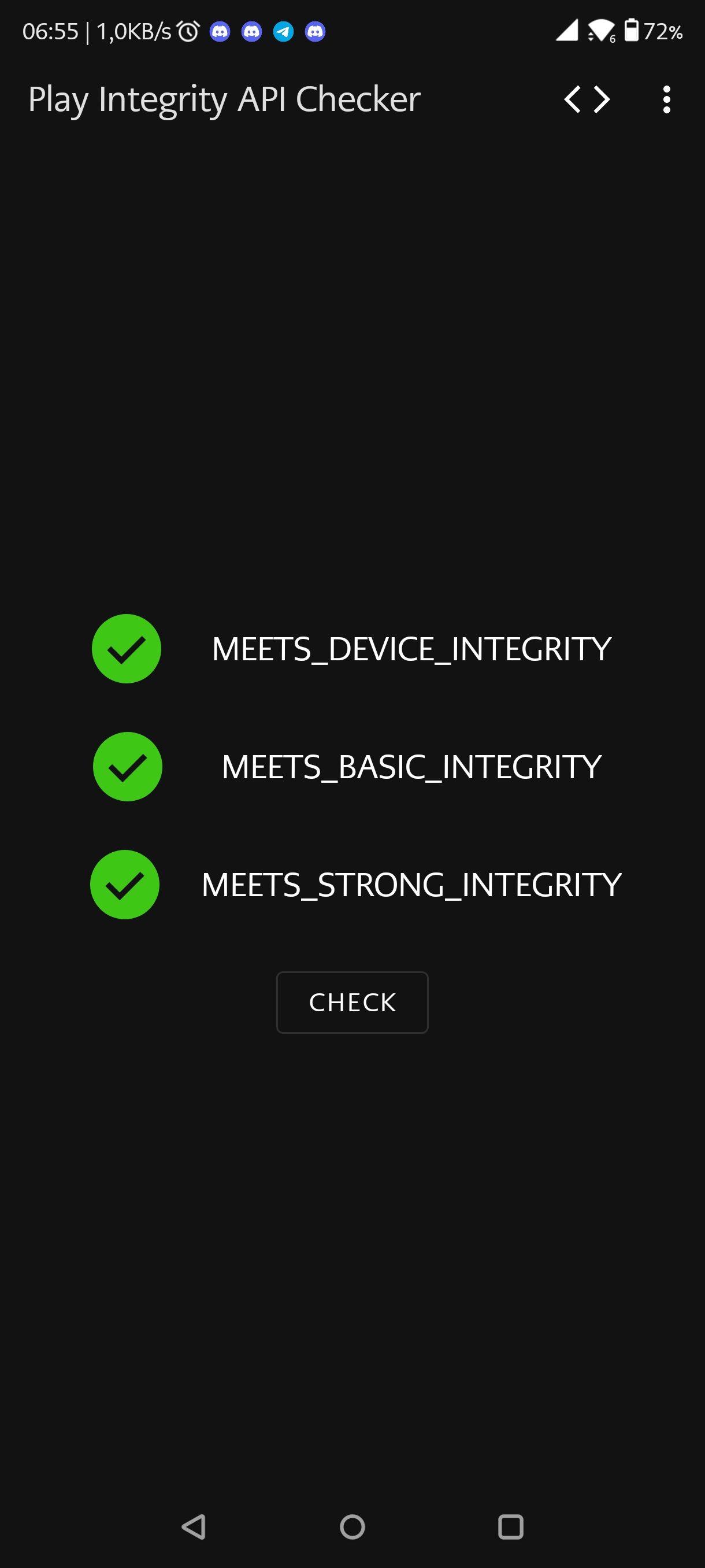

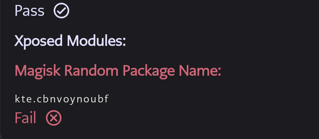

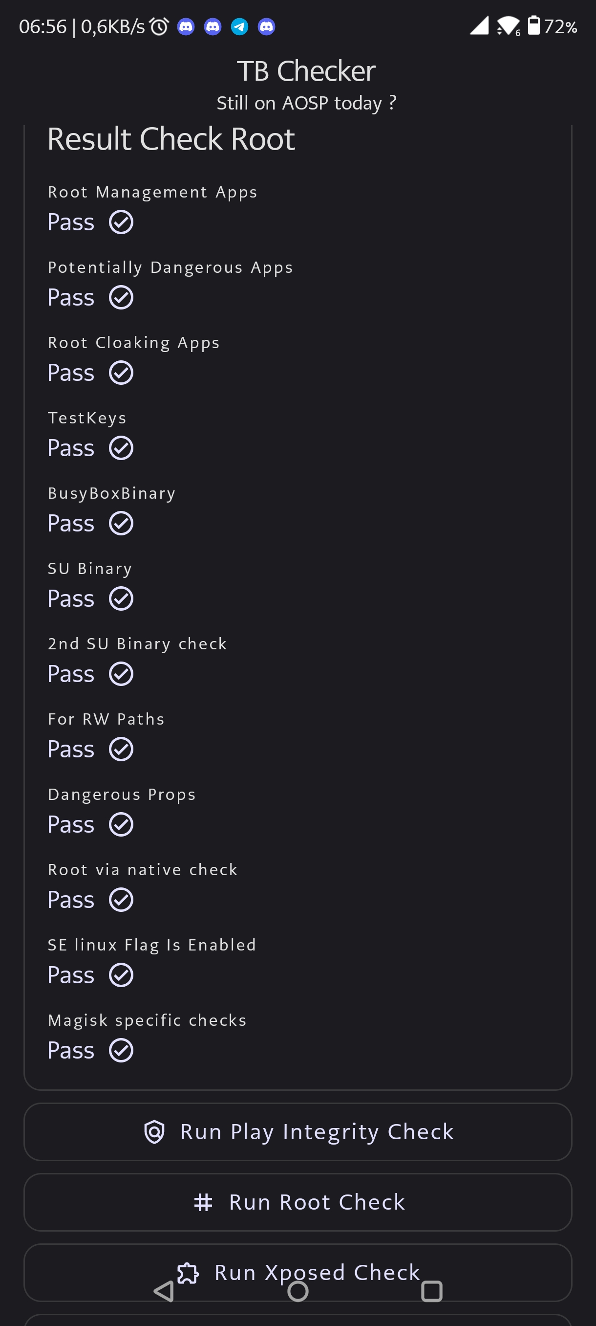

I rooted the phone and used the module to fix integrity check. My banking app still isnt working and only thing i am not passing is Magisk package name.
To hide apps (like your LSPosed module) you need to use another LSPosed module HMA and configure it
However, no guarantee that your banking app finds that or something else. Eg, you had to install Shamiko module put your banking app to DenyList and not Enforce DenyList (seems you did for TB Checker)
Car and mouse game. Apps can also find that BL is unlocked by not going through Strong Integrity. Ie, you pass Strong Integrity now but KeyAttestation app will still see that your BL is unlocked. There is another LSPosed module to hide it, BootloaderSpoofer
You hide all that and maybe next update of the banking app will find something else
Etc. The only 100% 'method' is to keep Bootloader locked and to stay on stock ROM ;-(
you can download an app,,, applist detector to check if the libs or modules are visible. If you are familiar with programming you can use XPrivacyLua. Search this forum for Digitales Amt there is an example.
Best way as zgfg12 mentioned stock rom and BL locked
PS: magisk topics etc should not be discussed in this topic :)

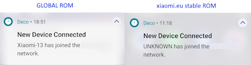

During testing, noticed that phone network device (WiFi) ID is reported differently on Global and xiaomi.eu ROMs.
In my case, on Global it says "Xiaomi-13", while on xiaomi.eu ROM says "UNKNOWN".
Any ideas why?
