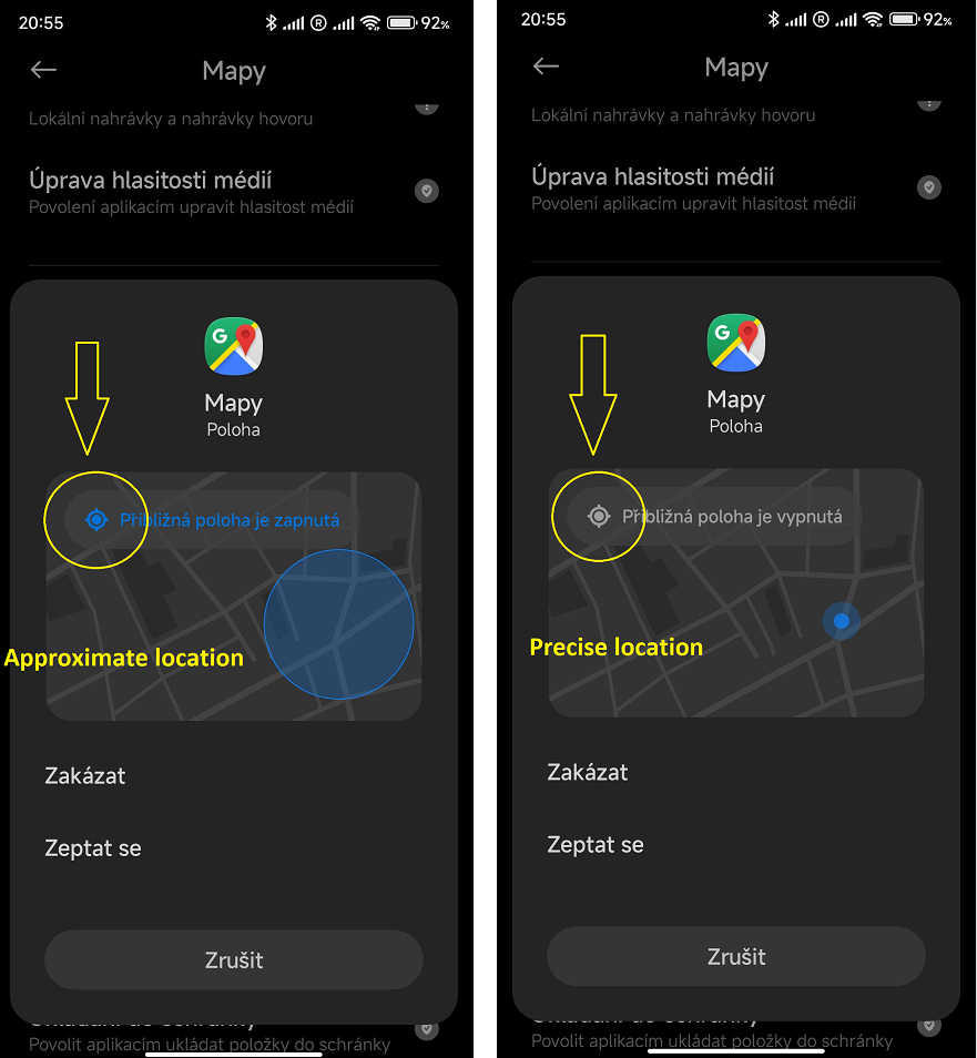

Can I enable "Precise location" as the default location settings for every app? It concerns me that even the maps and navigation apps that I use will default to "Approximate location" after giving the app location permissions.
Or is there any way I can easily change between precise and approximate in app settings? Because I don't see a way to change between the two in the App settings or permissions.
You can set it for each app separately.
app info - permissions - get location info
As the default? No.
Don't know how it's on Stable these days, but on Weekly you can select the location precision immediately when the app requests the permission.

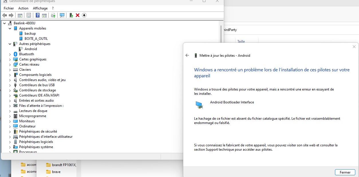

I changed my PC and I'm under windows 11. The USB drivers that worked very well under windows 10, do not work anymore? I had installed Miui 12, then 13 on my Mi 11 lite 5G (Renoir) without any problem under Windows 10. Now, with windows 11 it doesn't work anymore.
Where can I find functional USB drivers?
Download the latest Mi Unlock tool from Xiaomi themself, there is a usb driver folder in there, then use the manual installation method through device manager to install that driver. For some reason, double click the driver itself or when using Mi unlock (there is a install USB driver button in their interface) both don't work. I'm using Windows 11 btw + Ryzen CPU, If that's relevant.
Also before doing the driver installation, you need to plug your device so that It can show the device but with yellow triangle.
I used Mi flash (20181115)to manually install the latest drivers) but I have an error. I will try Mi Unlock
I was able to install the USB drivers with Mi unlock. In the meantime, I installed Miui 14 without any problem.
