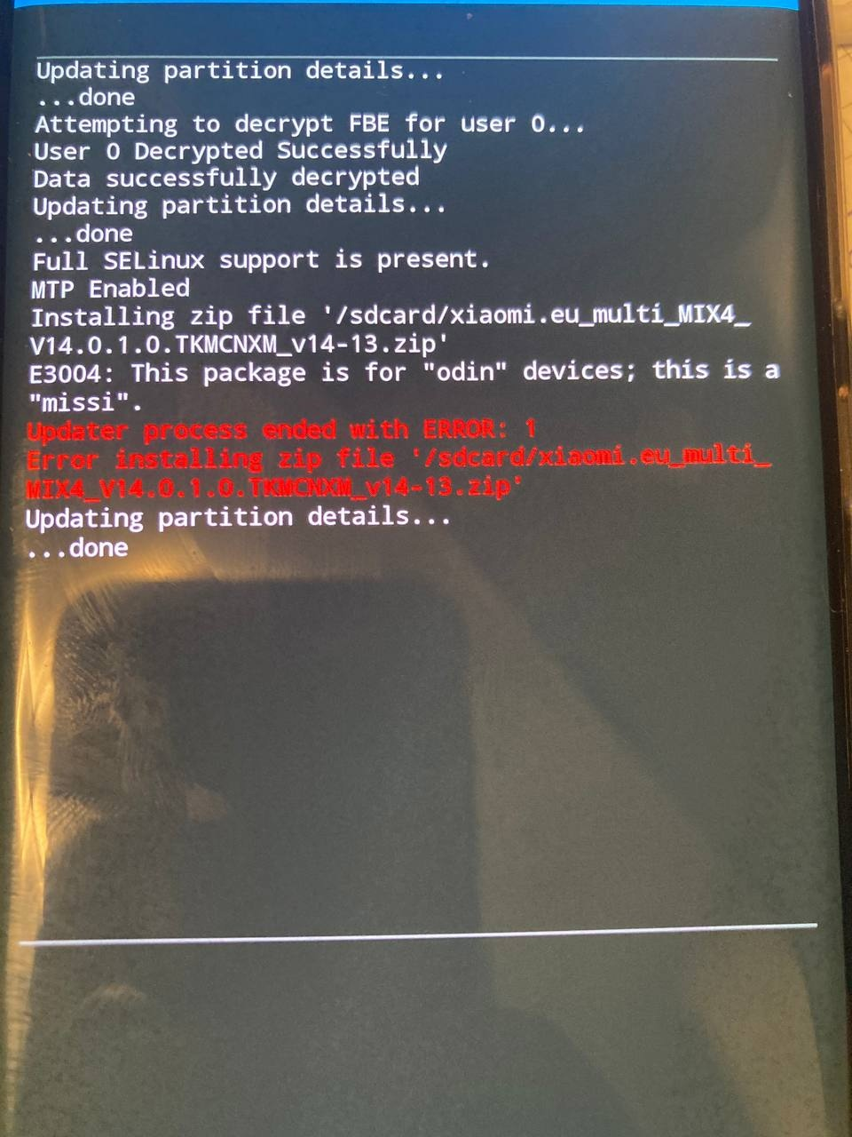

Hello everyone, I'm trying to install update for MIX4 and having troubles. Now I have 13.0.4 stable by xiaomi.eu. I've already installed TWRP (twrp-3.7.0_12-2-odin-inkypen.img) and now trying to install MIUI. In the very beginning of installation it says "E3004 this package is for device: odin; this device is missi". I'm sure that I downloaded the correct one for my model and that my model is odin.
How can I fix it? Is there any way to update without losing data, or I have to wipe /data partition? Sorry for my stupid questions, doing it for the first time.

My rom is recovery rom. The error is in TWRP (check image).

Dude, put the device in fastboot mode and type the command "fastboot getvar product" in the command line. Your phone's real codename will come out.

I'd try this TWRP instead: https://sourceforge.net/projects/re...twrp-3.7.0_12-v6.7_A13-odin-skkk.img/download

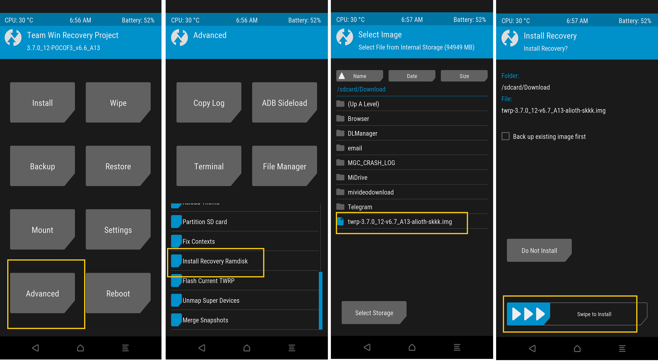

I just need to open my twrp, choose "install recovery ramdisk" and choose this image? Or I need to delete installed one somehow?
I know how to install TWRP, the question is: should I do the same things to install another one, or firstly I need to delete already installed version?
Put the TWRP file on your phone and update in existing TWRP..
After TWRP update, choose to reboot into recovery.
