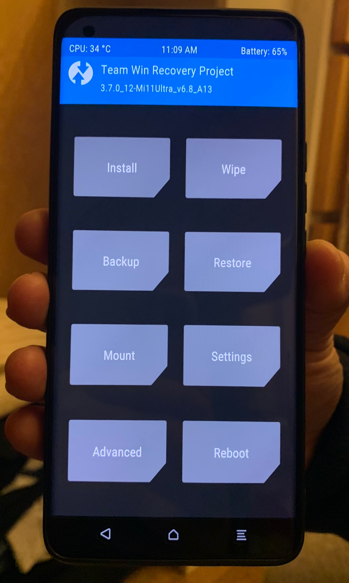

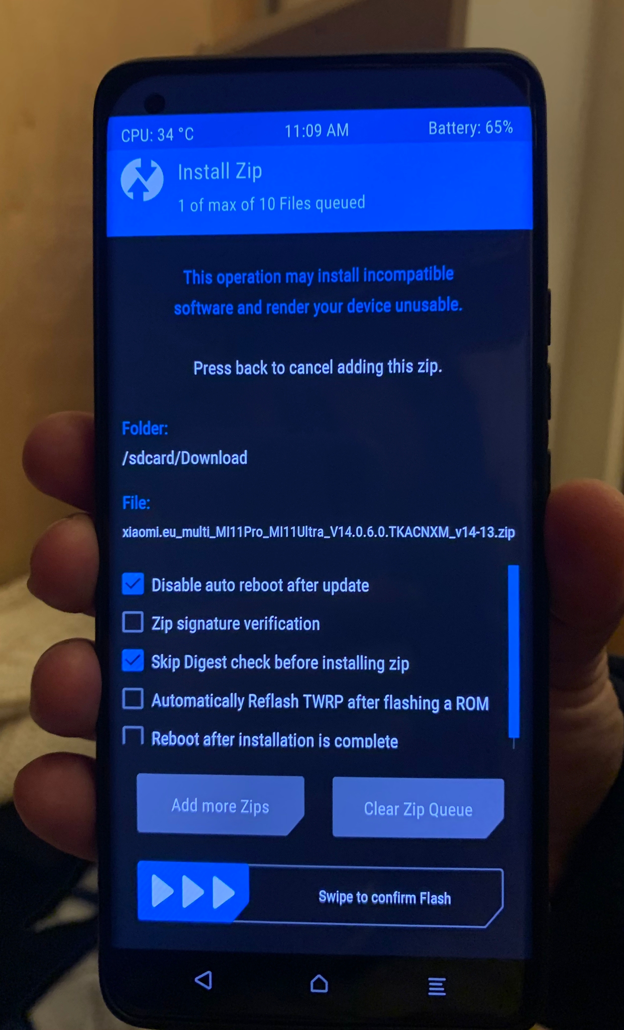

To be sure, phones table says that XM12 is a fastboot rom, but xiaomi.eu_multi_XM12_V14.0.4.0.TLCCNXM_v14-13.zip doesn't contain batch file, so it's now twrp?
Yep, if fastboot is missing at the end then it means that you have to flash it with twrp.
this link:
twrp-3.7.0_12-v6.8_A13-cupid-skkk.img
guide from here:

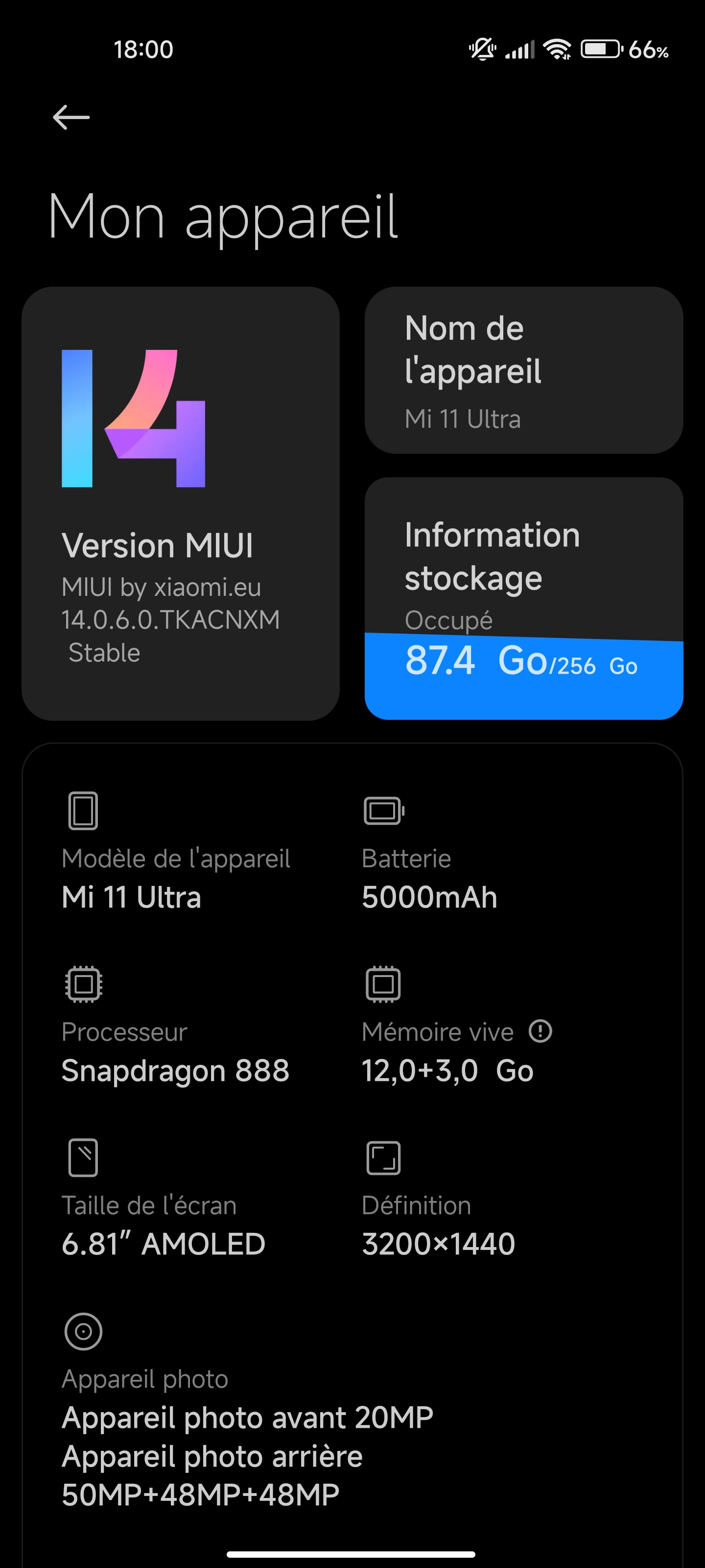

Just update with TWRP and looks good for the moment !! thanks DEVS !!!
